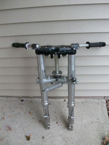

Though not in the photos I have the brake lines, 6 piston calipers and mastercylinder. The clutch lever as well. The steering damper too.

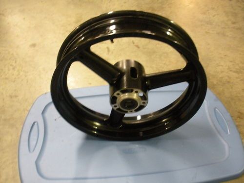

I need to buy wheel bearings and seals. I can not get over how light this wheel is...maybe a pound or two.

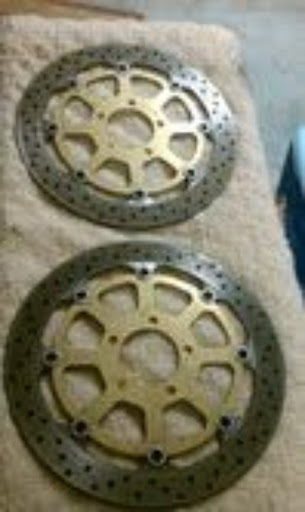

The rotors are complete only missing one bolt.
I'm picking up the front fender when I get a chance to go back to the guy's house. I left it by mistake.The guy threw in a very nice front tire with maybe 40% tread left. It's a directional Dunlop that supposedly doesn need balancing. He said there is a round dot on the tire you line up with the valve stem and the tire will balance without weights...Never heard of anything like that before...I guess I'll find out.

If you ever get those forks on a GW I want to hear about it -- I bet we ALL do! It will be a huge improvement I suspect. Add tapered roller bearings too, that might be the only option anyway. What a great set of forks! I bet the length is just right too--aren't they a bit longer than GW forks?

biggyfries wrote:If you ever get those forks on a GW I want to hear about it -- I bet we ALL do! It will be a huge improvement I suspect. Add tapered roller bearings too, that might be the only option anyway. What a great set of forks! I bet the length is just right too--aren't they a bit longer than GW forks?
I only broke out the tape measure but they might be a 1/2" to 3/ 4" shorter. I believe I can overcome that by
using the S&W shocks I just bought because they are about 1/2" to 3/4" shorter. Hopefully that will keep the geometry the same. These Busa forks are huge. There will be no flex I feel sure.

very interesting selection of forks. are there any other plans for the bike?

CYBORG, Yes I have other plans but I need to get past this fitment problem first. I'd really like to keep my spoked front wheel. Not sure it's possible but I'm going to give it a shot. I'm concerned about attaching the 320mm diameter Busa rotors to the Honda hub.I just today bought some bearings and seals for the Busa wheel from Bearings and Drives here in Gainesville. just in case that I can't make the spoke wheel work. I'm mostly sitting across from the bike pondering what other changes will be necessary. I will have the Busa fender after this weekend. I'm not sure I want to use it...pretty ugly bulbous thing.
