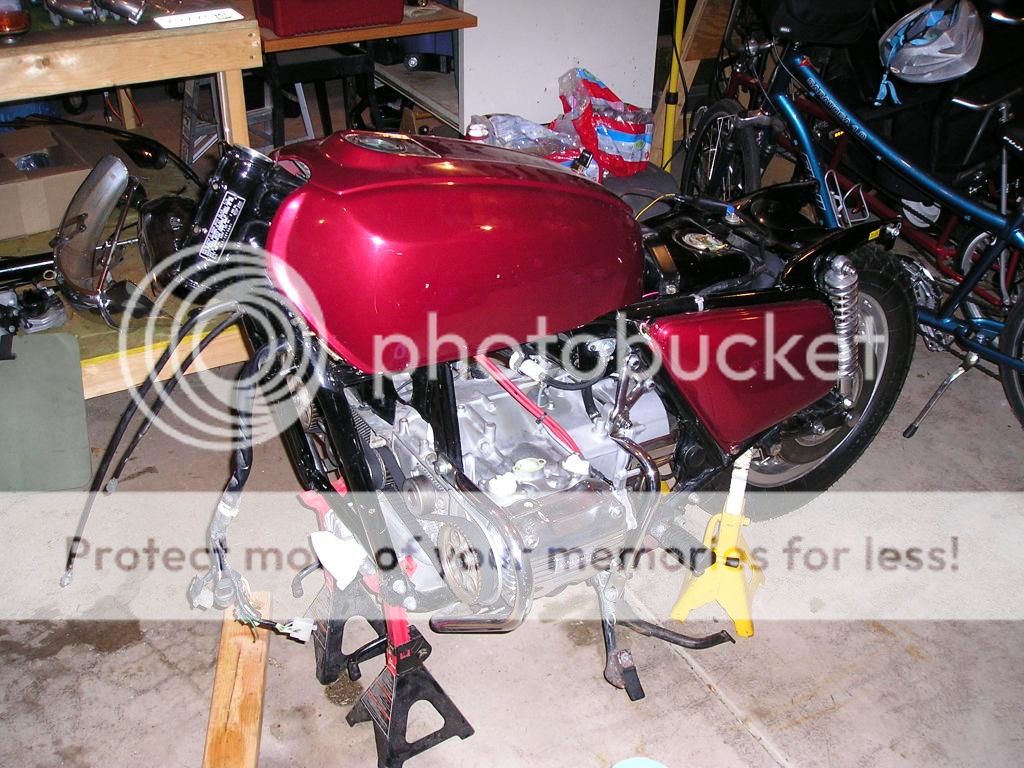

Here's the bike as it sits:
1976 GL1000 "Double Nature" https://youtu.be/IK0YS2uuZtc

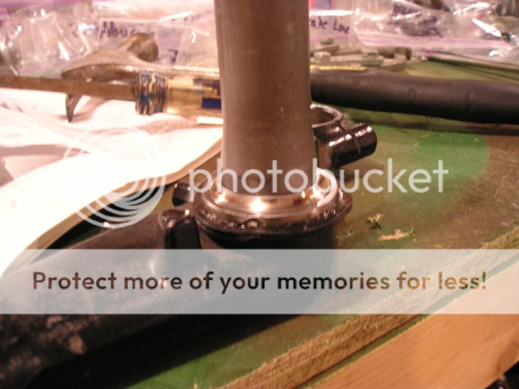

The issue I currently have is the bottom bearing seal/cup from the old bearings are stuck on the bottom of the steering stem. How do you get that off of there?

I haven't tried it, but this was posted a while ago, IIRC by puffy75.

Mine on the 77 were a PITA also. I just kept working it lightly with a punch and screwdriver and eventually it started to move. I have heard of others using a dremel cut off wheel to split it and speed things up.
The most important thing is not to score the surface of the stem where the race sits.

Geez what a PITA. Still stuck on there...Mother Honda says nothing in the manual either. I like the double pry method, I'll try that tomorrow otherwise I'll just have to cut it.

Found it. It was puffy75. http://www.ngwclub.com/forum/viewtopic. ... 89#p131489
puffy75 wrote:I have posted a picture(in my gallery) of the method the training center teaches to remove the lower race on steering stems. Doing this in small increments from side to side so the race or pry bar does not gouge the pipe. It is a snug fit but a little finesse will get it off.

Thank you all, I have been victorious! Puffy75's method did the trick and it was surprisingly easy to do! It only took about 3 minutes to get the bearing off.
I used a single pry bar and held the tree down by hand with the steering stem facing up. I put the edge of the bar under it like the photo shows and just leaned lightly on the pry bar. I went back and forth about 12 times on each side and it was off! I didn't even break a sweat, thanks again!

+1 I just tried it on a tree I have on the shelf. Very easy to do, and as I don't have welding equipment or a dremel, it's my solution of choice.ole496 wrote:Thank you all, I have been victorious! Puffy75's method did the trick and it was surprisingly easy to do! It only took about 3 minutes to get the bearing off.
