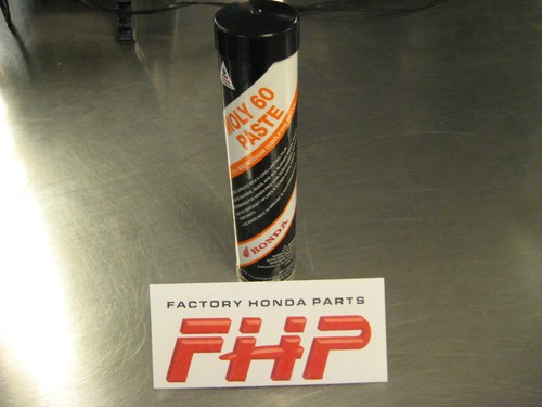

Where does Honda recommend using Moly 60 on the rear wheel splines?
I am asking this because I can't find it anywhere. Here is what I have found in Honda manuals about lubricating the splines:
P. 11-14 of the GL1100 FSM says "Apply lithium based multipurpose NLGI No. 2 (MOS2 - additive) grease to the damper pins, final driven gear's inner surface and splines and to the final driven gear flange splines"
P. 204 of the GL500/650 FSM says "Lubricate the splines of the final driven flange and the O-ring with lithium-based MULTIPURPOSE NLGI No. 2 (molybdenum disulfide additive) GREASE"
The capitals are Honda's. It almost looks like they were specifically stressing "multipurpose" and "grease" in order to tell us that we should not use moly 60 (which is technically a paste anyway and really intended as assembly lube for engine parts).
I have a feeling that moly 60 may go down in the annals as a myth like the need for silicate free coolant: someone read something somewhere, misinterpreted it and then quoted (or maybe misquoted?) it on the web where it was spread around and became part of the lore.
FWIW, my 'Wing had almost 100,000 Km on it the last time I had the rear wheel off and the splines were in like new condition. For over 70,000 of that I used whatever flavour of grease I happened to have on hand, usually ordinary wheel bearing grease and never noticed the moly requirement. When I started seeing moly mentioned on the forums and I looked more closely at the FSM and bought some NLGI No. 2 lithium based grease with molybdenum.
