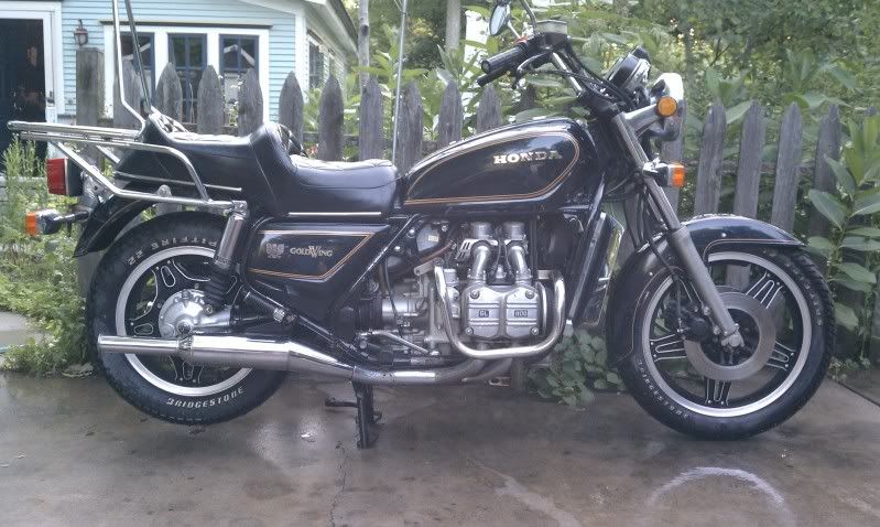

http://i100.photobucket.com/albums/m29/ ... AG0163.jpgFred Camper wrote:Is that a standard 81 seat? Those get pretty good reviews and they look nice too. So then it would be great to repair it if you can.
It looks like the seat on the pic in this link. Not sure if it is a standard seat or some other Goldwing seat

- Posts: 16011
Re: resurrecting a 81 standard
Looks like the stock seat .
