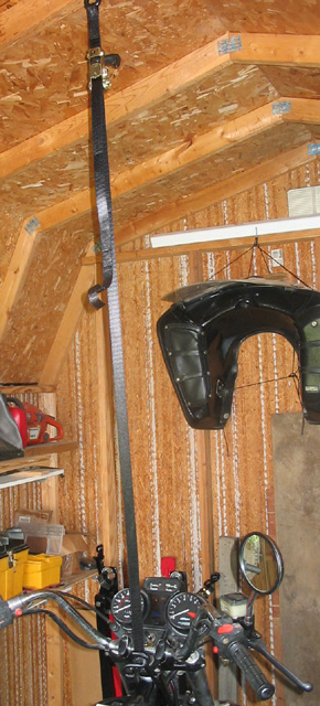

Put the bike on the centerstand and lift the front end until the back tire is firmly on the ground. It helps to have a jack or friend named Jack to help with this. Or, have a big girlfriend sit on the back seat.
I had none of that so this is what I call a skyhook and I used it to lift the front end. I kept it taut even after everything else was stabilized. Safety.
[attachment=18]0support1.jpg[/attachment]

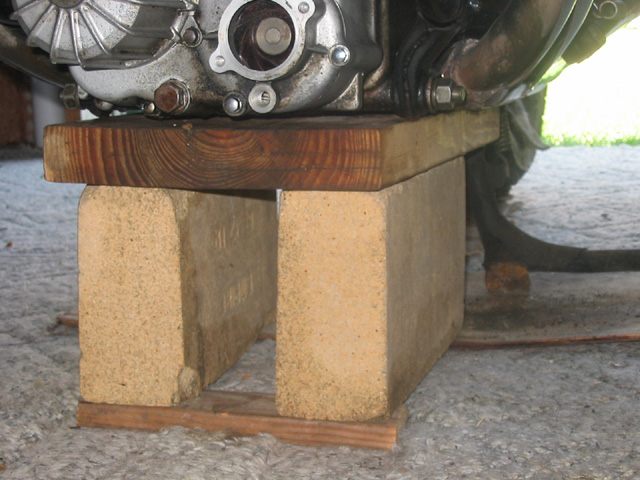

Use blocks, lumber, or whatever under the front of the engine and frame to support the bike.
[attachment=17]00support.jpg[/attachment]

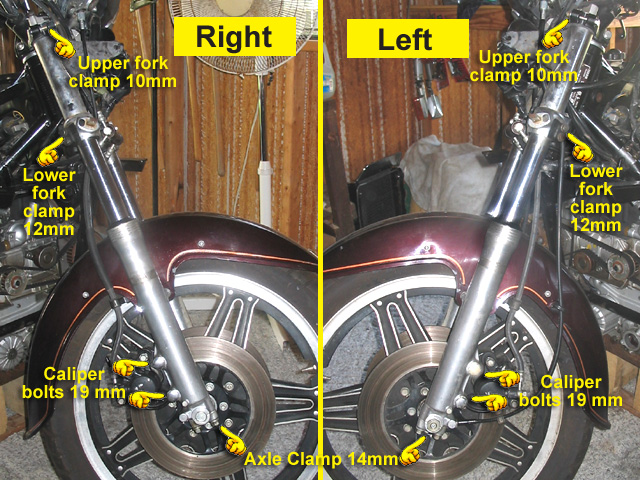

A brief tour of where you'll be going. Have a nice trip.
[attachment=16]1tour.jpg[/attachment]

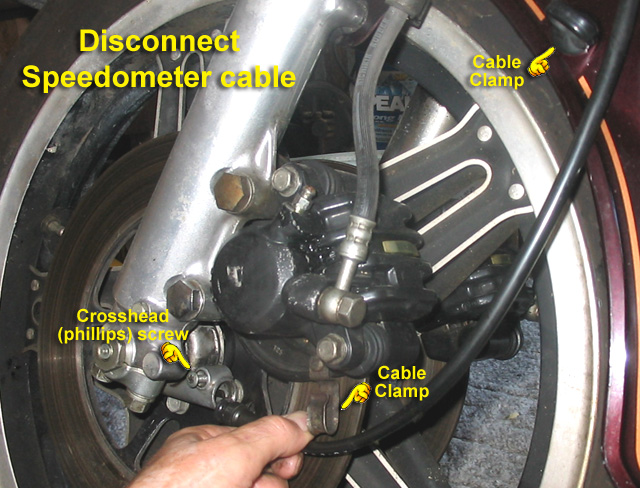

Unhook the speedo cable, remove it from the clamps and get it out of the way.
[attachment=15]2speedo.jpg[/attachment]

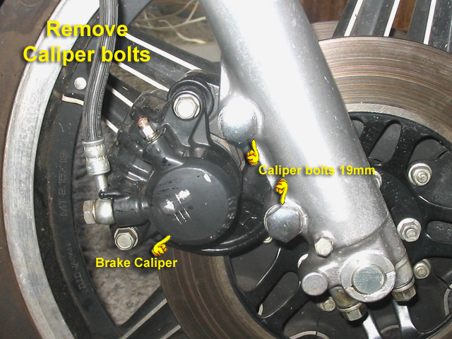

Remove the caliper bolts, support them as you're loosening so they doesn't slam into something.
[attachment=14]3calipers.jpg[/attachment]

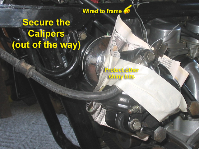

Wrap and secure the calipers back above the engine. I wired them to the frame.
[attachment=13]4securecalips.jpg[/attachment]

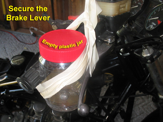

Secure the brake lever so you don't accidentally press it and close the brake shoes. They're a pain to move back (dunno how I know that...).
[attachment=12]5securebrake.jpg[/attachment]

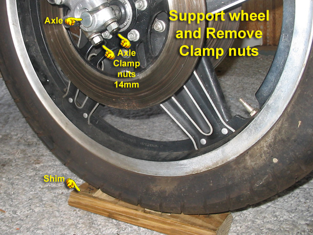

Support the wheel and then loosen the axle clamp nuts and pull out the axle.
Remove the shim under the wheel and roll it out.
[attachment=11]6axleclamps.jpg[/attachment]

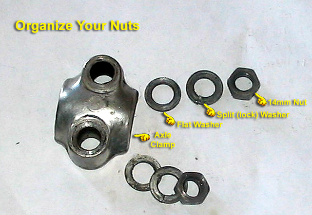

Keep your junk in order. Use plastic tubs, bags or cups. Keep left and right separate and organized and it'll go back together easier.
Note that the Axle Clamps are marked on one edge with an "F" and and arrow pointing to the front. This is important when reassembling.
[attachment=10]7organizenuts.jpg[/attachment]

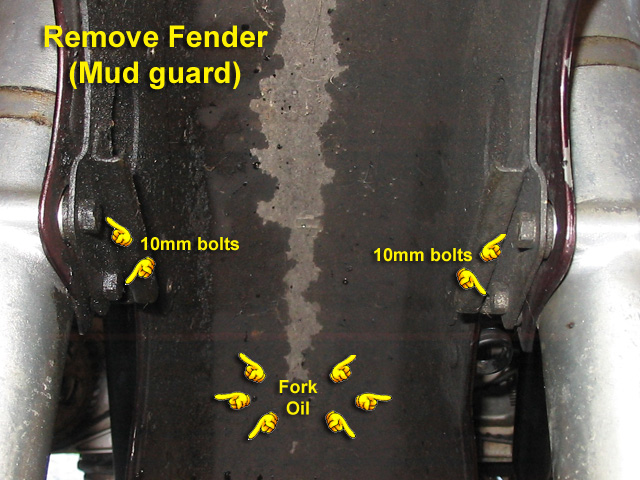

Remove the fender.
[attachment=9]8fender.jpg[/attachment]

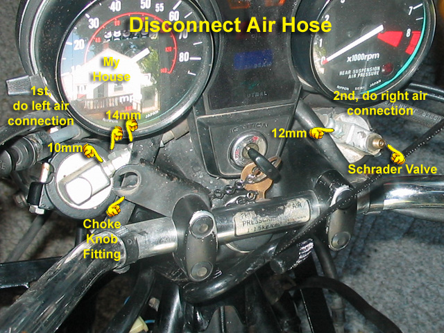

Unhook the choke connection and move the cable and knob out of the way. Release any air using the Shrader valve. Undo the left connector. Undo the right connector. Pull the hose out to the right.
[attachment=8]9airhose.jpg[/attachment]
Loosen both of the caps at the top of the forks with a 17mm(?) wrench but don't remove them. There are massive springs under there that could make those caps into effective WMDs.
Remove the upper 10mm and lower 12mm fork clamp bolts. The fork should now slide down and out smoothly. Refer to the "tour" picture above.

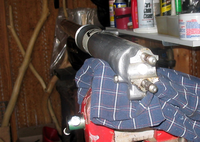

Wrap/protect the fork and clamp it in your vice on the caliper brackets.
jdvorchak wrote:What roady left out was that those forks are full of the nastiest looking oil you've ever seen. When you either pull the fork caps, to remove the springs or pull the allen out of the bottom keep in your mind that there is about 10 oz or more of this nasty stuff in each fork.
I have loosened the fork caps in a vise like that thread shows and have also done it with the forks still in the triple tree and clamped down. I prefer to leave the forks in the triple tree, loosen the fork caps. Just break them loose about 1/2 turn. Them remove the forks and go to the vise. You want to keep the spring pressure on them so you can easily remove that allen bolt in the bottom. Once the allen is out you can finish removing the fork caps. The springs are under a lot of tension so be careful when you remove the caps. It's not as bad as it sounds but you may have to chase one of two of those caps across the garage floor.
On re-assembly if you have trouble getting the springs back in, leave them out until you mount the forks and wheel back on the bike. Fill the tubes with the recommended amount of fork oil ( I use ATF per Honda) then insert the springs and caps. With the forks and wheel mounted you can get "above" the fork caps to compress the springs and begin tightening the fork caps.
[attachment=7]10clamped.jpg[/attachment]

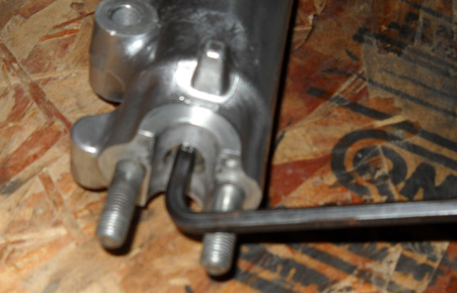

Remove the allen bolt at the bottom of the fork.

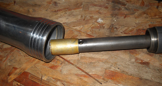

Put the damper rod seat on the stanchion and fit it into the lower fork leg.
[attachment=2]fork_damperseat.jpg[/attachment]

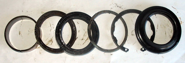

[attachment=5]12ducksinarow.jpg[/attachment]
And how those ducks look on the stanchion.
[attachment=1]fork_order.jpg[/attachment]

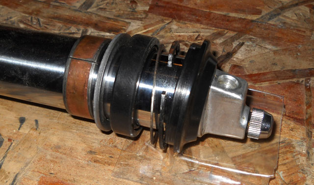

A 3' long piece of 1-1/2" PVC pipe is an effective punch to put in the new seals. Slide the lower bush and thick backing ring down the upper leg and into the top of the lower leg. Slip the PVC down and tap them in, it doesn't take much and you won't need a hammer. Lightly oil the new seal and tap it down with the PVC until the circlip groove is fully revealed.
[attachment=0]fork_pvc.jpg[/attachment]
Add the thin backing ring and finally, refit the circlip and upper dust seal.
[attachment=3]fork_circlip.jpg[/attachment]
