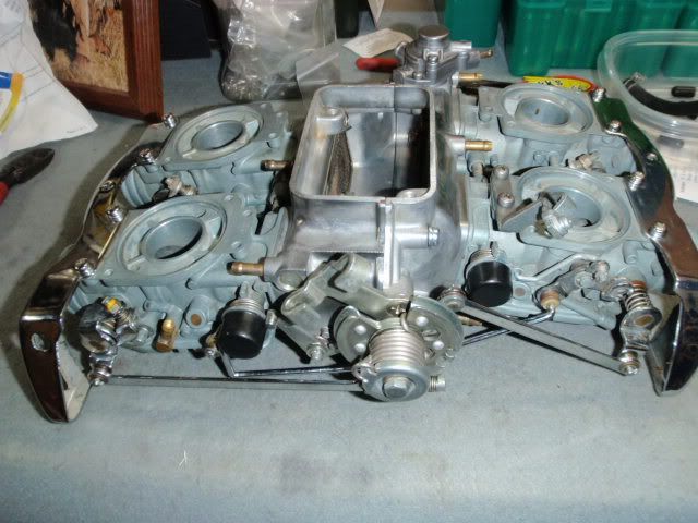

Re: And away we go . . . . LTD style

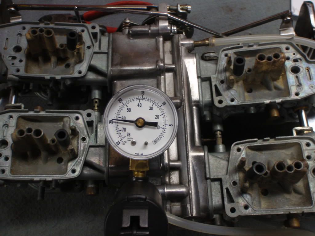

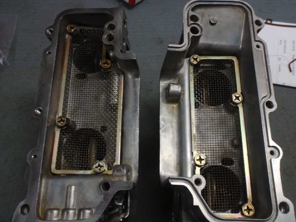

I decided to get some work done on the carbs. I got the parts all cleaned up. First with simple green then twice with brake cleaner and air.

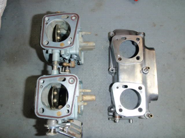

Then came the gaskets and alignment pins.

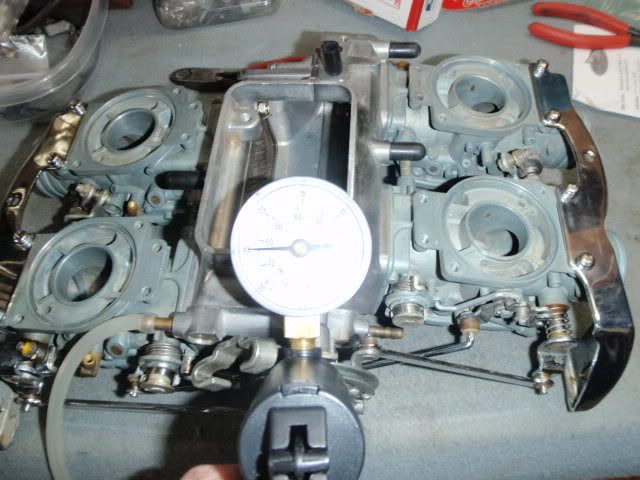

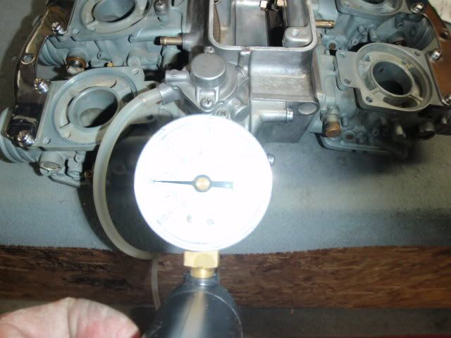

Then tested for leaks.
The rebuilt the air cutoff and tested.
Can't go much further until I get some carb parts. I have a bunch of little stuff to order. I'll get that done in the next few days and continue this in 2012.
