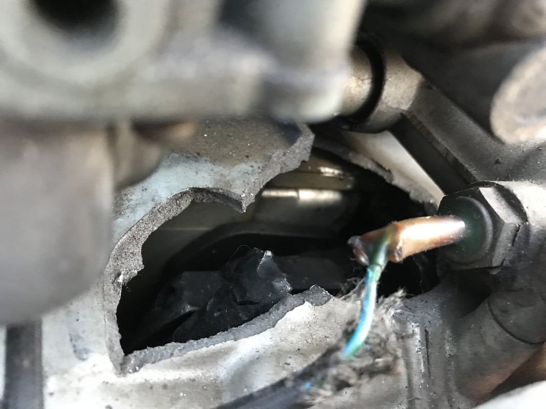

I haven’t seen this kind of catastrophic failure in a long time. Rod snapped just above the crank end.
Back story- bought a cheap 1977 non runner because I needed the CA titled rolling frame to transplant my good parts into. I didn’t care about engine condition, I didn’t even attempt to turn it over before I pulled it out.
“Needs carb cleaning” I’m sure :)
I’ll tear it apart when I get some downtime, any guesses as to what failed? Maybe seized water pump took the oil pump with it? Ran hard after hydrolock? It was full of oil, I know because I spilled most of it.

Ugh. I’ve actually seen one or two come across these pages with the top blown out like that. I suppose when a rod goes, it can exit for daylight in any direction it chooses.

Possible sludge buildup in crank passages causing oil loss to the rod bearing. Or the scavange pump died and all of the oil ending up in the clutch area. I think a lot of car fires seen on the interstates are from people running the car almost out of oil, snapping a rod that slices the oil pan dumping what is left of the oil on the exhaust manifold. Usually the give-away is an oil trsil to the burning hulk. We had a 421 Pontiac that had changed to solid lifters, pumped all of the oil into the valve covers, snapped the first rod slashing the pan and dumping the oil on the headers going down the front straight. I got the fun at 15 of pulling that one apart.
