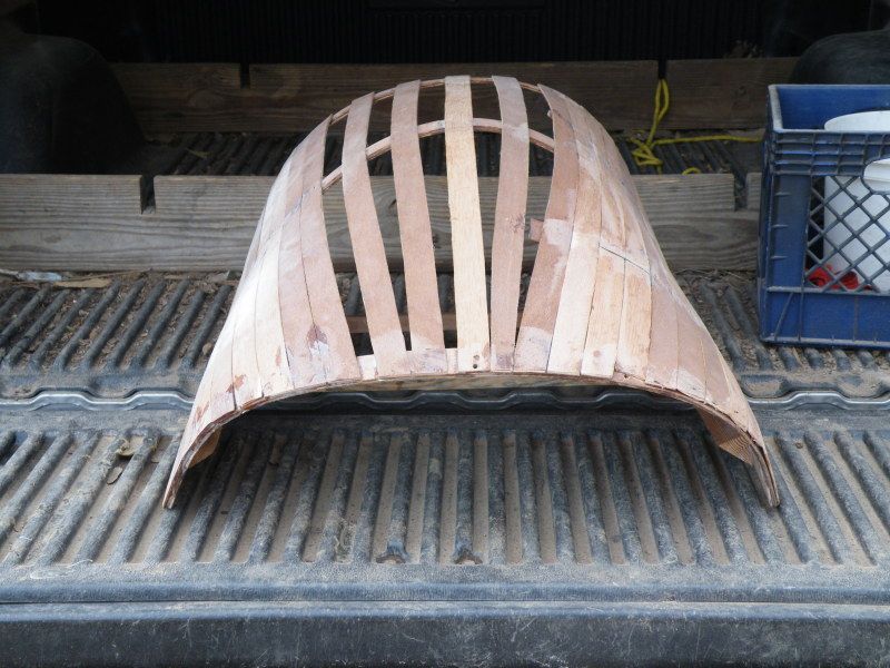

I started with some doorskin strips and clamped them to the odd-shaped windscreen and glued up three lams to get the shape, and also laminated three strips on the aft end by using the excisting holes for the snaps for the soft top.

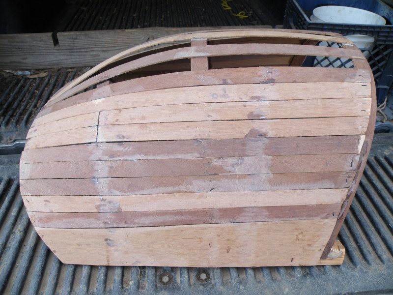

Then I started stapling and gluing with epoxy the fore and aft pieces.
Image until I got this..

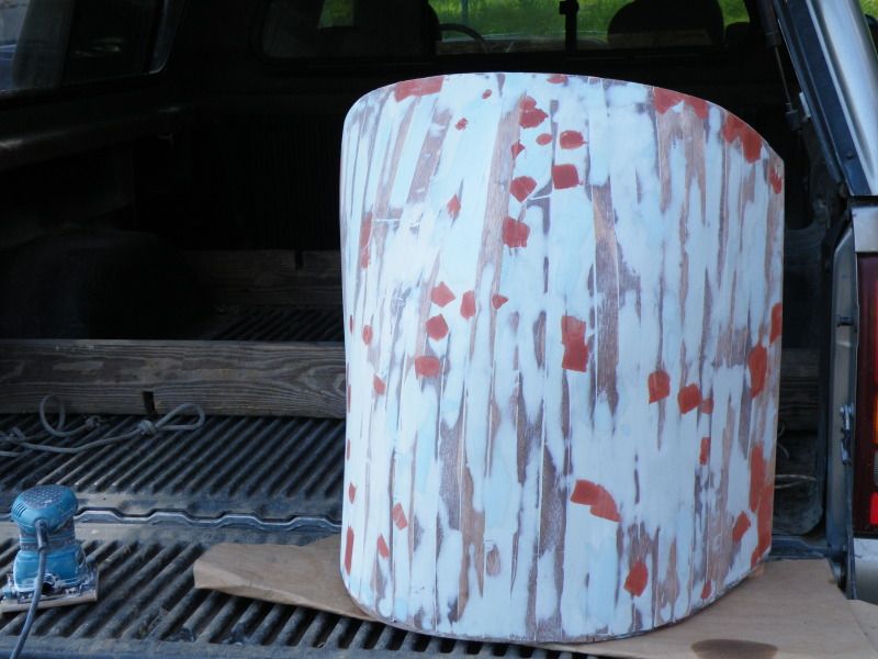

Image. I just kept filling in the blanks untill I could fair the whole thing using some old but still viable bondo, and finally some spot putty, resulting in this

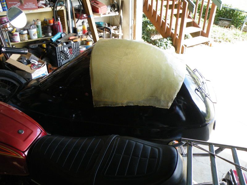

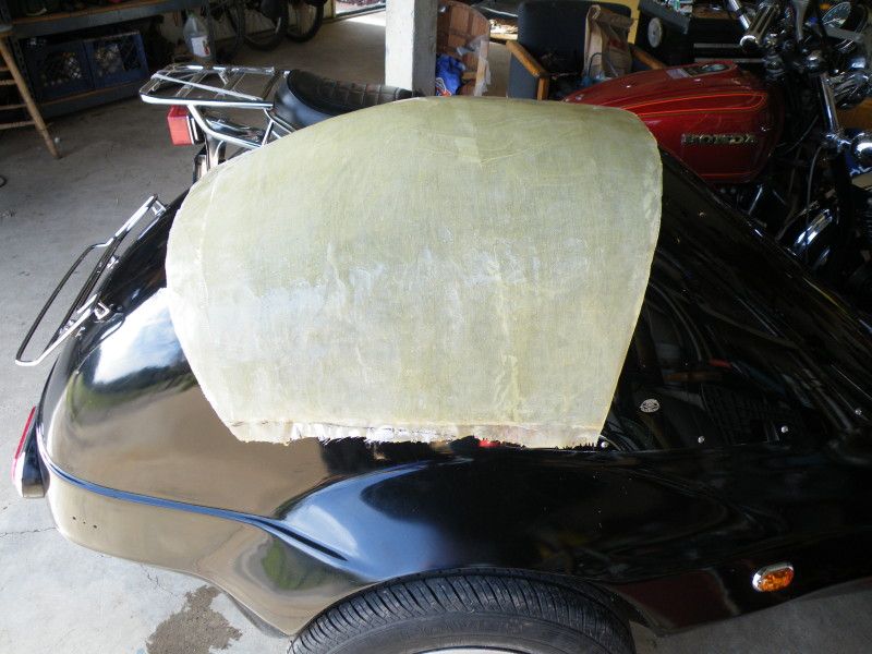

My next step was to laminate four layers of glass over the male mold, using wax paper as a release.
Re: Building a sidecar hardtop.
Of course there was a lot of sanding in there, and I really smoothed it out more than I needed to because no one will see the inside once it is finished.
I just got some black pigment to add to the epoxy, but I may not use it because I still have to spray on undercoat. What is on todays do list is to extend and strengthen the sides with some epoxy, thickener, and 'glass. When that cures, I'll add one more layer of 'glass over the whole thing, and then fiberglass tape along the edges as needed. Then more sanding and fairing on the outside precluding painting with one part linear polyurathane, same as I used to paint the sidecar itself with.
