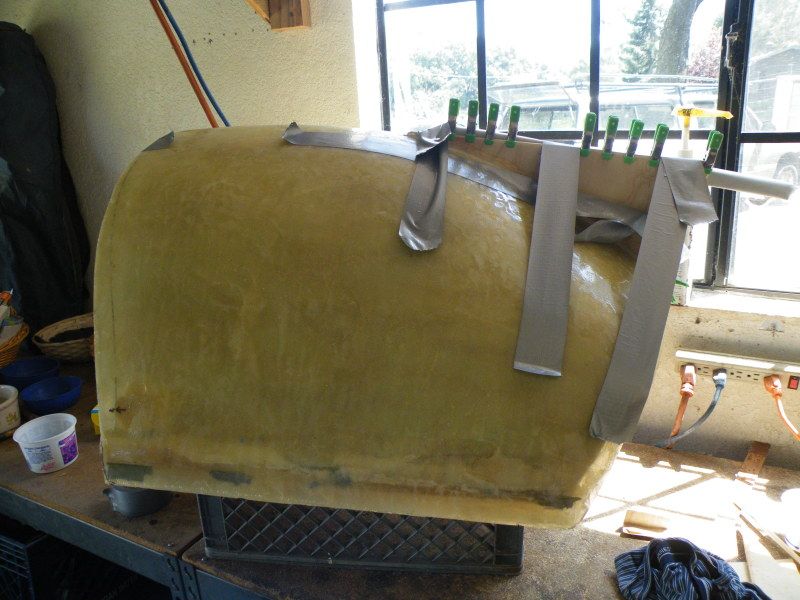

Here are a few pics from today..
Image I was trying to straighten out the plywood a little with some bar stock; that is why all the clamps are on the top. The duct tape was keeping it more or less in place.

Re: Building a sidecar hardtop.
#25
Post by bladredhead »
cool
would be rad to make the fin look like a 60s caddy
glassing part way up it will add a lot of strength. as it sits right now, any horizontal load will put the epoxy in peel loading immediately, which is exactly what you don't want to do to adhesive joints
