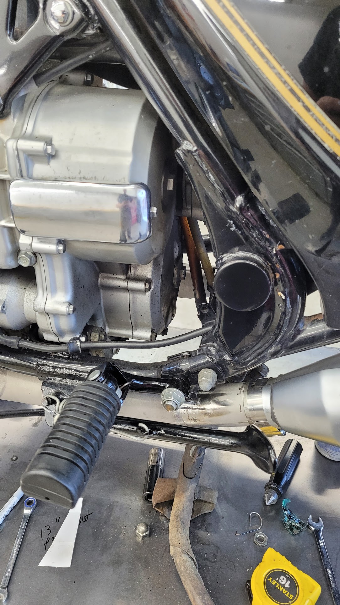

I finished off the exhaust and the brackets. I powder coated the brackets gloss black and sprayed the exhaust headers with Cerakote - Tungsten, a dark grey that I really like.
While I was at it I cleaned up the kickstand and powder coated it as well
I couldnt find the proper foot pegs so I ended up with '79's I believe. They were a bit rough and needed some mods to fit the '80 so I rejuvenated them and of course powder coated them as well. Feel and look better than new!
I cut off the original locating nub and spot welded a new one on

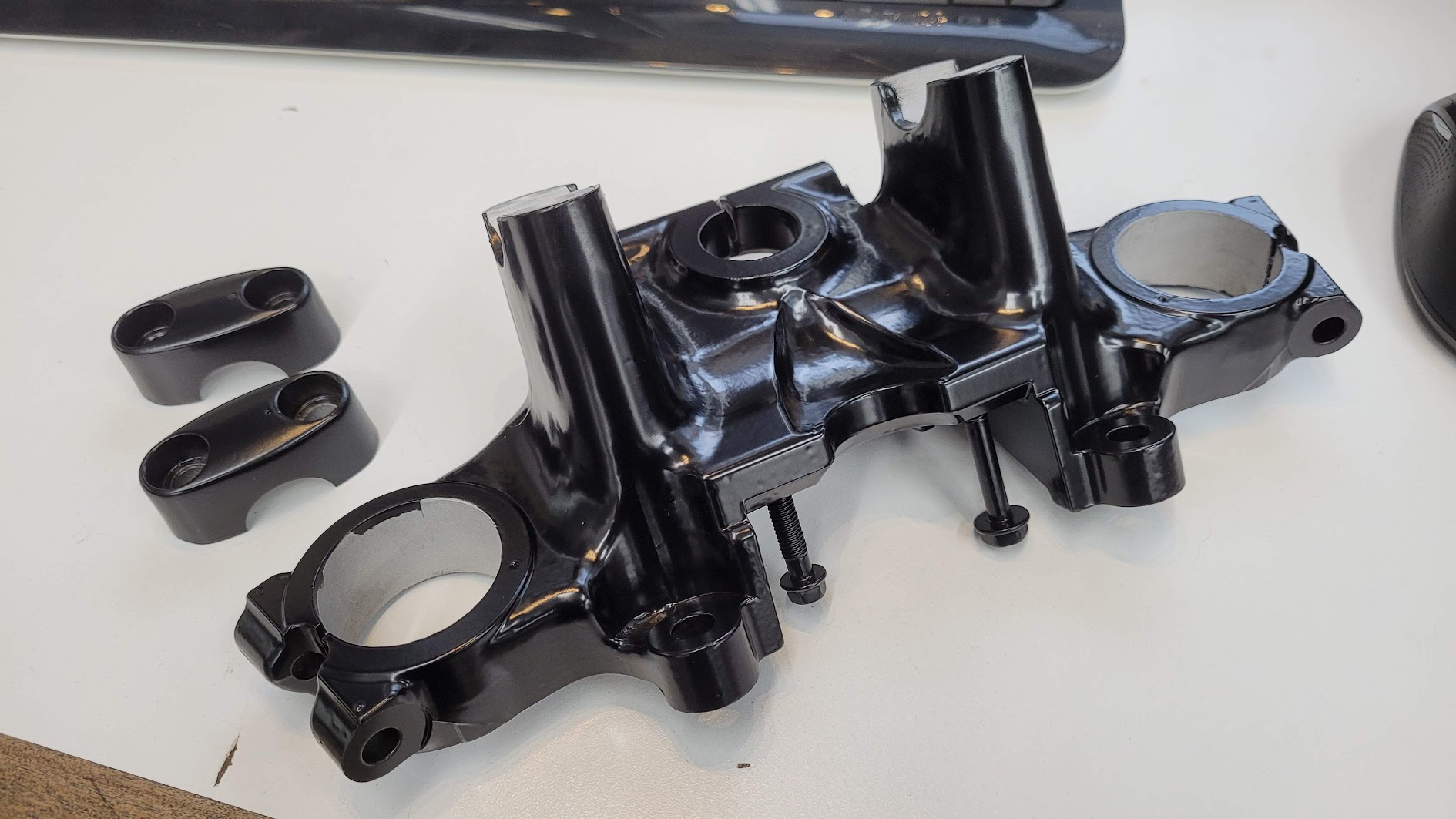

Fresh powder coat on the upper triple tree

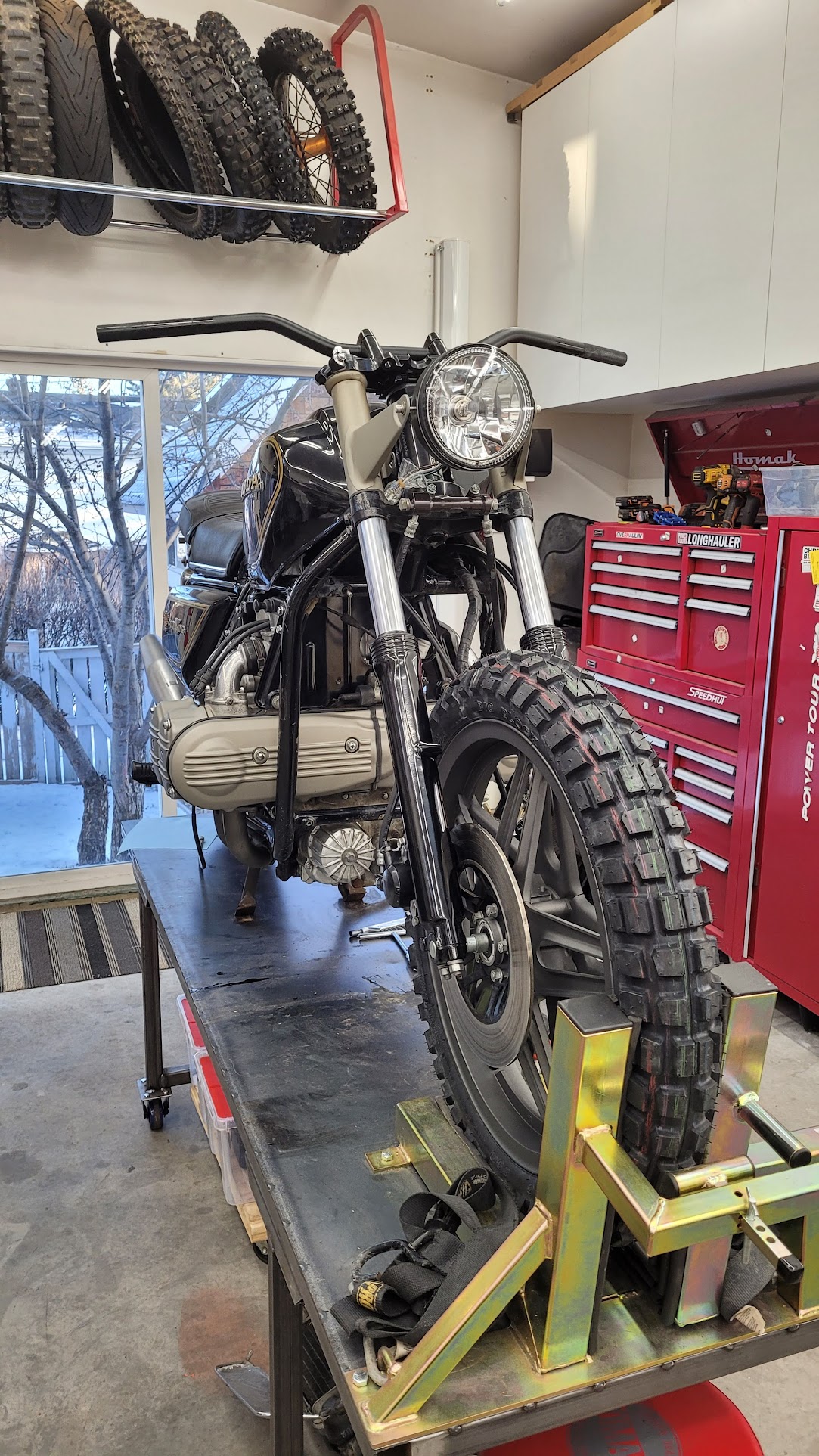

I then built some custom length cables with the throttle and clutch cable kits from Revival Cycles. Great stuff. Oh, and I converted it to single cable throttle.
She's back up on the stand right now but this is about how it looks right now.
Now to get to work on the fenders. Here's a preview of things to come:
