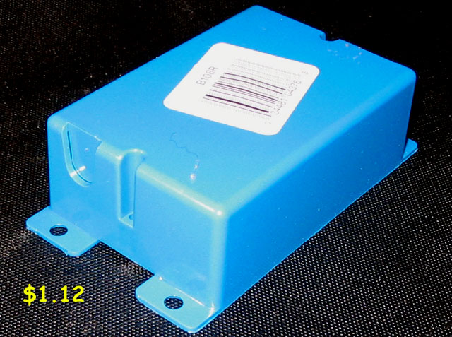

After about an hour I was back in the electrical aisle and found an "old work" box that had two corners without any knockouts. I now had a plan! I picked up two of them (you know, 1st the prototype, then the finished product) and headed back to the shop (well, the basement anyway).
[attachment=8]2bluebox.jpg[/attachment]

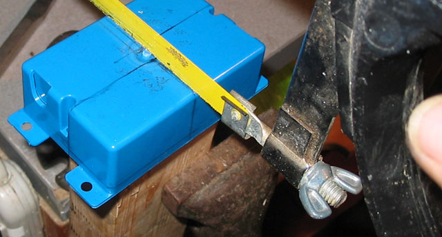

I marked up one of the boxes. 1-3/4" x 1" x 1". Then I went at it with my trusty hacksaw.
[attachment=7]3cutting.jpg[/attachment]

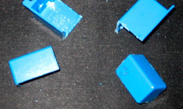

Soon I had the necessary pieces for my little blue boxes. The top, front and outside end are from the corner of the original box. The rear facing side was cut from the scrap.
[attachment=6]4pieces.jpg[/attachment]

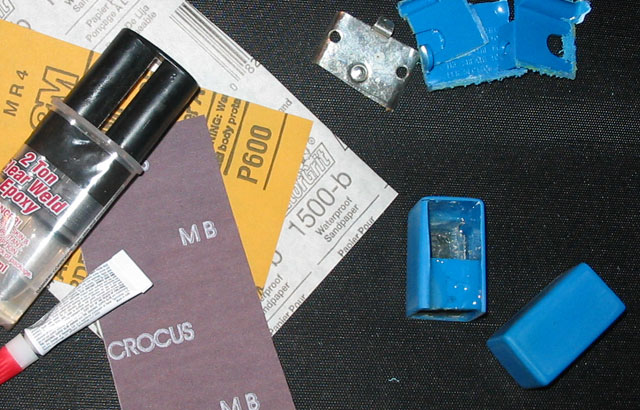

I tacked the pieces together with dots of super-glue. To make them a bit stronger at the set-screw connection, I found a metal bracket in my vast junk collection and cut it to fit on the boxes' inside-top.
A liberal dose of epoxy and 24-hours later my 4-1/2 sided boxes were ready for finishing work. The boxes were shaped with 150 grit sandpaper and then finished with 600, 1500 and crocus cloth.

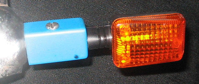

And here's the (almost) finished product. A prototype good enough for done and I got $1.12 back on the box I didn't use. I kinda like the blue but will probably go gloss black.
[attachment=1]10finish.jpg[/attachment]
