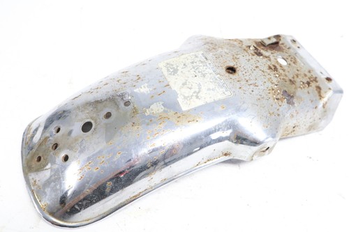

Tell.me more about the CX fender?

Bought it rusted out on eBay. The width and bolt pattern matches my 1200 perfectly. All I had to do was cut a bit off the inboard side of it to get the clearance I wanted. Otherwise direct bolt on.

So you have any close pictures of it?

Here's how it came to me:
I cut off a few inches behind the bolt holes; conveniently, that was where the rust pitting was. Media blasted and treated the rust, then epoxy primer and paint.
I filled in the misc holes and re-drilled for my tail light and some pass-thru holes with grommets for the wires. there is also a flexible wire retainer underneath that came in handy.
I believe I also ran a bolt vertically down from the frame crossmember thru the fender to stabilize it front to back, at the proper angle
