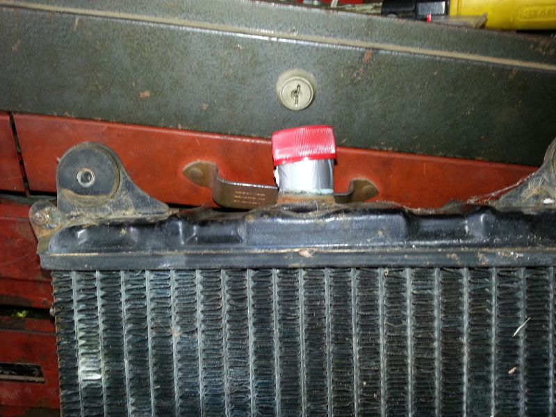

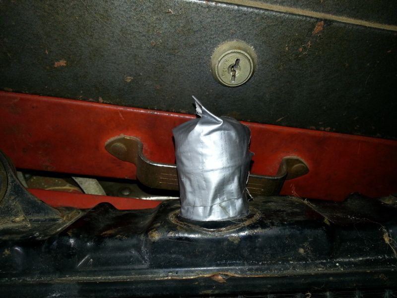

Inside of the radiator did not look too bad, so I have opted for a vinegar flush/soak. Needed to plug the bottom.
Wrapped up the end in duct tape. Put a soda cap on there and then taped over that.
Does it leak? Yep, but holds enough to soak it for a bit. Afterwards, I will wash it with baking soda and water.

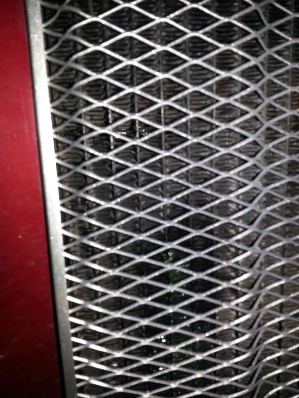

Well, I got the radiator mounted up last weekend and what do I find today when I fill it? a hole. Drat!

You can see the leak on the left side. I wonder if it is fixable...

Two options: 1) Take it to a radiator shop and see if they can replace the core or 2) Get a used radiator from a fellow forum member or Ebay that may or may not be better than what you have.
