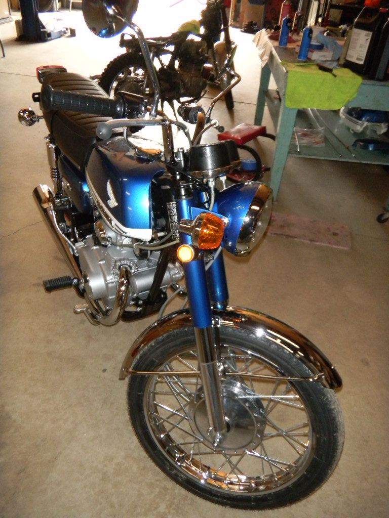

Connected a remote tank to start the engine (sealer in stock tank needs to dry a little longer).
Didn't need to choke it too long (shop temp about 60deg). Startled me it fired so quickly, went right up to 3,000rpm. Adjusted the idle screws and then the pilots. Left carb pilot wouldn't adjust. Double checked the coil, it was firing good. Checked the exhaust temp... left side was down 35-50deg than the right. Thinking I might have a plugged idle jet or restricted passage. Will work on it later this week. Other than that it sounds really good, and the charging system works (12.4v@idle, 13.7v@3500rpm)

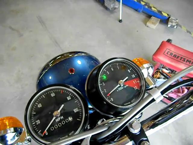

Took the left carburetor off. Idle jet was plugged. The orifice is really small, and I think some "crap" that might have been in the fuel line worked its way in.
Got it back together. Here's a short video of it running (sorry about the finger). Stills needs some tuning, but sounds good.
Still letting the sealer dry in the gas tank. Might get it on this weekend, along with the seat. Then I can ride it when weather permits.

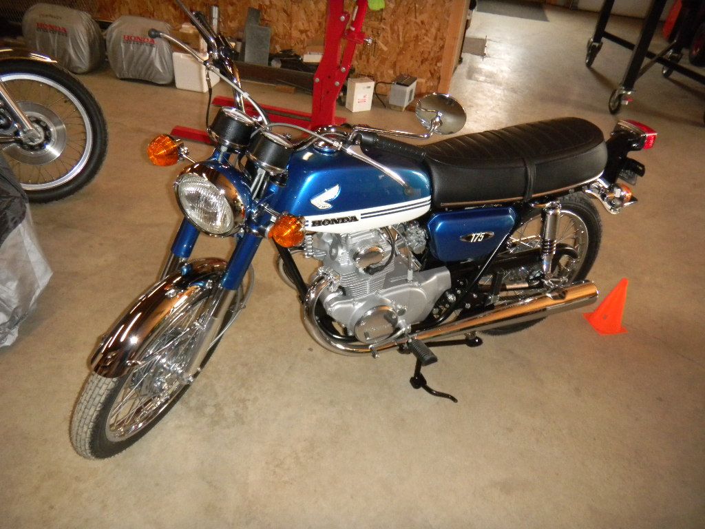

Yesterday, put the petcock on the tank. Tested it for leaks before mounting it on the bike. No Leaks
Since it was Saturday; I couldn't get insurance to ride it. But I couldn't resist... took it around the block (about 2 miles). I was so excited, I took off without a helmet. It ran & sounded great. Shifted through the gears, took it up to 50mph.
Unfortunately; the weather is turning colder, so won't ride her til maybe next weekend.
I'll post some better pictures later, but here's a couple after getting back.

Took the bike to see my friend Charlie in Galesburg. Put about 70 miles on it, ran great!

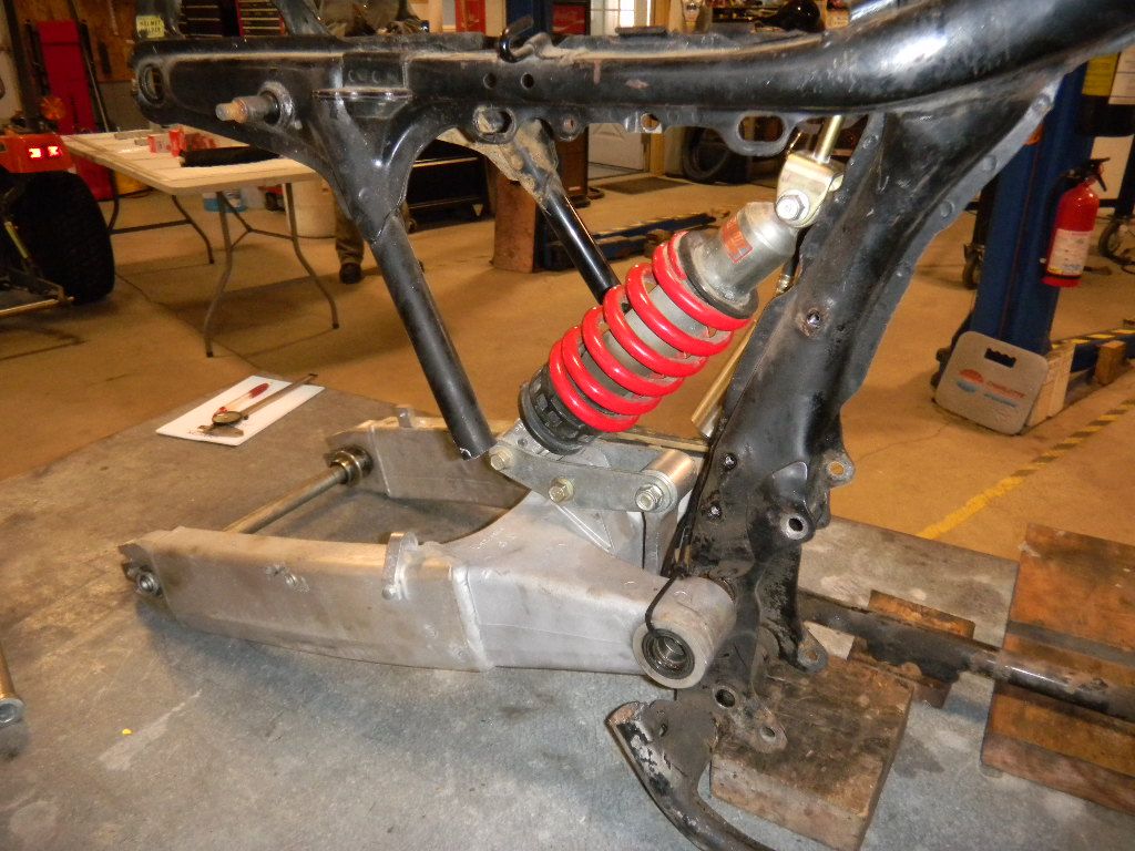

Time for the next project. '72 CB350 with some changes.
Still considering options, but here's one of the mods in progress...
