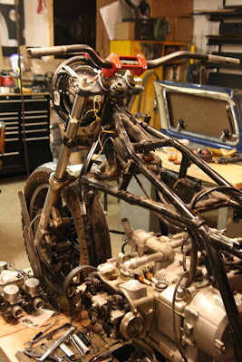

Been playing with tank options a bit, I'll make/modify something out of copper or aluminum, relocate the battery and section out for the rear wheel.
Playing with bars a bit as well, these aren't right, but they are the right direction.
I've not been doing any work on the wing though, have some other more pressing stuff to take care of. Will be out of town in a week for about a month, once I get back then work on the wing might progress a bit more.
The parts were on hand, and it works well for what it is. The monster wing is asking a bit much of it though. And yup, dentist chair base.
