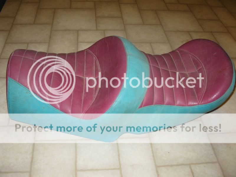

Where did you get that seat, Pago? I would love to see the bike it came from! I bet it was wild.

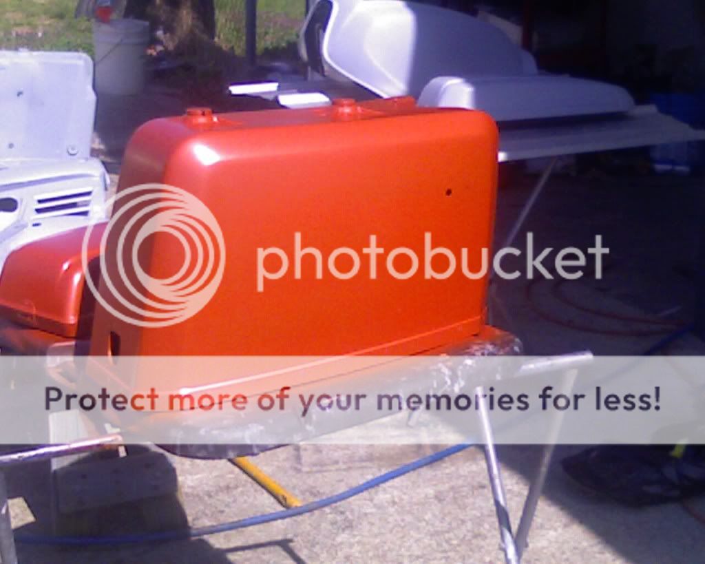

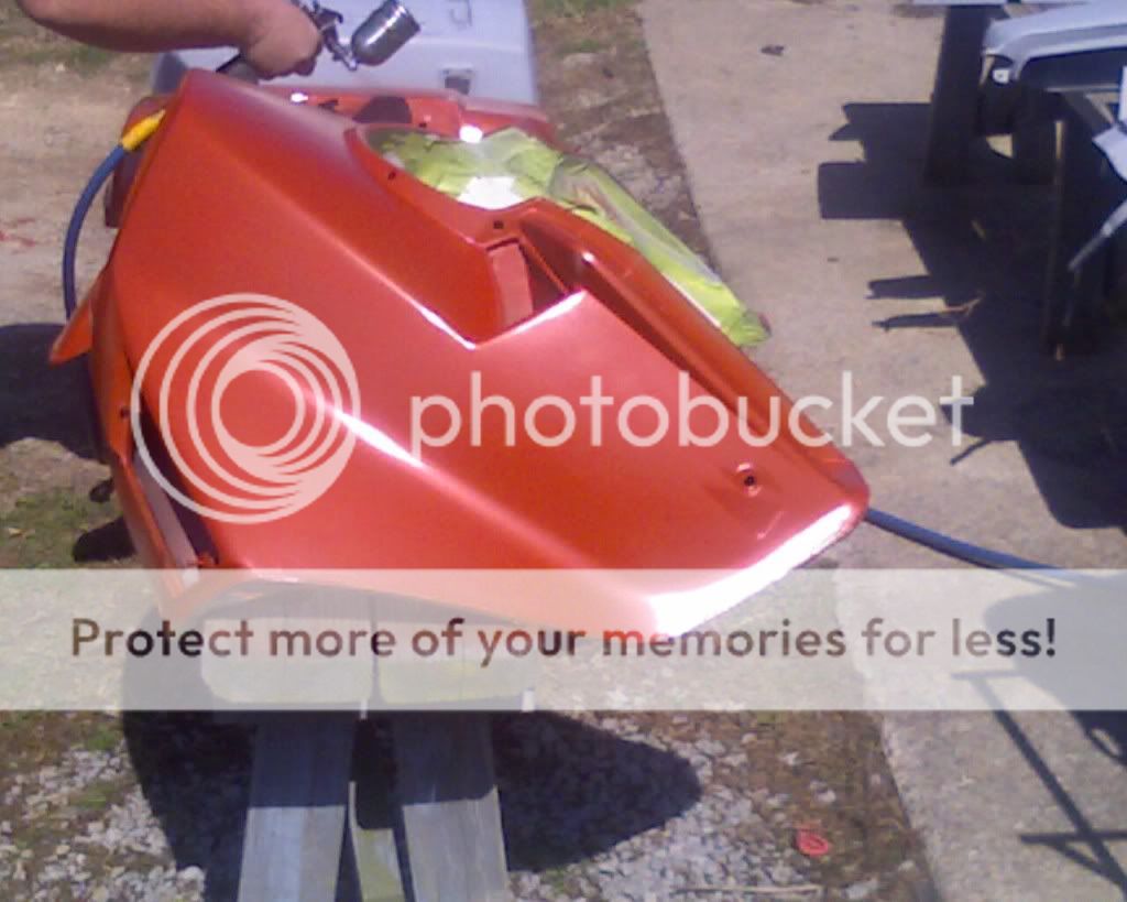

I started laying the paint it her yesterday. She's not going to be a show stopping bike, but I like the color so far. I plan on adding the second color this weekend, as long as the weather holds out. Here are a couple of pics of the base color.

Already have all of that. I am mainly just looking for add ons at this point. Finished recovering the seat and backrest my self back in December.

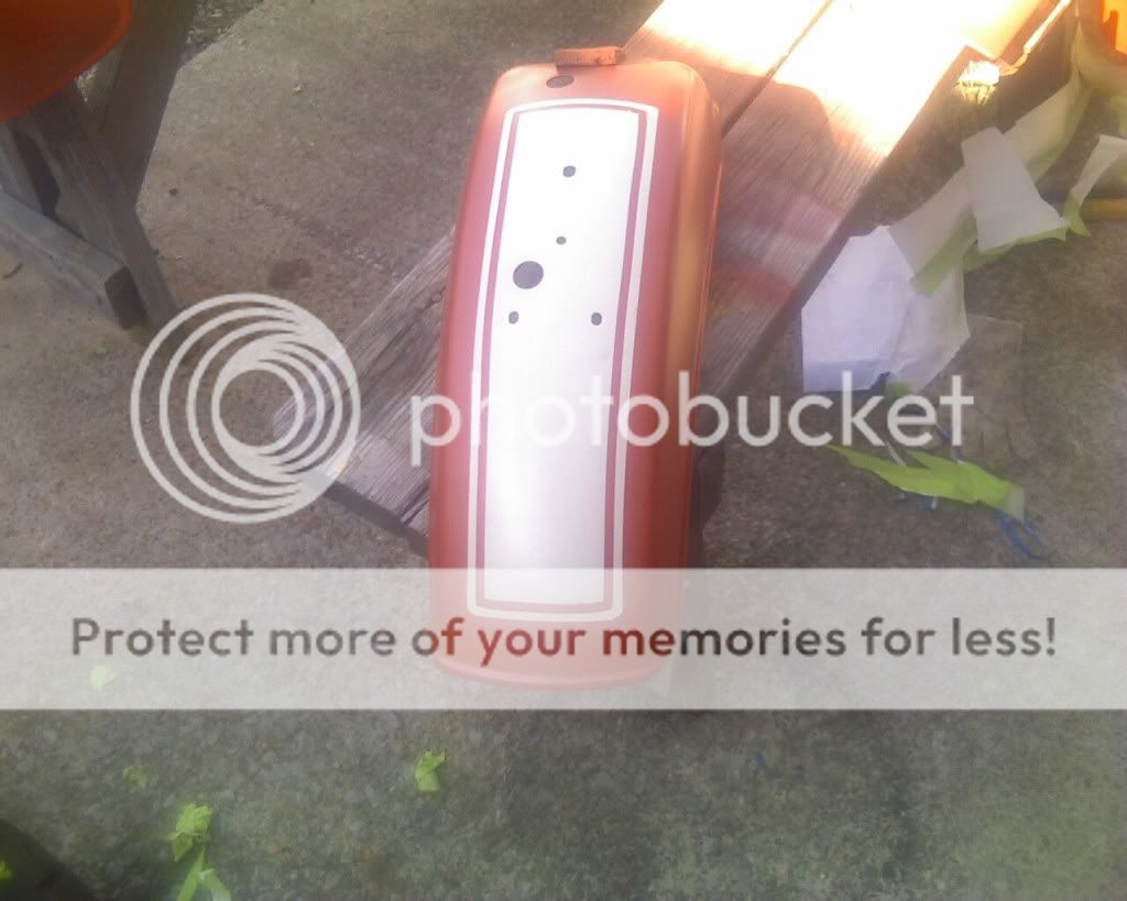

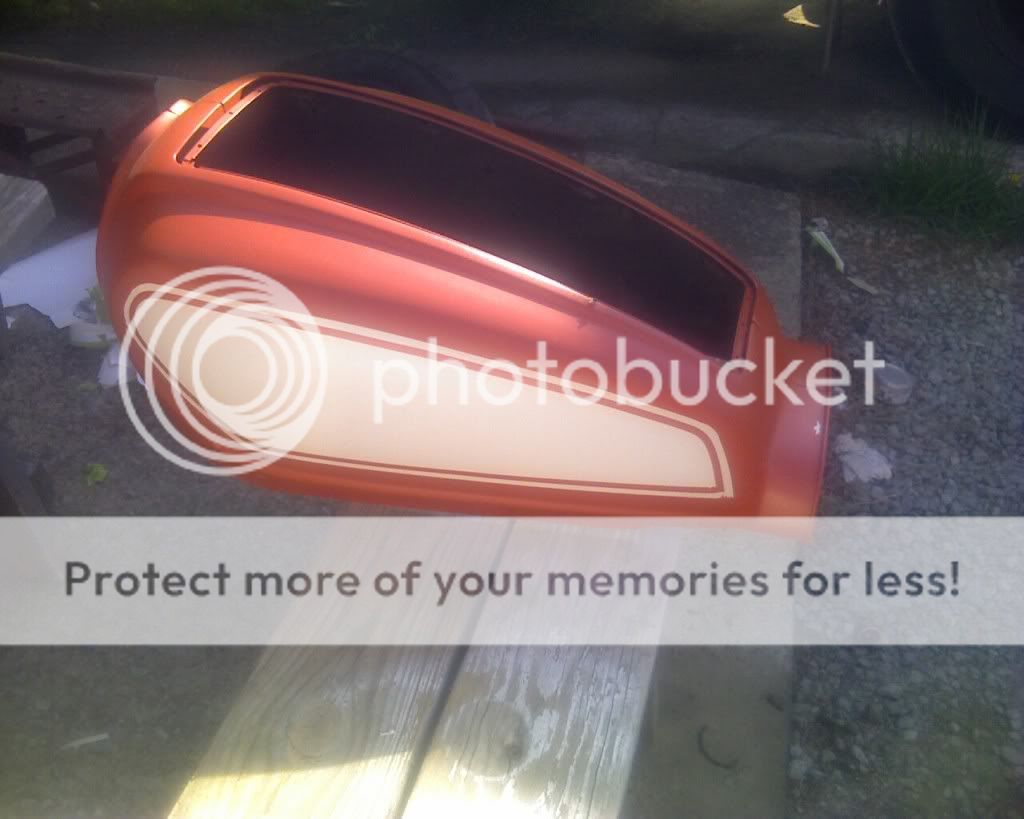

Not a lot of progress as of late, but I did finally get the second color sprayed. Unfortunately I'm going to have toredo part of it because the tape pulled part of the paint with it.
Here ate a couple of pics of the good pieces.

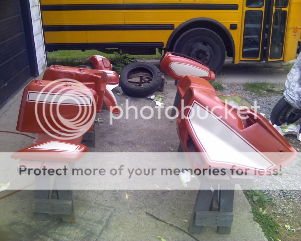

Well, I worked on the ongoing oil leak last night. Wasn't able to get it started then, due to lack of fuel, but fueled it up this morning, and cranked her up. In the beginning, I was a little upset. As she warmed up, I noticed a drip of oil still coming from the weep whole.
As she warmed up more and more, the drip became less and less. So I'm happier at this point. No more major dripping seen this evening before I left, which is a plus because there was a puddle of oil underneath the front of the engine, like I had an old Harley parked there instead of an old Wing.
We were able to get the clear sprayed on yesterday as well. In the sunlight, it has a pearl tone to it that I wasn't expecting. I'm elated. A couple of things with the paint are a couple of runs that you can't see unless you know they are there, and you can tell it wasn't professionally done, so I expect some smirks and sneers from people that see it in person, but like I've said before, she's not a show bike, she's going to be ridden, ALOT.

Re: 1980 1100I
You can't tell much by this pic, but you can see the reflection of some of the parts in the others so you can tell the clear is there. I need to get better pics for posting. Now I've got to start putting it all back together.
