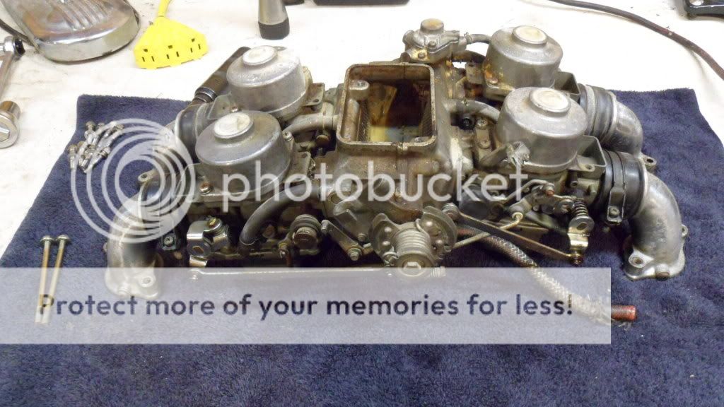

Well carbs are off. Time to see what they look like inside.

Re: 1976 GL1000 LTD
ZV, In my opinion you have made a huge mistake by taking those carbs off. To me, they look ready to roll! But seriously, I bet they have not been off that LTD before. With all that grime, gunk inside, original fuel line and red stripes on the carb lines, probably mother Honda installed those. Keep us posted. You and I are about at the same point with our bikes.

LOL, yeah. I bet you are glad you took those off.polkadot77 wrote:ZV, In my opinion you have made a huge mistake by taking those carbs off. To me, they look ready to roll! But seriously, I bet they have not been off that LTD before. With all that grime, gunk inside, original fuel line and red stripes on the carb lines, probably mother Honda installed those. Keep us posted. You and I are about at the same point with our bikes.

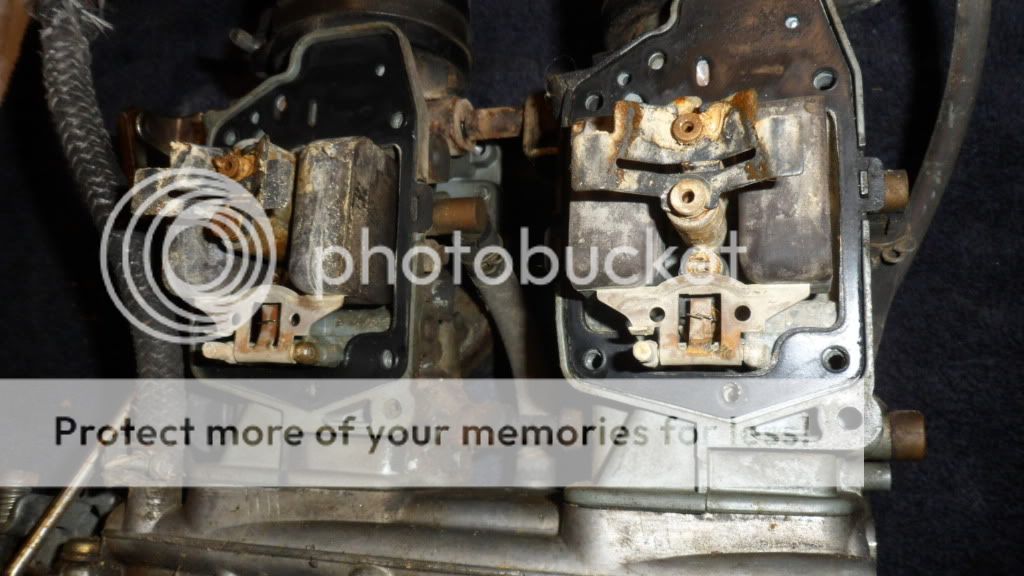

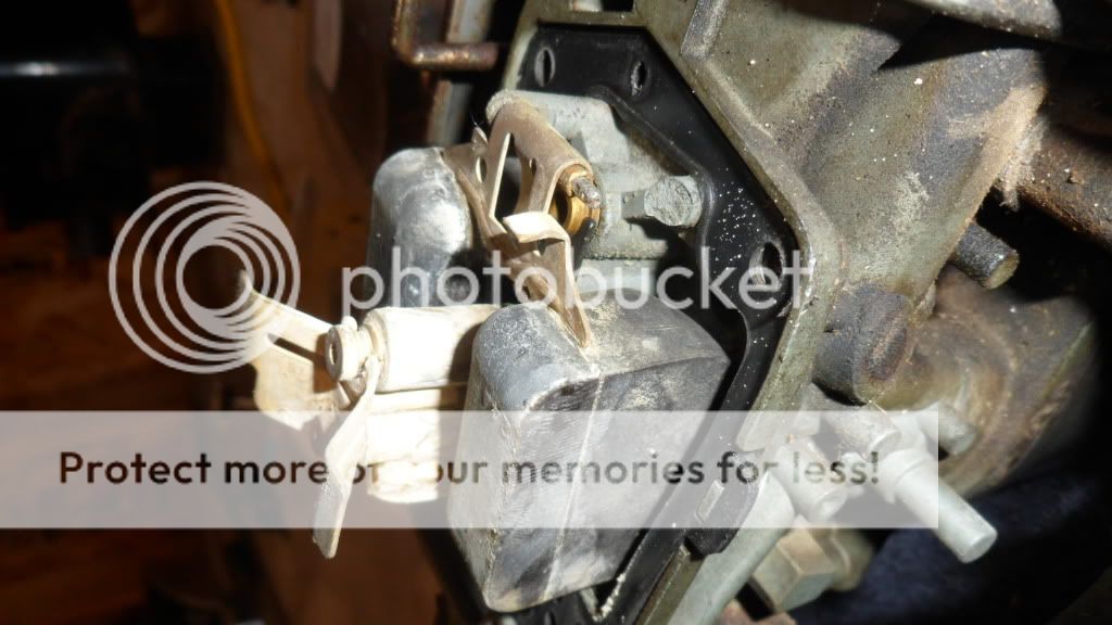

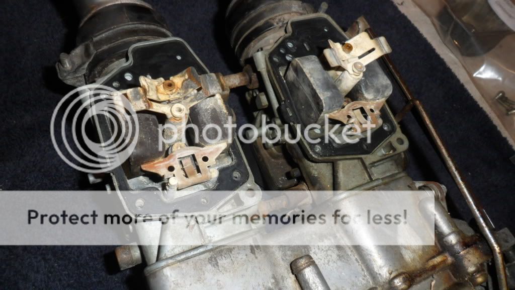

Had a quick chance to pull the carb bowls off tonight. Not pretty... one broken post. All of the floats (except for the one with the broken post) were stuck and barley moved. Explains the gas running straight through the engine.

Re: 1976 GL1000 LTD
Ohh, those do look nasty. But, probably clean-able.
Randakk has a kit to fix that broken post.
