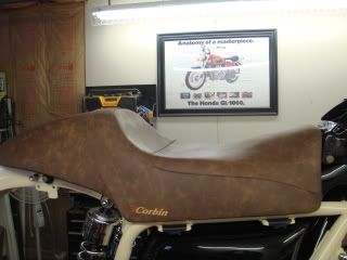

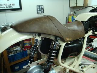

Today was a red letter day...my seat from Corbin came in! It's everything I hoped it would be.
Here it is mounted, I couldn't resist putting it on for a while.

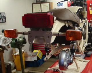

I also got the front forks back on along with the fender.
The tail lights are wired in and mounted too.

SaWeeeet! Love the fenders same color as the frame. Nice work!

That brown leather looks great with the ivory, you have quite an eye my friend.

beautiful...just beautiful!
please keep up the good work.
That corbin seat is really something!
am I the only guy that remembers the Corbin electric dragbike.. they built it back in the '80's

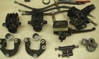

I did start on the brakes today. They were in fair shape but there was signs of leaking seals on a couple of the calipers.
Any good ideas on how to strip the old paint off? I'm thinking of painting them silver with some Duplicolor caliper paint.

This would be a good time to eliminate the front brake splitter. A double banjo bolt at the front master cylinder is all that is required, and a brake bleed becomes so much easier. If the paint is well attached, not sure you need to strip. Others have had good results with caliper paint, so that seems like a good plan.

ditto on the paint is REALLY hard to get off calipers. Another suggestion. I have found speed bleeders make bleeding the brakes a LOT easier
Re: 79 Resto Mod
#26
+1 on the speed bleeders!

Love the brown leather!

I use Tal Strip arasol paint stripper on parts. You can pick it up at O' Rilleys for $7.99. Stuff works really great but wear protective gear, its strong stuff.

Fred Camper wrote:This would be a good time to eliminate the front brake splitter. A double banjo bolt at the front master cylinder is all that is required, and a brake bleed becomes so much easier. If the paint is well attached, not sure you need to strip. Others have had good results with caliper paint, so that seems like a good plan.
I like the idea of eliminating the splitter. Do you have a source or part number for the double banjo bolt and measurments for how long the hoses should be?
