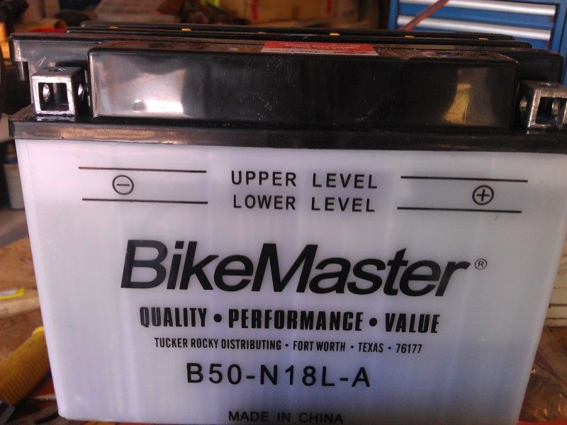

Got a little shopping done today...
I started to put the tank back in... that is a giant PITA! I am hooking everything back up so that I can crank it over per the Randakk instructions.
I didn't have a lot of time to play with it, and it is 106 here today so the garage is miserable. I hope to get some more stuff done tomorrow.

So, I got the battery in, and all of the fuses are good, but I have no power. I am going to figure that out, but in the mean time, I want to turn the engine over per the Randakk instructions. Anyone have a spare kickstarter for sale?
"If the women don't find you handsome, they should at least find you handy." -Red Green
"The cleaner the dipstick, the closer to God." -Rev. Horton Heat
76 CB550 Cafe bike
Posts: 7518
Re: New Member, 75 GL1000
#28
How about the dog bone fuse near the battery, is that good?

The dog bone fuse is fine. I get power all the way to the funny little box mounted next to the battery (don't know what it is).
