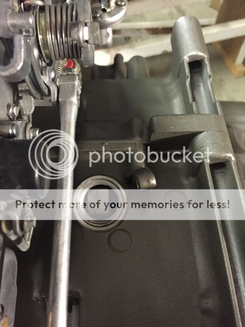

Ok...I need some help here guys! I changed my timing belts tonight and I've never done it before. Everything went well, but no matter what what I tried I could not get the left cam mark lined up perfectly once the tension was set. It's about a half tooth early when everything else is lined up. I did some research and see that others have had this issue as well and some people said its how t is and others said it can be fixed....I need some opinions. Here's how it looks:
Right side and T1 timing mark are bang on to my eyes
Am I missing something or is this ok? The motor is ready to go back in the frame and I want to get this right

You won't get any closer, as long as the camshaft pulley is indexed correctly on the camshaft's woodruff key, and its complementing timing belt is properly tensioned.
On my '75 GL1000, the left side camshaft pulley is perfectly aligned with its static timing mark, at the centered T1 mark in the timing hole.
But, the right side camshaft pulley is off 1/2 tooth from perfect alignment with its static timing mark, at the same centered T1 mark alignment.
Just the reverse of your respective engine camshaft pulleys' alignment . It is what is.

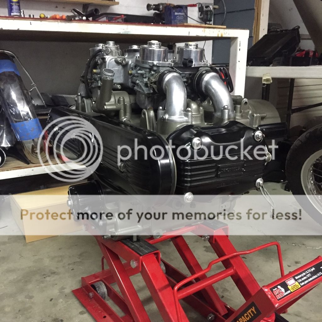

Motor full of fresh oil and all ready to go back in the frame

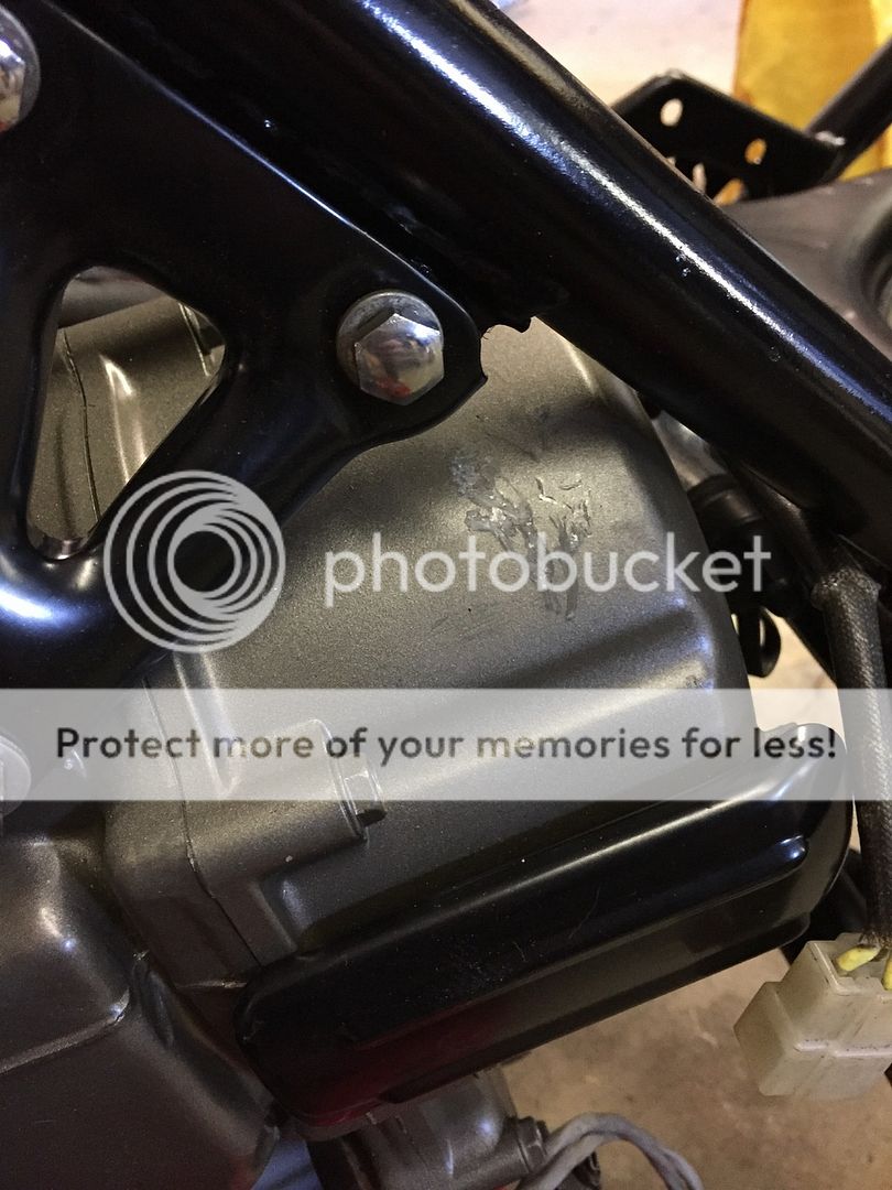

Managed to scratch the paint on the motor when I was wiggling it onto the shaft drive
ah well, will mask and re spray that area tomorrow
When they say to attach the neutral light wire before you mount the motor they really mean it! Terrible place for it and I learned the hard way.

I scratched my stator cover in exactly the same way (luckily mine was small enough to leave)
If I may make a suggestion - seeing as you are going to respray that scratch, maybe consider painting the fuel pump at the same time..sticks out a little IMO
That looks like a nice CX in the background too?
I thought about painting the fuel pump before but in the end I decided to leave it. It matches the color of the carb intakes, etc. I'm sure to have the only cafe gold wing where I live and the motor is really the most unique part of them, so I wanted it to stick out and draw attention. Good suggestion tho! Now I'll probably spend the next week looking at it and second guessing myself.

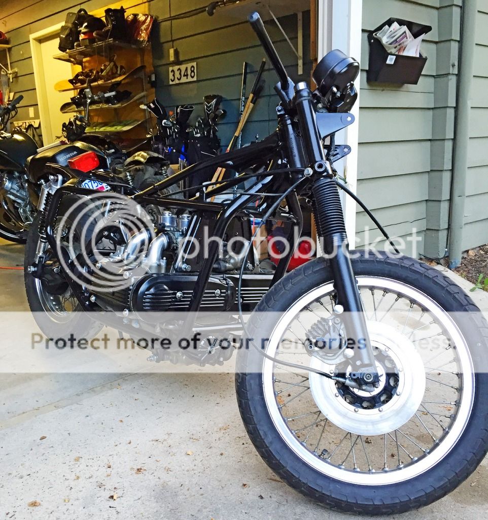

For the paint, I really like this (found on Instagram):
1975 Cafe Wing
http://www.ngwclub.com/forum/viewtopic.php?f=16&t=56574
- wingrider
- Posts: 3837
Re: My 75 Wing Cafe RestoMod
Bet that tank really pops in the sun!

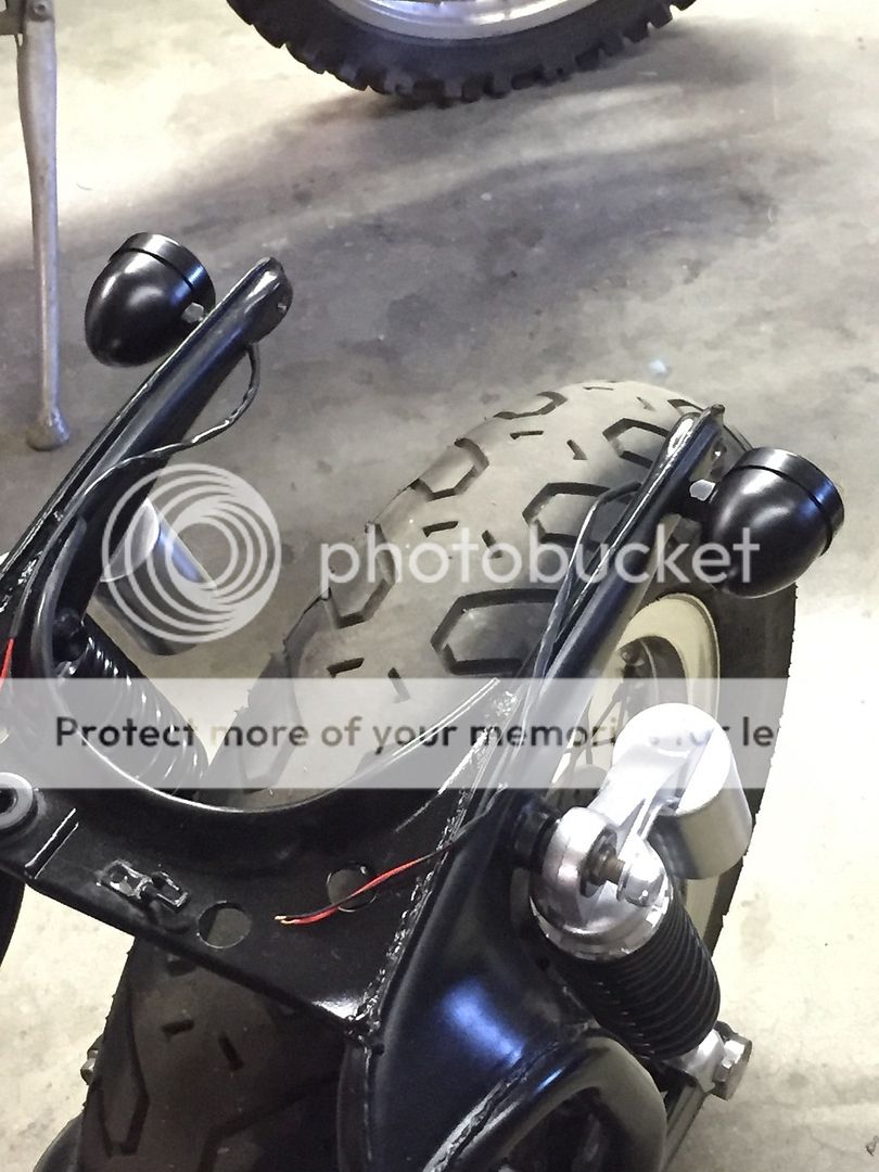

Not too much progress over the weekend as I was at a wedding. Today I received my new Dyna coils and my signal lights. I've set aside Saturday to get the wiring all put back in and hopefully see if she starts. This evening I figured out the signals and got them mounted. I'm pretty happy with the results.
