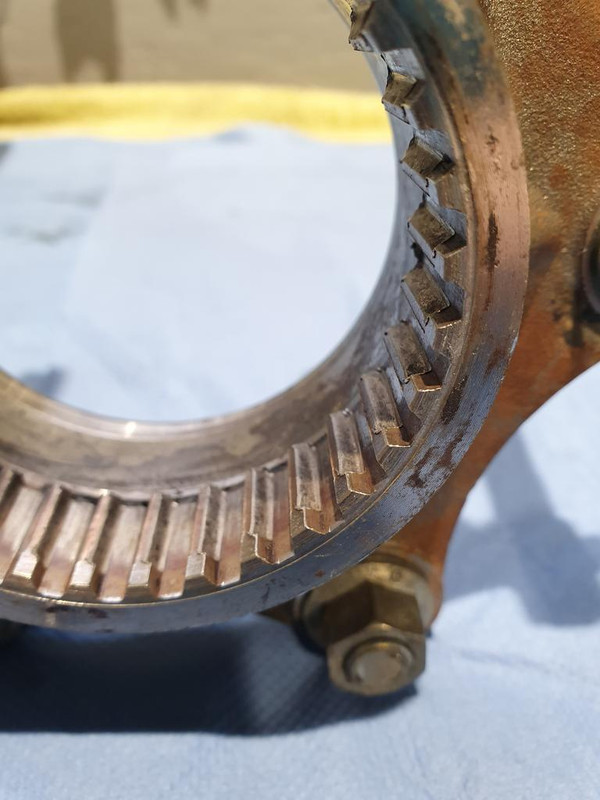

Today i cleaned the rear hub and discovered that the driven flange is worn out. So i need to find a new one.
do they even sell those?

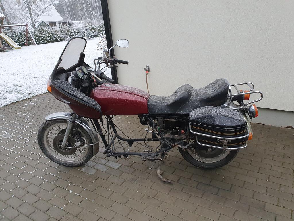

Yesterday i brought home my second GL1000. Its without an engine but it has the rest of the parts i need- forks, speedometer, brakes, origimal muffler, radiator, wheels are in much better condition.
Motivation is high to continiue with the project now.
Fun fact is that there are only two GL1000 officially registered in my country and now i own them both. This gives you the idea how hard is to find parts here for the GL1000
Parts bike:
The Vetter, seat and luggage racks n cases i will sell or trade if anybody is interested
And my happy place at the moment.
The GL 1100 is waiting for belts and carbs rebuild kit and then it will roll out to another garage to wait for the spring.
Parts bike:

Looks like projects to keep you busy and have a lot of fun! Make sure you lubricate the flange splines with very high moly content lubricant, and while things are apart, do the same to the slip joint splined coupling just in front of the rear hub. There should be a grease fitting on topm but pulling it apart, cleaning, and careful lubrication is better when this far.
