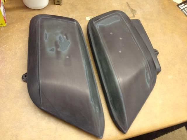

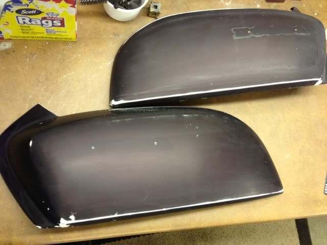

I did start working on the covers. I managed to get them sanded and got the pin stripes off. Got to hand it to Honda for getting them on there really really good. Took a ton of sanding to get them off. Painting is not my strong suit but I've decided to give it a try. I'm sure I will be back here asking for advice on how to make them look good.
The PO had glued the emblems on some of the covers, that took a bit of sanding to get down too!

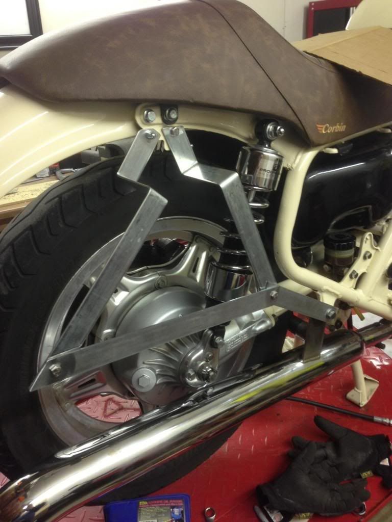

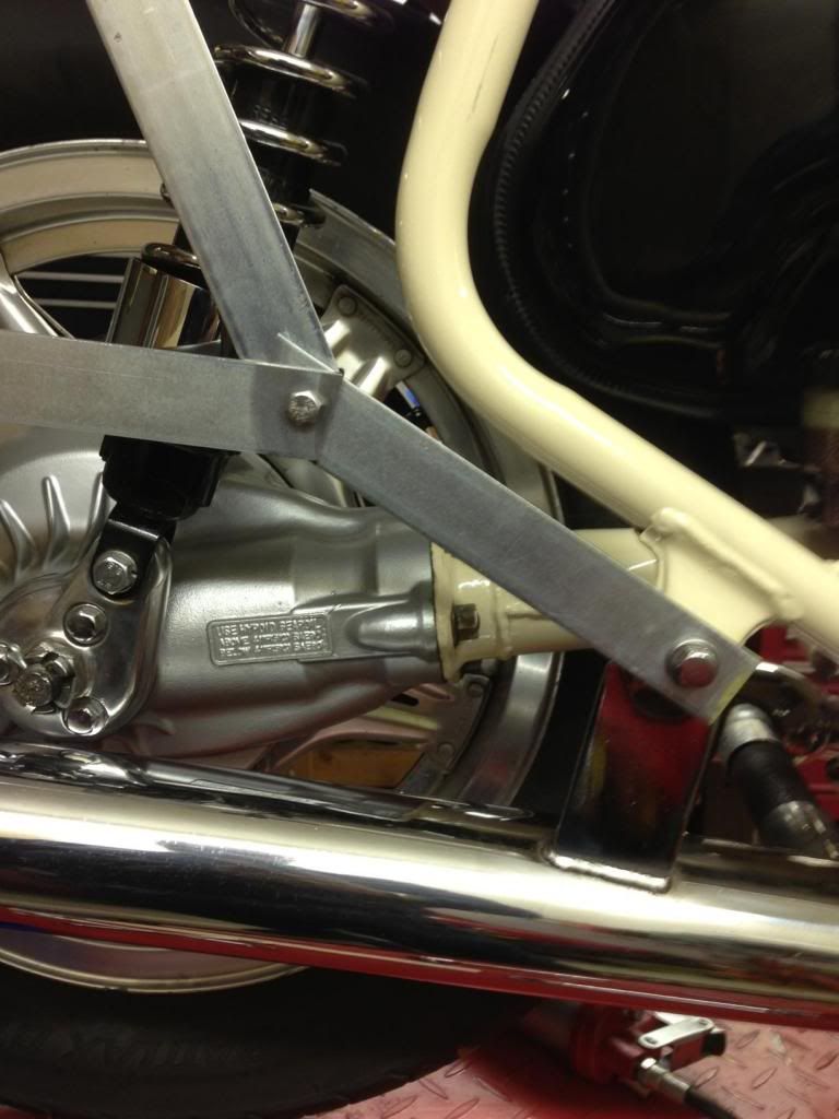

I got the new heads and the exhaust back on the bike this weekend. I wanted to get the exhaust back on so I can start working on a mounting system for my saddlebags. I went into the shop tonight with an idea and this is what I put together.
My plan is to use this as a pattern and take it to a fab shop to have a solid one piece frame made out of 3/16 steel. I'll have that powdercoated.
I tried to match the angle of the frame with the rack

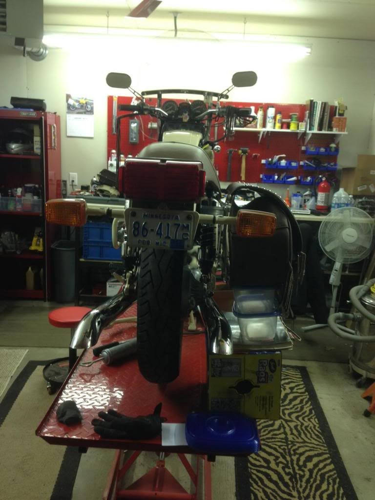

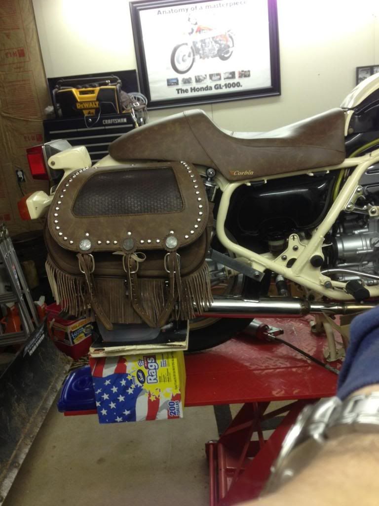

The bags should sit about here when it's all done.
Here's a rear view. They sit out a bit but it's as close as I can get them.
Keep in mind that this is only the prototype. It seems fairly solid as it is but I want the final version to be really solid with very little wiggle at the back end.
Any suggestions would be welcome.

to take the wiggle out of the back end it really has to be attached to something. HD touring bikes do this to the rear fender (which comes low in the back). Vetter bags do this with a cross over to the other side

That bag looks great with the color of the bike.
