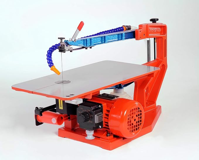

Hello Wingman,
I used a scroll saw (hope that's the correct name in english)
heres a picture: Image
but you need a lot of jigsaw blades :-)
it's funny to work with such a saw. you can do a lot of nice things, whether useful or not.
And a emblem for my Wing :guitar
