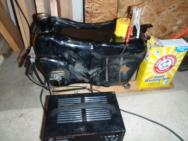

I decided to tackle the gas tank tonight. I used a hose the other day to get as much rust out of the tank as possible. It was still rusty, but I did not think it was too bad. I put the Mr. Wizard deoxidation contraption to work.

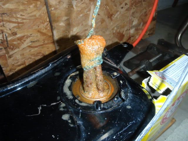

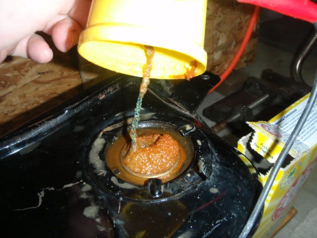

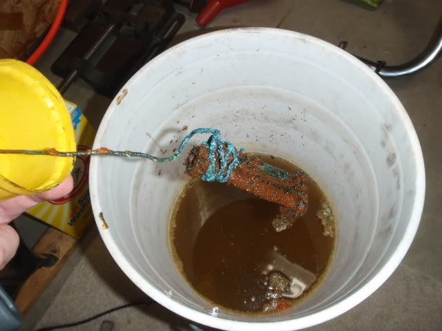

The charger worked like mad for about a half hour, then very little was going on. In the past this meant that my sacrifice piece was coated, so I checked. Here is what I found.
Yuuuuuuuuuck! I have been cleaning the bolts in the solution about every hour. I guess I'll just keep doing it as long as the rust keeps appearing.

Are you running the derusting rig indoors? Be careful, that does produce hydrogen as it works. Should be done outside or in a very well ventilated area.
Re: melloyellow to live again!
#41
Robin, I am now officially paranoid every time I see one of your posts! I did think about the hydrogen but after a quick search did not think it posed any threat. Anyway, I have since flushed out the tank, and refilled it on an angle so that the part that was empty is now under water. I have also moved the operation to the garage! The tank really looks good inside. Now I will have to decide whether to coat it and if so, what to use. I have time to think about that and do some more research. By the way, that charger is a variable one. It can be set at 10 amps or 2 for trickle charges.

Electrolysis is line of sight. Move the anode to the sending unit hole for a while. It took me 18 hours on the charger to get it clean. I didn't coat it and it still looks like new.
Another tip is to connect a 24" piece of 1/4" or 3/8" copper tubing to a garden hose. Stick a utility knife blade in the end of the tubing and smash the tubing over the blade. It makes a good flexible power washer for the nooks and crannys.
Sometimes paranoia is a good thing. I had two small explosions when I was cleaning my tank. I figured out that the rusty bubbles had soaked the piece of wood I was using as an insulator and there was an arc to the fuel fill hole that ignited the hydrogen. I didn't completely cover the hole after that I tell ya.
