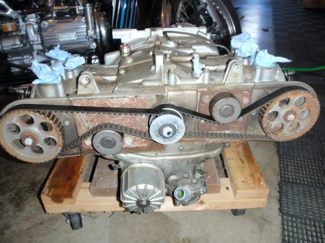

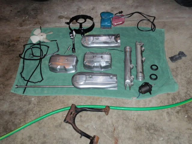

Barb, Great to have you along. I was working most of the morning on the bike. I got the muffler and headers apart. Both ends of the muffler will need to be repaired. One of the headers is thin and has a small hole at the connection end. Could a smaller sleeve be welded inside without affecting performance or will I need to find another set of headers? I got the bearing races out of the frame and off the triple tree. All looks good. I took apart the brake system and I think it can all be rebuilt without too much trouble. I got the seals out of the front forks. I worked a bit on the valve covers, and they will turn out great. Lots of work ahead. I have been cleaning all of the little parts and putting then in marked baggies. Here are some pictures of the bike as it sits.

Looks like rust on those valve spring retainers. Did the engine sit without the valve covers on? I would look things over very carefully inside the engine. As much as you can from the outside anyway.

Robin, I took a close look at the valve cover area. Those marks which appear to be rust are grease/oil stains. They wiped right off. I have managed to get 3 of the brake pistons out. One came out by air (glad it wasn't pointed at anyone!) and two came out with grease. One is being very stubborn. The pressure with the grease gun gets so great that the grease comes out the gun fitting instead. Any suggestions? Heat? soaking? Help!

Don't soak it in any penetrant, ie; PB-Blaster or such. That makes the rubber swell and makes it even harder to get them out. Some heat may work. You could even try putting them in boiling water for a few minutes. I have had some that were so bad though that I had to sacrifice the piston. I grabbed it with pliers and just gorilla'd it out. Do that as a last resort though. You can get new pistons, thats why I wasn't too worried about doing it.polkadot77 wrote:Robin, I took a close look at the valve cover area. Those marks which appear to be rust are grease/oil stains. They wiped right off. I have managed to get 3 of the brake pistons out. One came out by air (glad it wasn't pointed at anyone!) and two came out with grease. One is being very stubborn. The pressure with the grease gun gets so great that the grease comes out the gun fitting instead. Any suggestions? Heat? soaking? Help!
