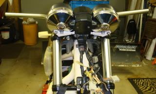

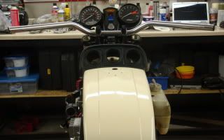

I received the GP Touring bars in today and threw them on the bike for a quick try. At first look they seemed just like the Euro bars but with more pull back. I do like them a little better than the Euros. I sit a little straighter without being up too far.

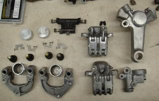

I gave striping the brake calipers a try, what a PITA. Mother Honda really put that caliper paint on thick. I did manage to get most of it off but the calipers will need a little sanding before painting.

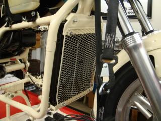

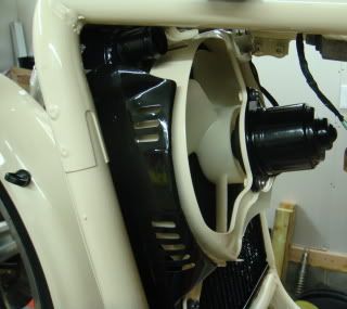

I had the radiator cleaned, pressure tested and painted at a local shop. It looked so good I put it on the frame to see how it looked with the powdercoated parts.
More to come!

You may want to have the brake parts powder coated also. The paint came off so hard because it was designed to be safe from brake fluid. Regular paint isn't too good with brake fluid.

Keep in mind that the lower and less pull back the bar has, then the higher the weight on the handlebar. Kind of counter intuitive, but less weight on your seat with lower handlebars. This is most noticeable in road biking where the neck can become uncomfortable for some but not too often do folks complain about the back. I am no doctor, and preference is a big deal. Looks like the touring bars will work out good.Pokegama wrote:Fred, I agree about the bar height. The Euros feel like they drop me into a cafe racer kind of position. I like the look and like I said it's not uncomfortable but I think for me it would put too much strain on my back over a long ride.![]()
Are you going to slot the bar for internal wires? I did mine today and it was not a big deal. There is a thread in the Tech section where I got advice then posted pictures.
Boy, the bike is sure looking sweet. Love the way it is coming together.

My original bars were not sloted and the controls all seem to be set up to have the wire outside the bars.
