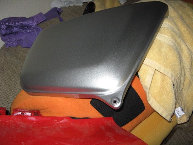

What sort of paint did you use? Acrylic laquer or 2 pac?

That HOK Candy Apple Red is gorgeous.

Thanks guys...
Regarding the paint, I had a professional apply it and I think it is a urethane enamel...I watched him mix everything up on the bench but I couldn't tell you what he was doing with all the catalysts/reducers, etc...it's all black magic to me
I ended up choosing HOK which is VERY PRICEY, but the quality is top notch and my painter loved working with it (and when the painter is happy, the finished job is that much better). Even so, it was very time and energy consuming to say the least even with me doing the initial prep sanding...he started with primer/sealer then several base coats of silver metallic followed up by several coats (4 if I remember correctly) of the red candy till we got just the right depth. Then three coats of clear over everything with all the associated wet sanding and final polishing.
The number of final color coats is all a matter of preference, because inside the shop it looked dark red, but when we took it out into the sun, it just GLOWED a BRILLIANT orange/red/metallic. The pics don't do it justice.

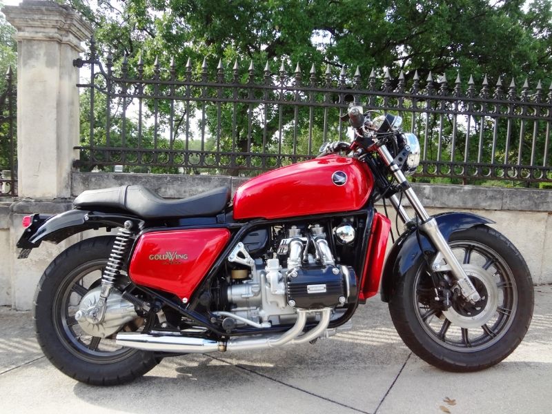

Here's a couple of pics with the painted wheels and all the cosmetics sorted.

Lookin' very nice! Is that a sportster seat?

Yup, it's a Sportster seat.
I had to trim some of the plastic ribs on the bottom to fit the top standing seam of the GL tank.

Very cool! Paint is awesome! What year/model Sportster does the seat fit?Motowalt wrote:Thanks guys,

Many of the Sportster seats would work, including the solo seat. I was told this one was from an 04-05 model if I remember correctly.
I found this one by riding my 76 to a local Harley swap meet...(rolling into the meet riding on a rolled up towel was a good way to break the ice..."hey, does your wife know what you're doing with that bath towel?"
Several sellers had a good selection of used stock and aftermarket seats lying on the ground. I just tried fitting several until I found one I liked.
