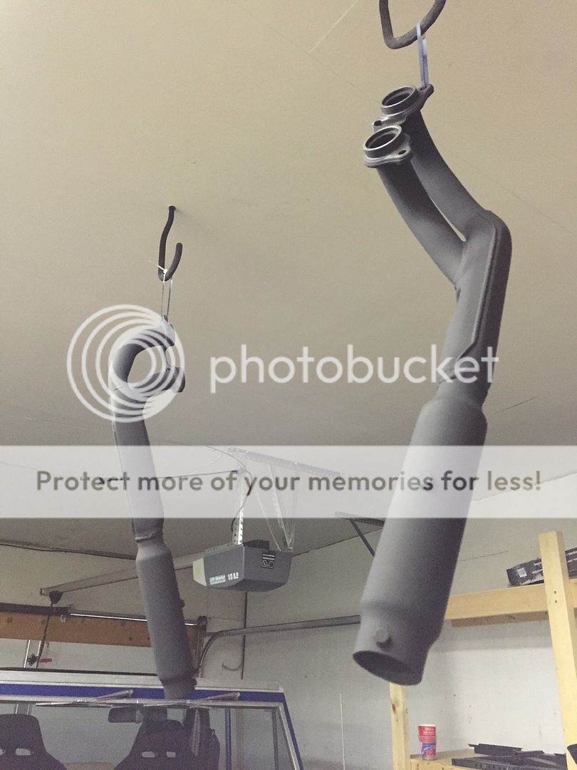

I got my exhaust back from the muffler guy and I'm not sure if it was my mistake or his, but the pipes were welded on rotated 90 degrees off.
It was done as a favour to me so I don't want to complain and I'm afraid cutting them off and turning them to re weld might ruin the muffler. I wasn't planning on using the mounting bracket anyway so I'll probably just cut the bolt off then give the whole thing a few coats of black high temp header paint. I'm also not sure that I love how they look...i had them shorten the headers and the muffler as much as possible but I really think they'd look better with a shorter muffler in a larger diameter. Something like this...
I've got two other sets of spare headers so I can always swap something else in later down the road if they don't turn out to my liking. I tried one of them on the CX500 and it had a surprisingly good exhaust note for how tiny they are. Not too loud at idle but gave it a nice bark at full throttle.

Great progress.
How about a larger diameter pipe over the muffler or a curved heat shield to give it a more meaty appearance?
There is a nice bolt on top there you can mount it onto.....

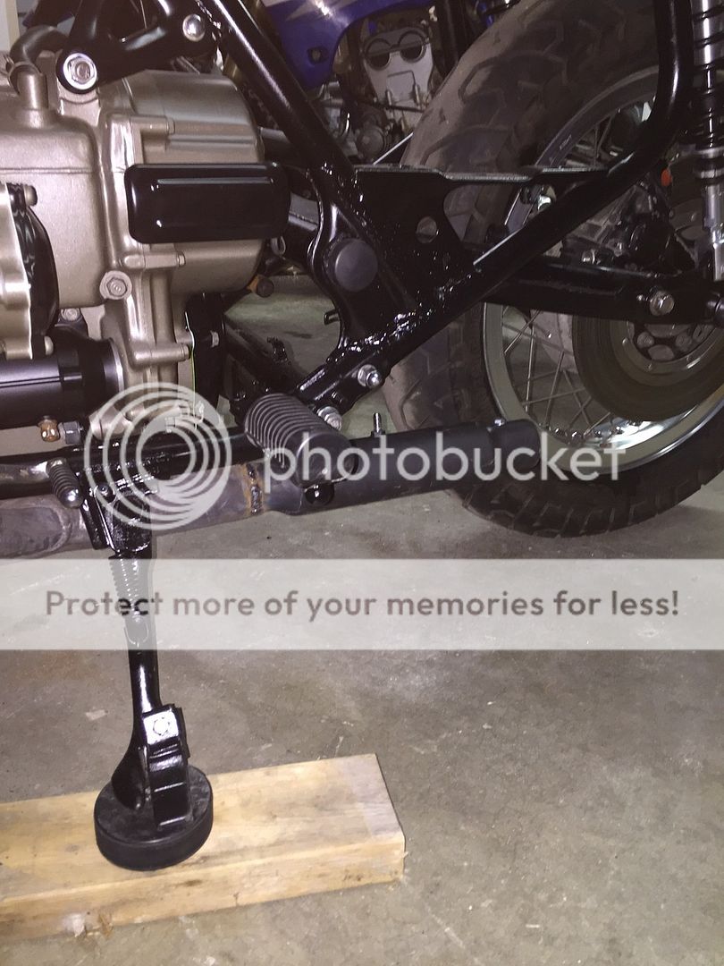

The heat shield on the pipe is a great idea, never even thought of that. I'm going to keep that in mind for sure.
I ended up ordering a full set of custom length braided stainless steel brake lines (including a one piece rear line) from a company out in Ontario that I'd heard good things about. They should be here today or tomorrow.

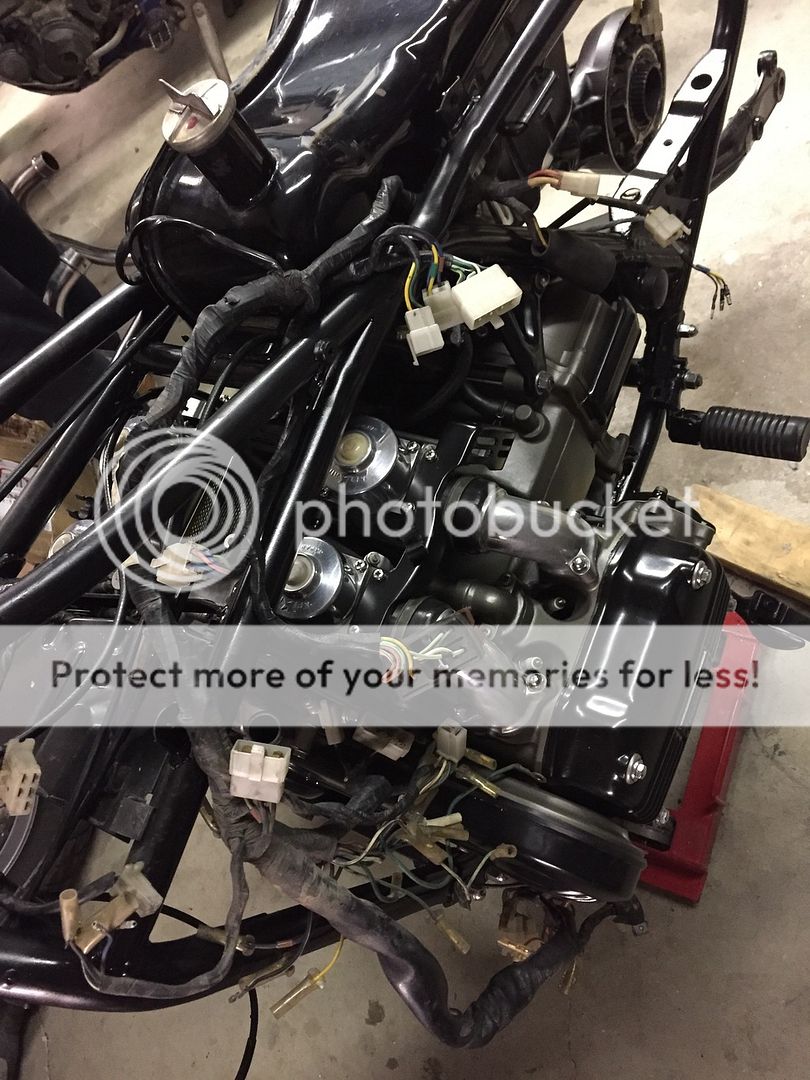

Meanwhile...
Got the tank back in and now I'm working on remembering where all these wires and cables get routed. Should have taken some pics as I was tearing it down but I think I've got it figured out. Won't be too much longer until I can hold my breath and hit that starter button
Meanwhile...

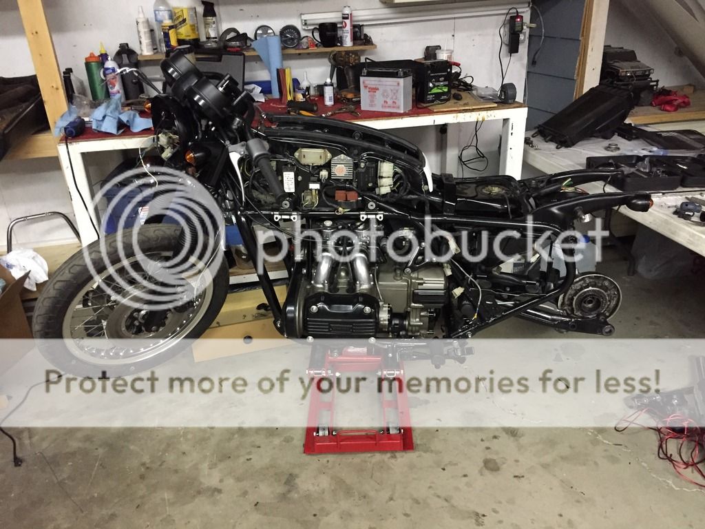

Shortened some cables
Painted my exhaust
installed the new coils, brake lines and got 90% of the wiring done
Couple more days and it should be all assembled and ready to start. Then I can focus on the body work
Painted my exhaust
