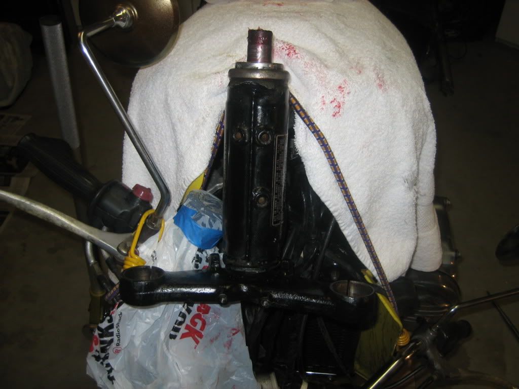

So I got the bearing off with two screw drivers under it and a pry bar.
- Cookie
- Posts: 15821
- RIP: 1950-2011
- Location: San Mateo, CA
Re: So this guy walks into a chat room
I had to remove the rubber seal and go with an O ring for enough clearance. Now the neck feels pretty good.

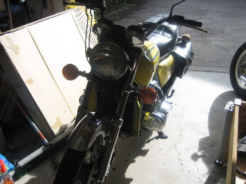

This one is almost done for the summer when the new hoses come from Frenchy. I decided to go stock rubber cover since the bike is so stock.
The test run went very well except for a slight drizzle, I would have liked to give her 50 miles before a final tightening up but with the rain I'll wait.
No noise anywhere and those new neck bearings are very smooth, everything works well.

So that's about it for a while on this bike. She just did 50 miles and had every bolt checked. She now has the little rubber covers back over the bolts. I polished up the front end to remove all the hand marks I put on while installing parts. See how nice Sunbob's fork legs came out with a Semichrome job.
