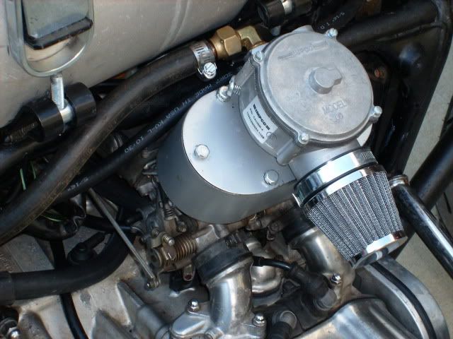

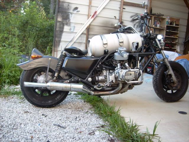

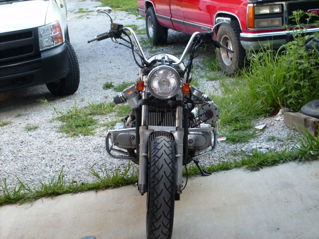

Here is a closer pic of my carb setup.
The rest is just some around the bike pics and my rear fender. I always try to use what i have laying around so some added sheet metal and some cab lights for blinkers and an el-cheapo tial light and I have a quick fender fix. I have removed my front fender to paint it black. I don't know if I'll put it back, kinda like it like it is. I wonder if its a law to have one?
