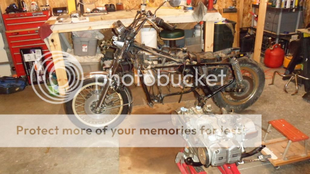

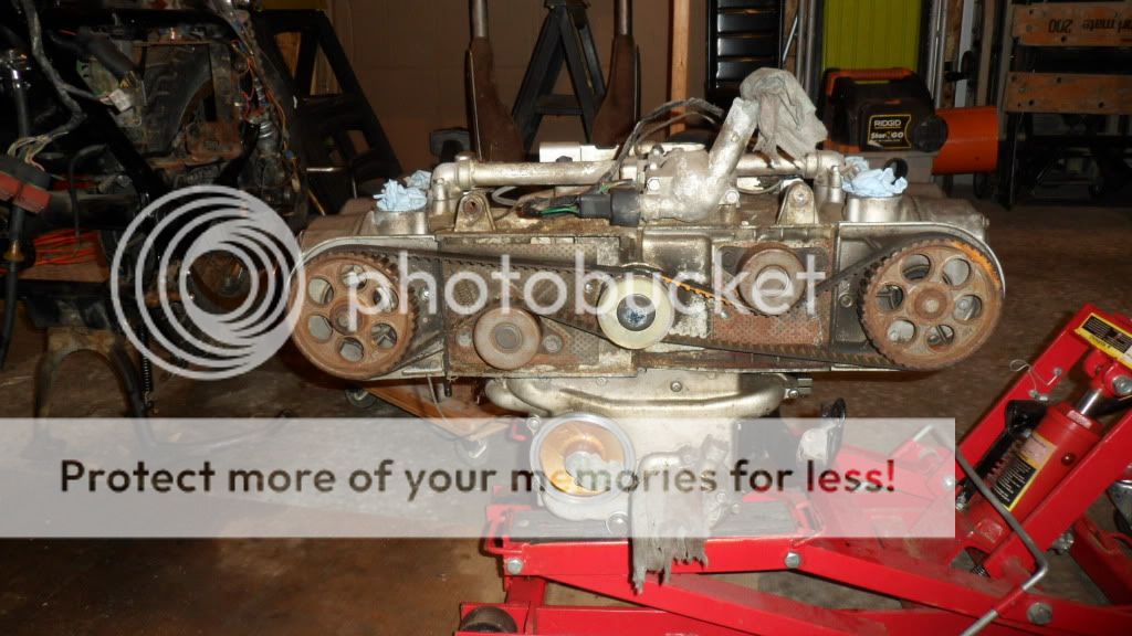

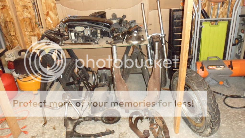

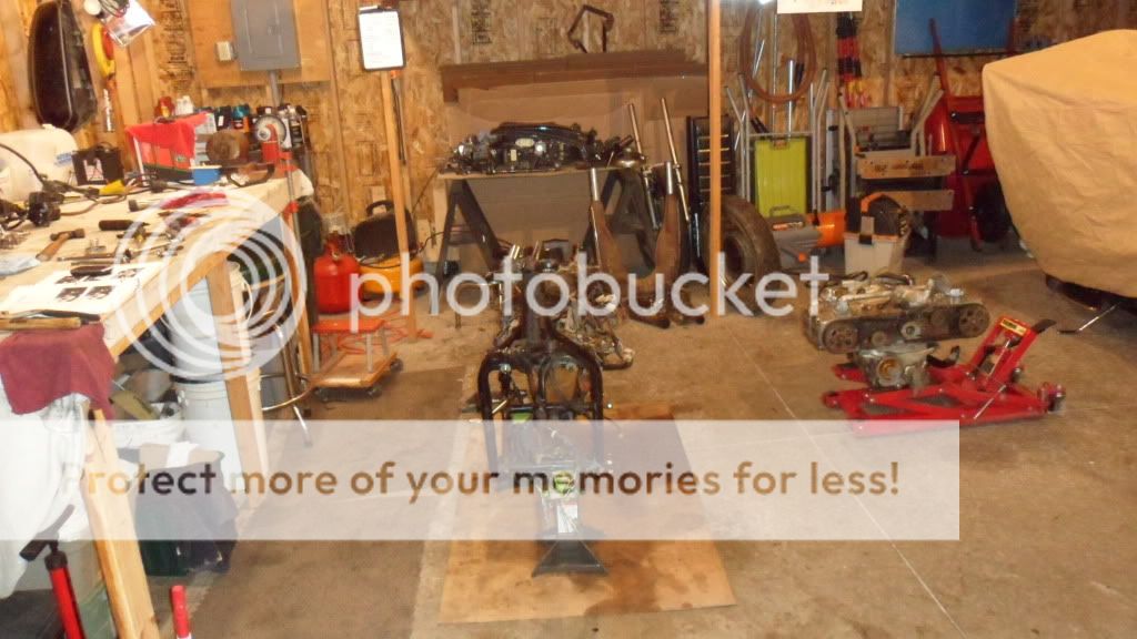

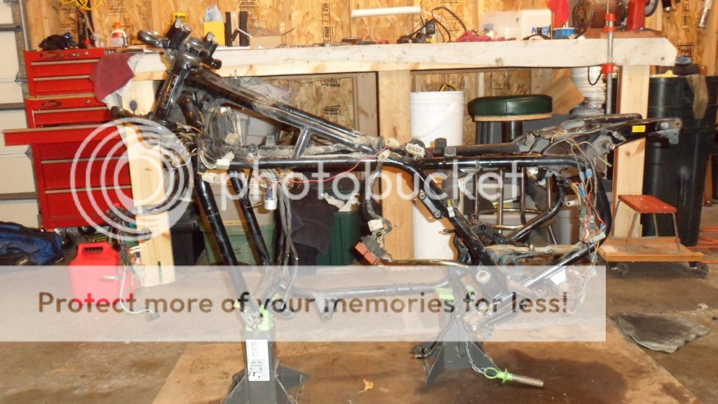

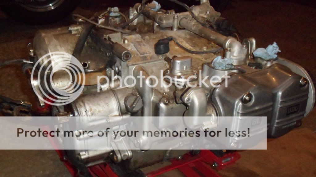

Anyway, so now that I now the engine runs and runs decently well I started to disassemble everything. Almost an entire can of PB Blaster later and its mostly apart.
I'm going to start by cleaning up and painting the frame and that way I can clean/paint/rebuild parts and reassemble the bike.
Here are a couple of progress pictures.

Down to the bare basics. Are you going to repaint the frame or have it powder coated?

I'm just planning on painting the frame.

I like painted frames too. I use a catalysed black which to me seems to be shinier than the PC I've seen.
It's definitely more difficult though.

I've used a two part PPG urethane gloss black paint with success. The key is to use the right primer paint as the base coat. I've never powder coated a frame before but I'm thinking about it for a Honda CL200 I have sitting out back under a tarp. I know that the powder coat holds up to quite a bit of abuse. When i worked in the amusement park industry we powdered coated the ride queue rails and never had problem with chipping paint.

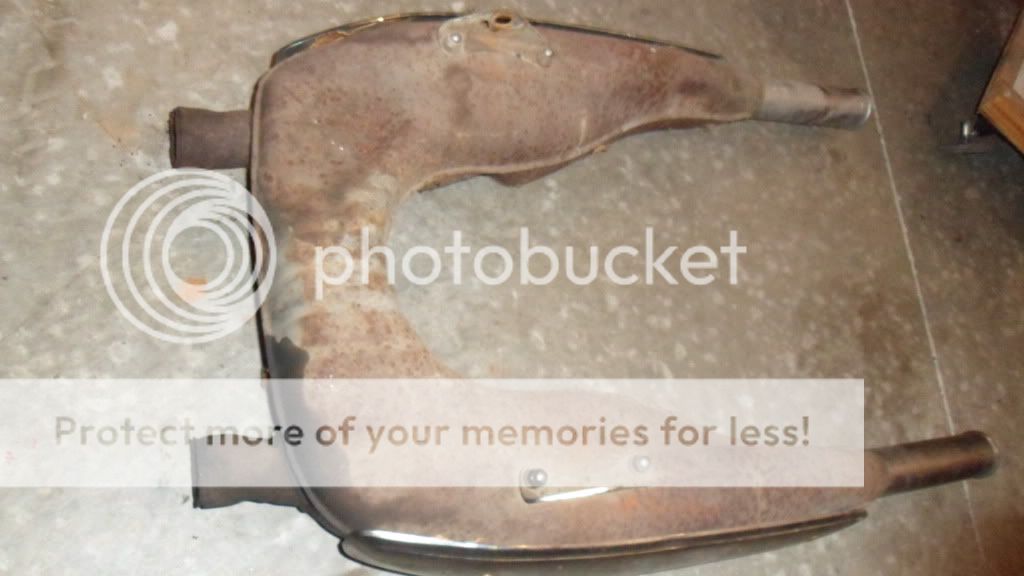

- Posts: 7534
Re: 1976 GL1000 LTD
Those look like they may be 1100 headers, but that is certainly a early GL1000 muffler. Unless LTD's did not have cast headers like the rest of the early wings? Either way, they should function well.

Could the original headers on the LTD be stainless?

The headers on my LTD are not stainless. They are just like the headers on my '75 Blue-green and '76 yellow.
