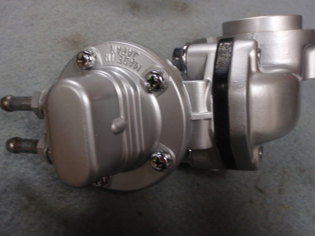

I also worked on cleaning the brake system. This time I had no trouble finding the mysterious "tiny hole" in the master cylinders. In part that was thanks to my new brake rebuild tool.
Yes they may look like short pieces of wire, but do not be fooled. (Patent pending) By the way, the strands in 14 gauge wire are too large for the hole as is two 18 gauge strands twisted together.

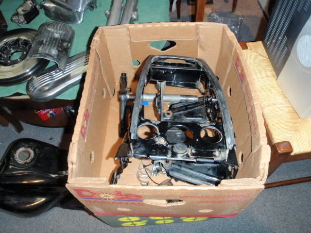

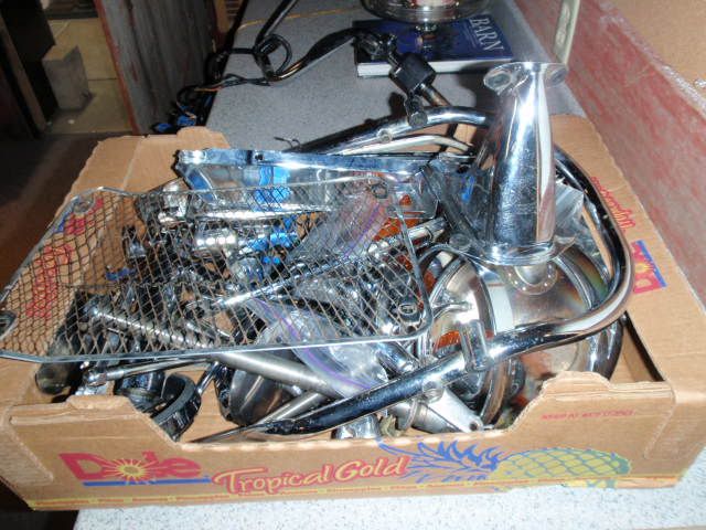

Here is my stash of new and used parts, and others waiting at the Dreaded Wire Wheel station.
And my first part cleaned at the wheel.
More when I actually accomplish something.

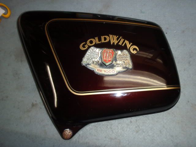

It was a good day today. I got the title registered in my name and I received the LTD side emblem and missing tools from the set. I still need the left side panel and seat. If anyone out there has a nice 77 seat , I have a very nice 78/79 seat to trade. I have been working on the brake system. I have the calipers and MC's cleaned and ready for their rebuild. I am still waiting for some of the parts. I was wondering what the red dots on the parts signify. Does anyone know? Thanks

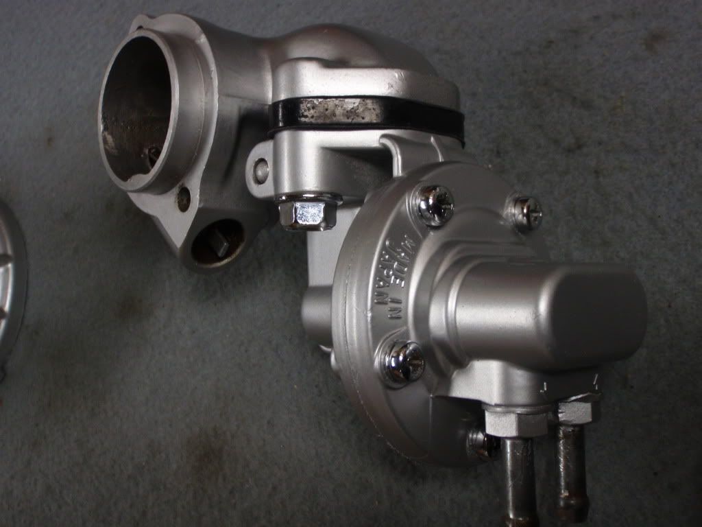

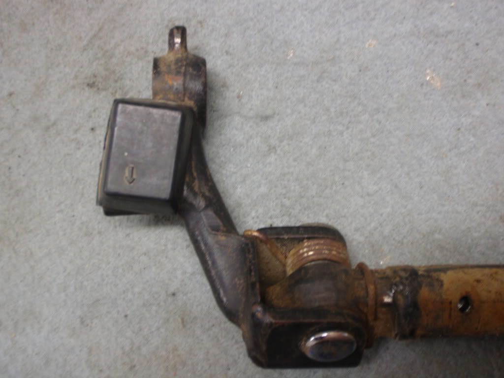

As noted earlier, I have basically been cleaning and using the wire wheel. Visibly, about the only progress is moving parts from the "to-do" box to the "ready to polish" box.

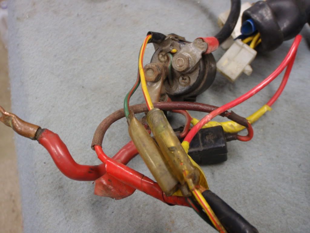

I worked a bit on the starter solenoid. One of the POs had done some rewiring to add a modern 30 amp fuse. In doing so they eliminated one of the plastic connectors. I put in a new 30 amp fuse holder and rewired and soldered everything in. The original dog bone fuse was in good shape, so I will keep it in place, but it will not be in use.

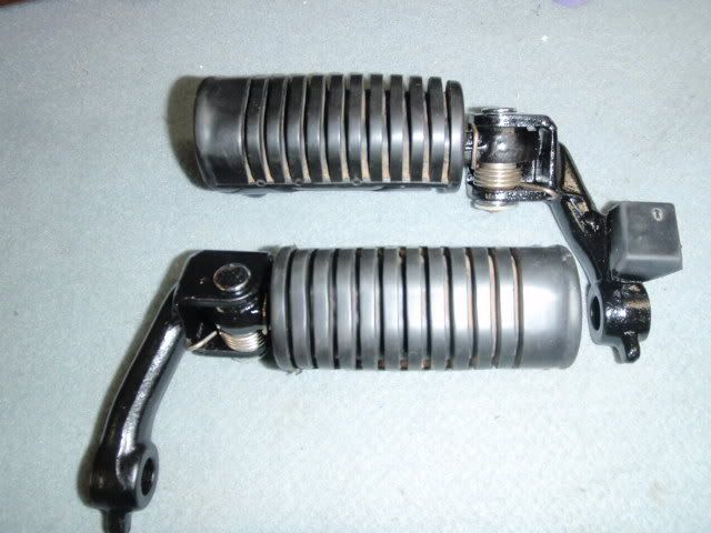

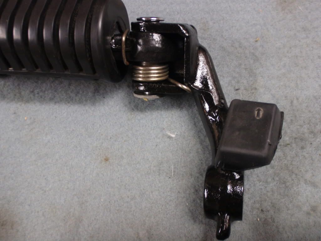

I forgot to take an "after" picture. I really wanted to SEE some progress, and I had some of the smaller add-on parts ready for paint, so yesterday I painted some of the parts. I put some of them back together and here are some PROGRESS pictures:

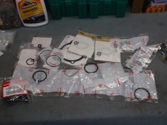

For those of you thinking that I forgot about my project while hunting, WRONG! While gone I received parts for the project from hondapartsline including mostly washers,gaskets and brake rebuild parts.

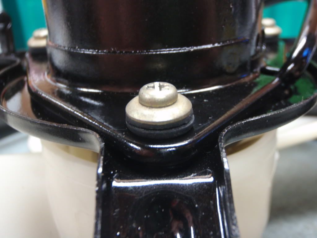

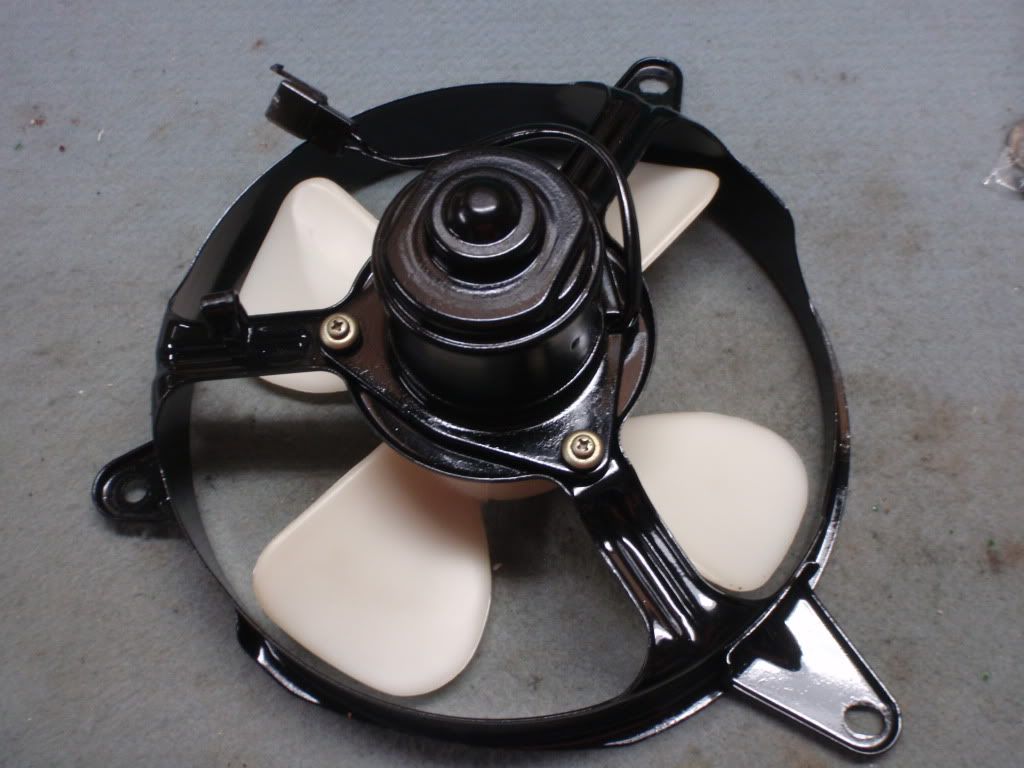

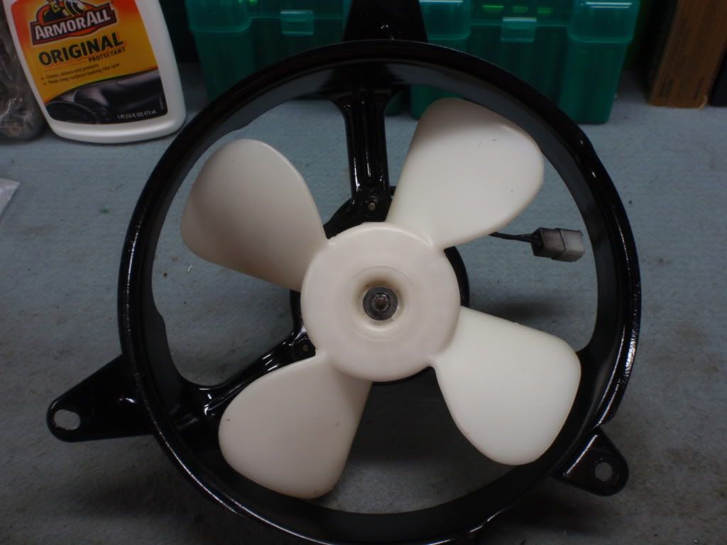

I needed new rubber grommets for the fan and was going to order them from mother Honda as they were available. At the price of 6.56 each for those tiny grommets, I just could not pull the trigger. Local hardware had the same thing at 28 cents each. Here is the finished product.

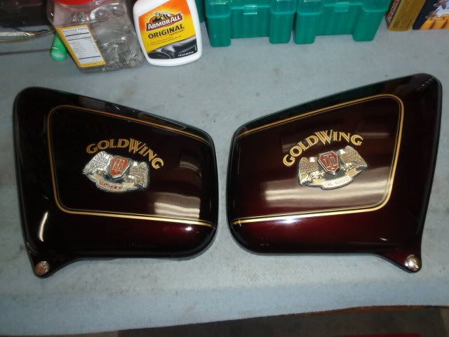

Oh, and by the way, I found the LTD Holy Grail! I now have a matched set of side covers!!!!!!

LOL my radiator vin needs those gromets too, will find something like you did
