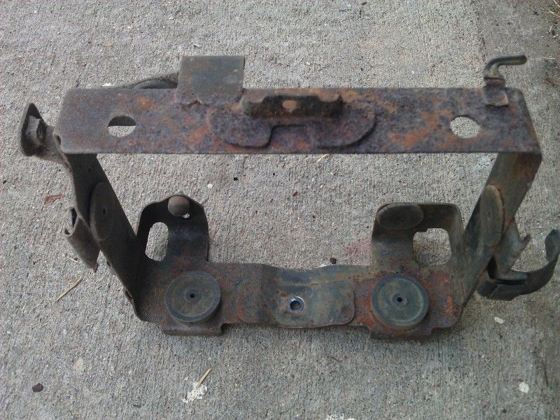

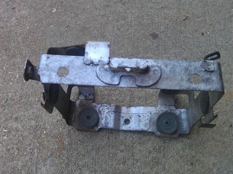

So I have started playing around with the sand blaster today. I had to get new media. I bought coarse walnut thinking that it would be good and it sucks. I bought #8 glass beads and what a difference!
This was after just a few minutes. I am removing the rubber things before I finish up and paint it.
