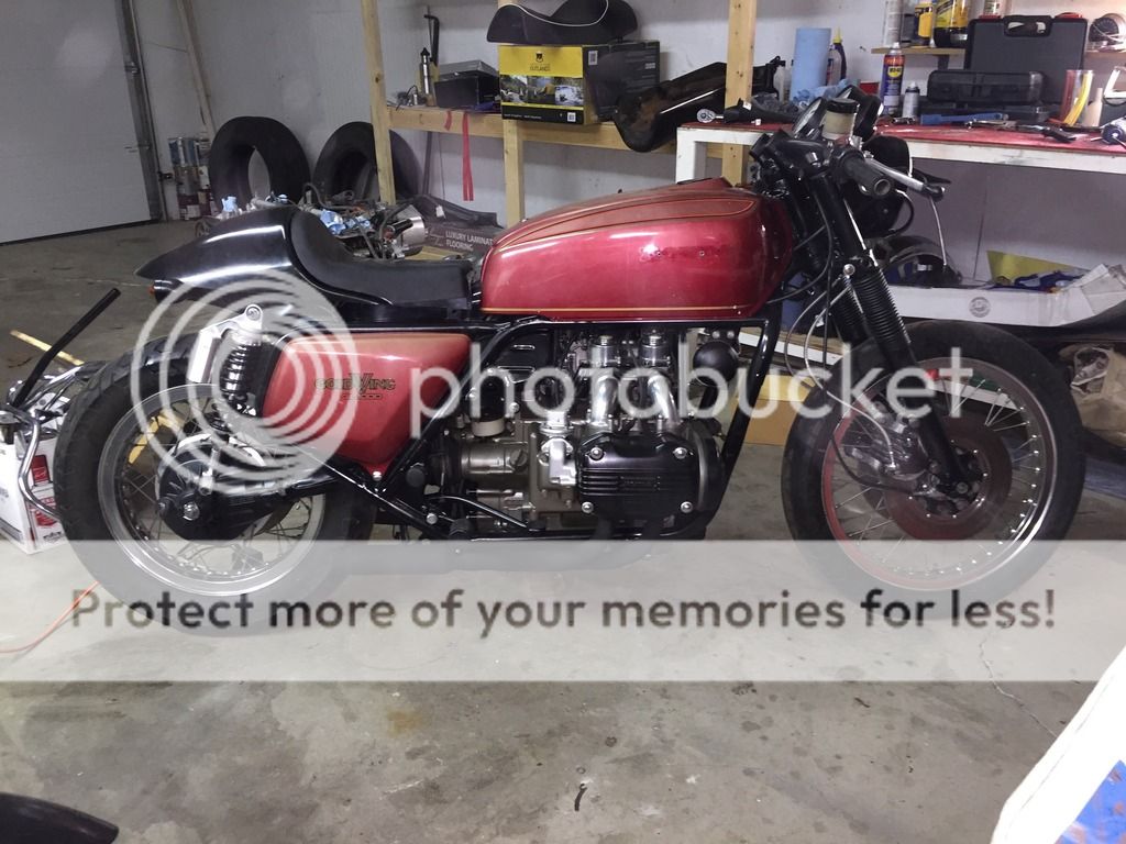

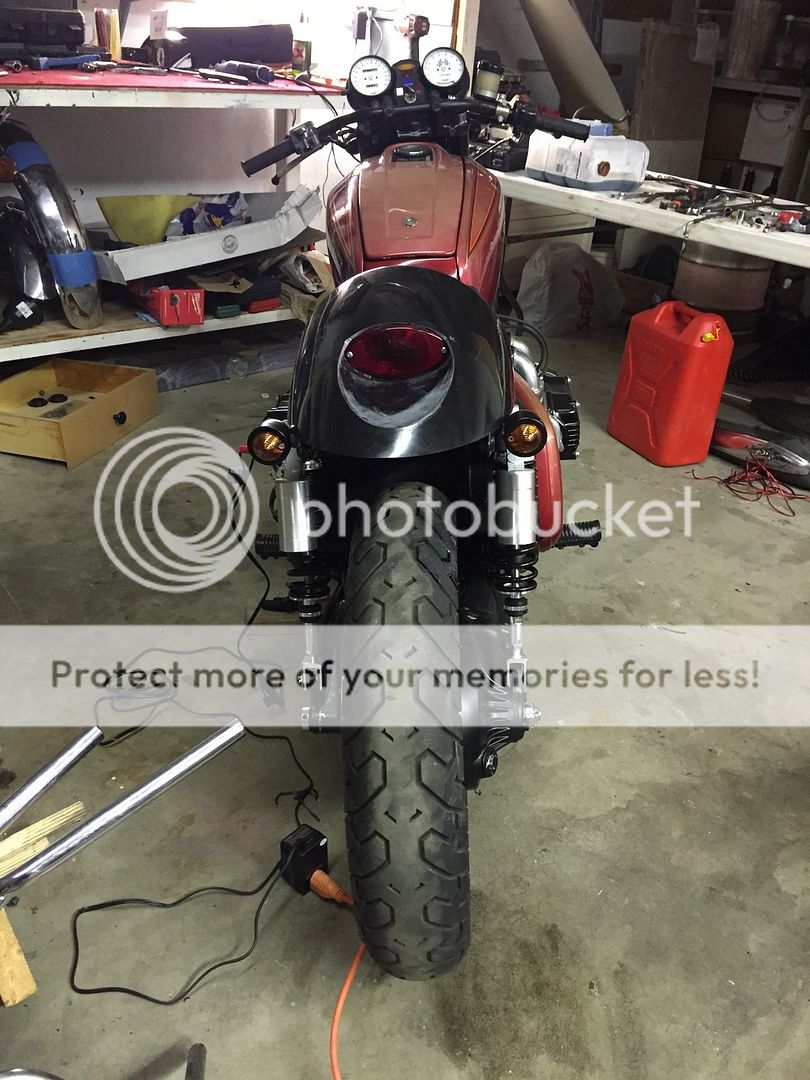

Hanslehoff wrote:I thought I'd be able to turn her over tonight but as I was topping up the coolant I noticed a puddle forming on the garage floor. Leaky thermostat :( Drained the coolant and pulled the rad and thermostat. Oring was pooched so I'll have to order another one tomorrow and wait till it gets her before I can try starting her up. I did get some other things done. Got the throttle cable shortened and hooked up and put the exhaust on. Fitted the tins and started working on where I want the seat cowl mounted. I'm liking the stance so far
But I think I need to move the rear signals forward towards the shocks and possibly chop the rear sub frame. Still needs some more thought and work.

Norbert R wrote:Very nice lines !
Just my 2c, but IMO the rear "horns" on the GL are quite difficult to chop and make look good, unlike the tubular frames of most bikes that you can chop and hoop, the rear arms on the GL to me always look a bit butchered, like a Rhino with it's horn cut off ;)
Once you have cut them shorter, then you have this blunt stump that you can't really intergrate into anything.
Have you decided where you want your license plate ? Again, just some unsolicited advice, but consider putting it behind your tail section - it'll keep a lot of water off your back for one (trust me :roll: ) and can look really nice with a thin LED strip that can have your running/brake and turn signals all in one.
If I cut a couple inches off the "horns" than the rear cowl will drop down over them and they would be completely covered. The tail light is frenched into the rear cowl and I have a license plate bracket with LED bolts that will be mounted off the back.
I do really like those all in one LED strips but they aren't legal where I live.
rich3389 wrote:What kind of rear shocks are those?
They are TEC brand made for a CB900
olchris wrote:Those shockies look like there probably 14-15" eye to eye.. Standard is 13"ish i think... Seems to be very high, rear wheel to guard ratio.. Is that the "cafe" look that your after???...
Yes, the shocks are 14.5" eye to eye as they are made for a CB900. That is the look I'm going for as I find the rear end looks like it's squatting down with the stock shock length. I did a lot of research before I ordered them and as far as I know there won't be any issues with running them. I can also shorten them nearly an inch if need be. I also dropped the front forks down 3/4" in the triple clamps to make the lines of the frame parallel with the ground.
Thanks for the kind words everyone!

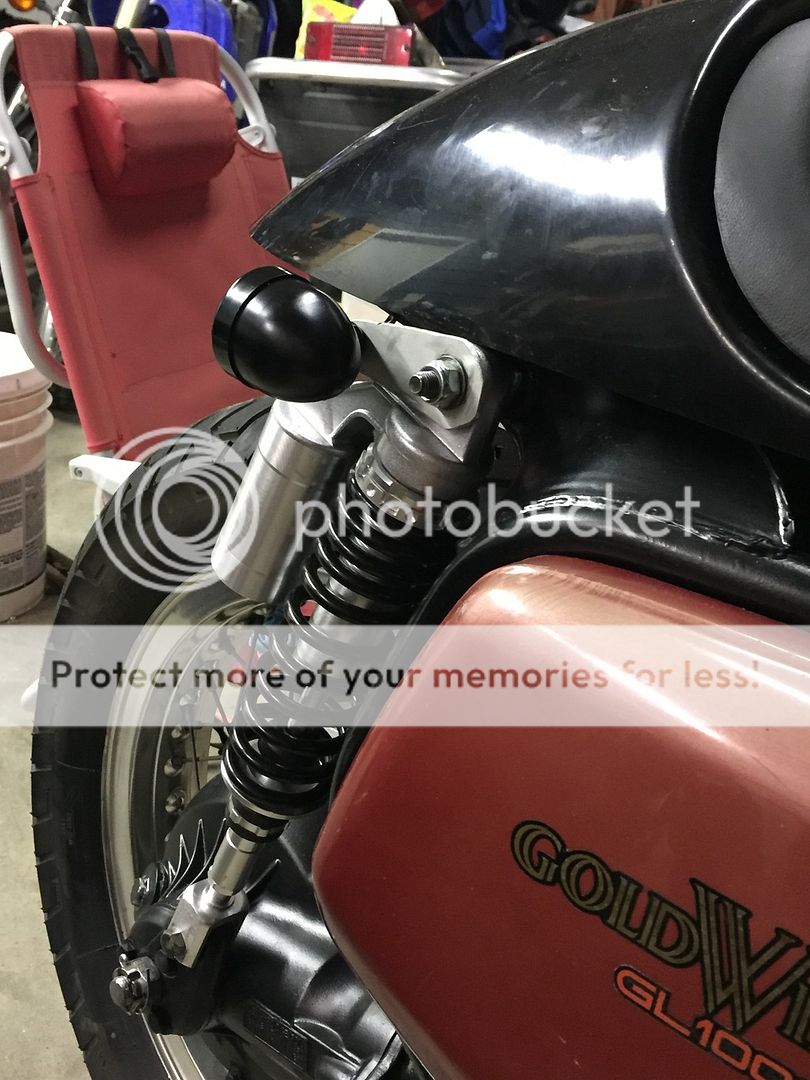

Chopped about 3" off the back off my frame tonight and I think it was the right choice. The tail section sits right over top and covers the frame completely and also forms a much better line with the bottom of the tank. I'll fab up some aluminum brackets to bolt the signals to the top shock which is a better place for them anyway. I also ordered some black mini gauges and a billet bracket with LED warning lights plus clubmans. Never an end to the money you can spend

This evening I discovered the source of my coolant leak
The PO must have really torqued that down! I cleaned up one of my spares, put a new oring in and no leaks. Rolled it outside and after swapping the plug wires around and finally realizing the coils where plugged in wrong she fired right up! I don't think I've ever been so relieved. Runs very good, no hesitation, idles awesome and sounds mean. Couldn't resist getting some brake fluid in it and taking it for a little spin up the street.
After that success I went to work fabbing up some new signal mounts for the rear.
They need some finishing work but I think they'll do the trick. All in all a great day in the garage anim-cheers1
