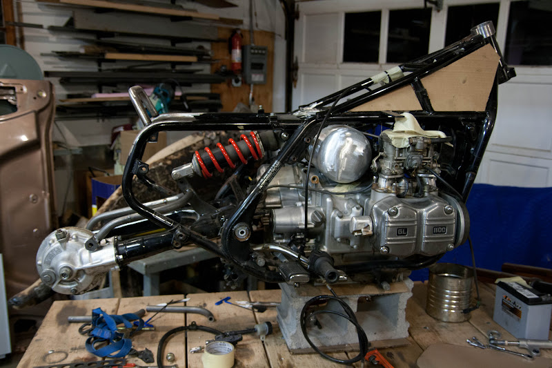

Hey, thanks guys, glad you like it.

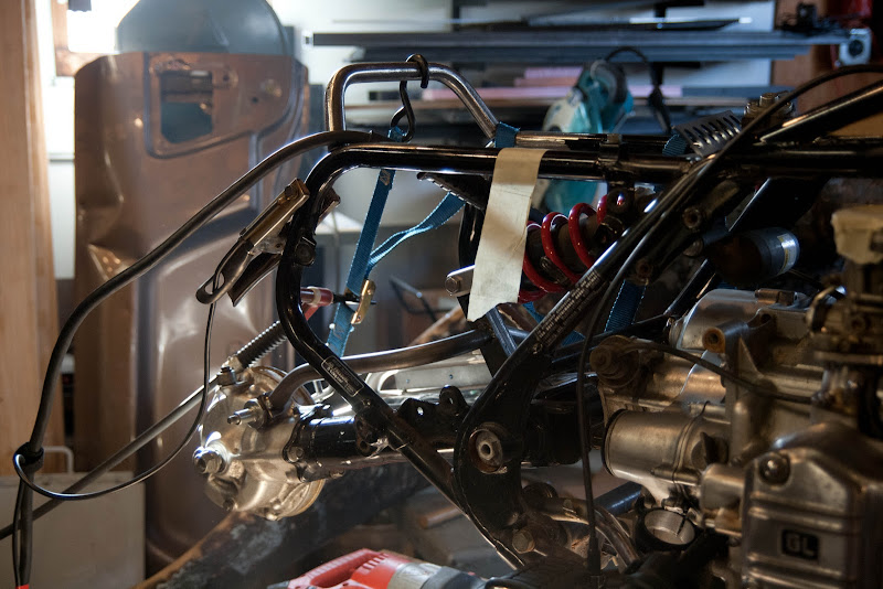

I've been going all over the place with the swingarm, and it's still just tacked in place, but in the interest of just seeing if it works I'm thinking that I'll weld it in place this weekend and be done with it, then I can start work on the side panel gas tanks.
In theory. I might be able to get away with not doing anything to the swingarm and just mounting the shock right to the front of it. It looks as though the same swingarm was used on the GL500, and there was one model that used a linked mono-shock with no other external swingarm bracing. Granted, a GL500 is not a goldwing, but this a very stripped down wing with no potential passenger weight, so I feel like anything I do to beef up the swing arm will be plenty.
Does anyone have a silver and gold wing to compare? I really think the swingarm is the same.
I saw that GTified GL on here, didn't octane post an old photo?
Toyed with the idea, but I'm not ashamed to admit that I like how the bike looks with the engine level.
Especially with the carbs sitting out there.
This is more of an adventure bike build than a GT build in my head anyway, kind of a cafe racer meets a BMW GS and has a big fat ugly baby.
I'm a big time lurker over on ADVrider, so this is my version of a poor-mans beemer.
Thanks again for the kind words, I'm really just a kid that plays in the garage.

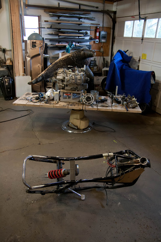

Weekends are for playing with bikes:
(well, actually I had plenty of other work I was supposed to be doing... but, you know...)
Mostly finished up the swingarm.
The head tube chop went great.

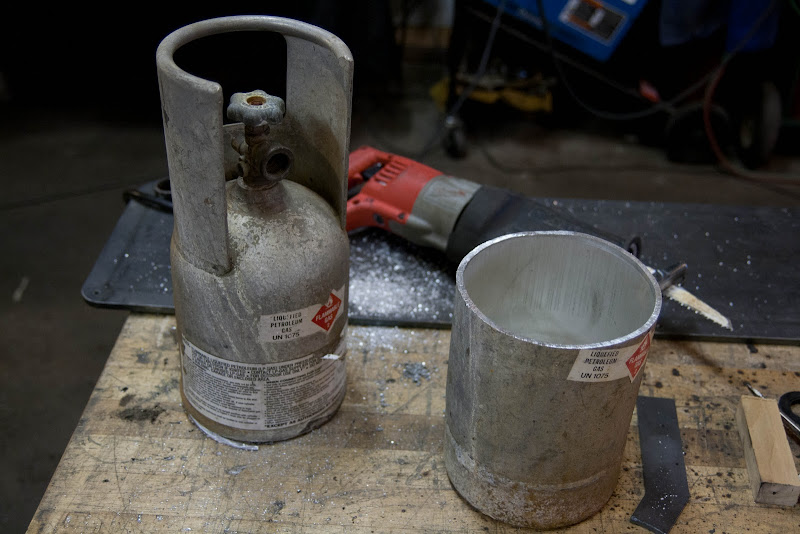

Had some fun with a junk propane tank:

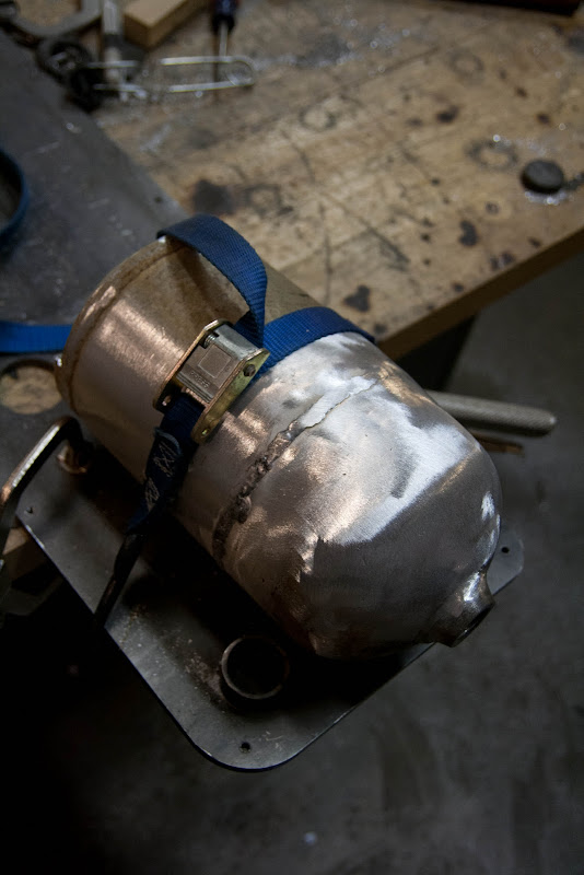

Also worked on a buck for the right side gas tank.
The motor shrugged off the frame.
So I punished the motor.

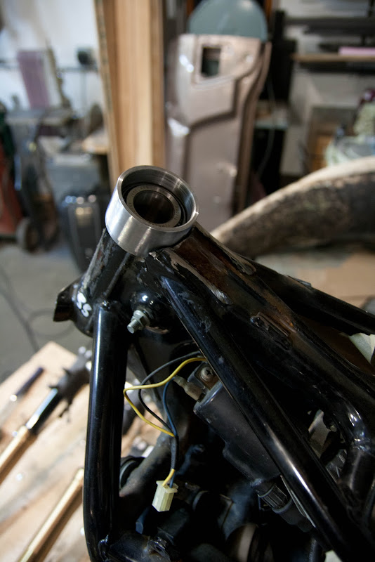

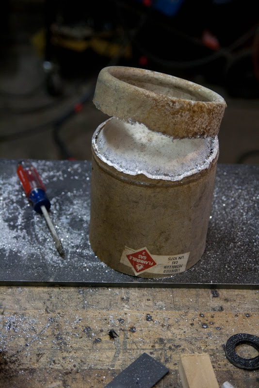

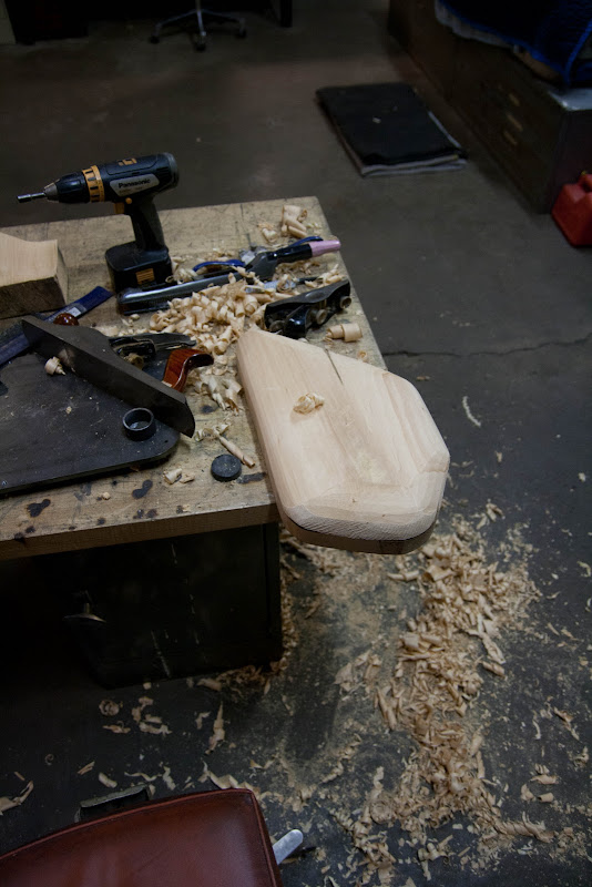

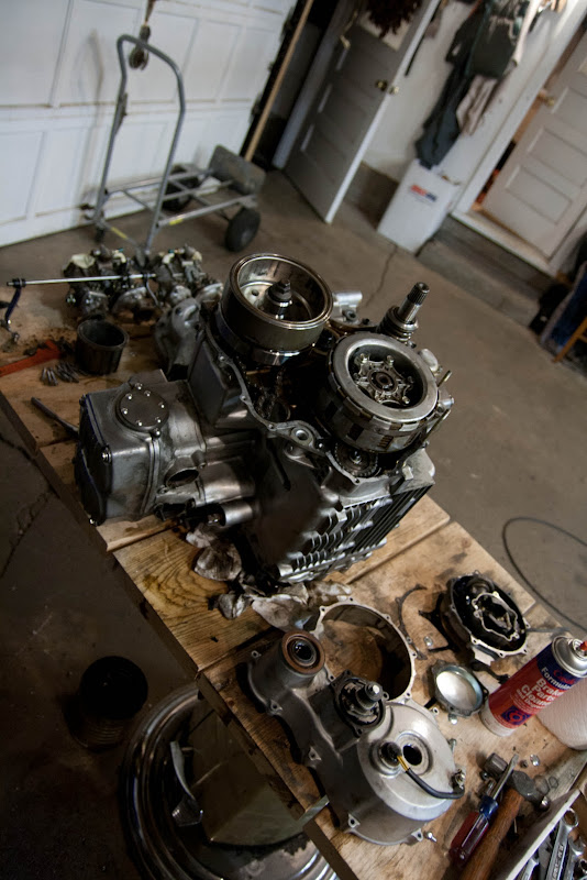

- Posts: 21336
Re: KRBobber Project.
great shot of that engine opened up, and sure looks like progress.
KMR
- Posts: 154
- Joined: Sun Apr 12, 2009 9:11 am
- Location: Eugene OR, USA
That there is the perfect example of some form of insanity.
The only reason It's opened up is because I wanted to see how it worked.
And I don't regret doing it.

- JBz
- Posts: 3070
- Joined: Wed Jan 31, 2007 8:11 pm
- Location: dayton nv
sunnbobb wrote:great shot of that engine opened up, and sure looks like progress.
just a suggestion here. Ive seen a few pictures on this site with the engine upside down and sideways. Ive split a few cases on these things and a few have had quite a bit of sludge in the bottom of the cases that will slowly creep to other places. You may consider a flush of diesel fuel or something when you reinstall it before you start it up. This is My opinion only. You can check the oil pickup screen also whille out. On the rear hub if I remember correctly the spline count and diameter is differant between the 1000 and 1100. interesting build. Thanks for sharing. JB
KMR
- Posts: 154
Thanks jbz, that's part of the reason I've got it flipped up the way I do, the filter and drain plug are out and I'm trying to drain as much as possible into that little can below.jbz wrote: I've split a few cases on these things and a few have had quite a bit of sludge in the bottom of the cases that will slowly creep to other places.
I've also read that running the engine (just at idle) with a blend of ATF and oil can help flush all that out.

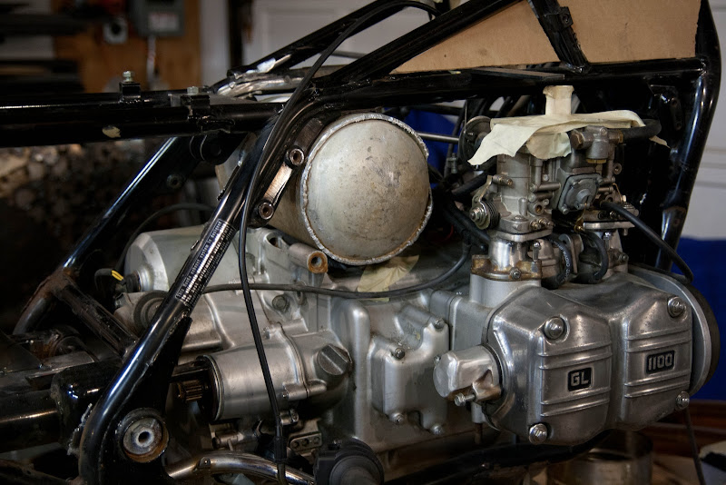

just curious . Is that some sort of a trigger wheel over on the back of the left head??? . JB
KMR
- Posts: 154
Ah, good eye!
I didn't like the stock chrome cover on there so I made that little ring and bolt plate instead. Theres nothing in there being as it's an 1100.
It's not finished yet, think I'll make a matching one for the other side, will be a bit different since the cam extends out in that one, but I like the look.
