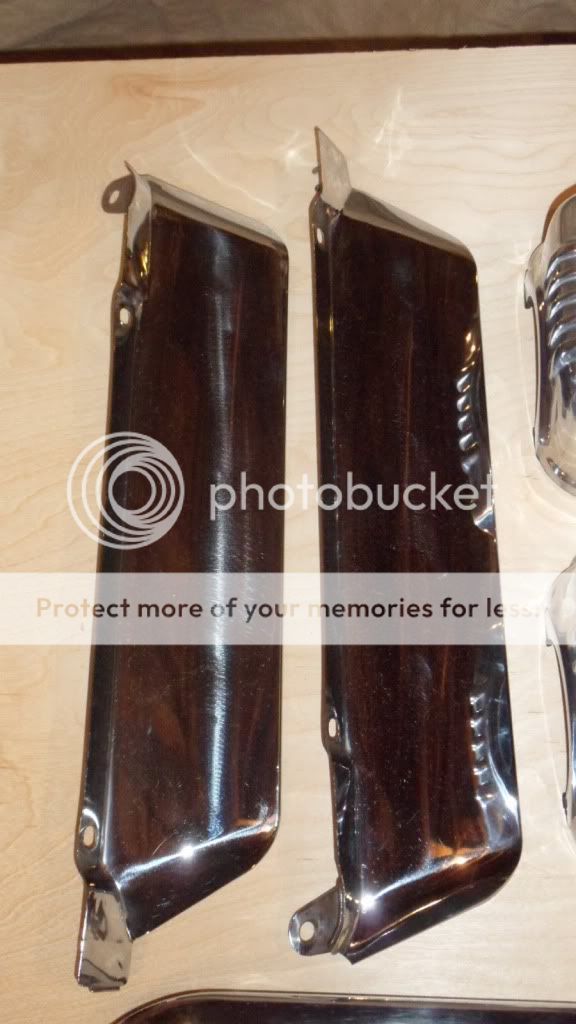

But in the mean time, I've done a bit of polishing and cleaning so I'll update here with some pictures.

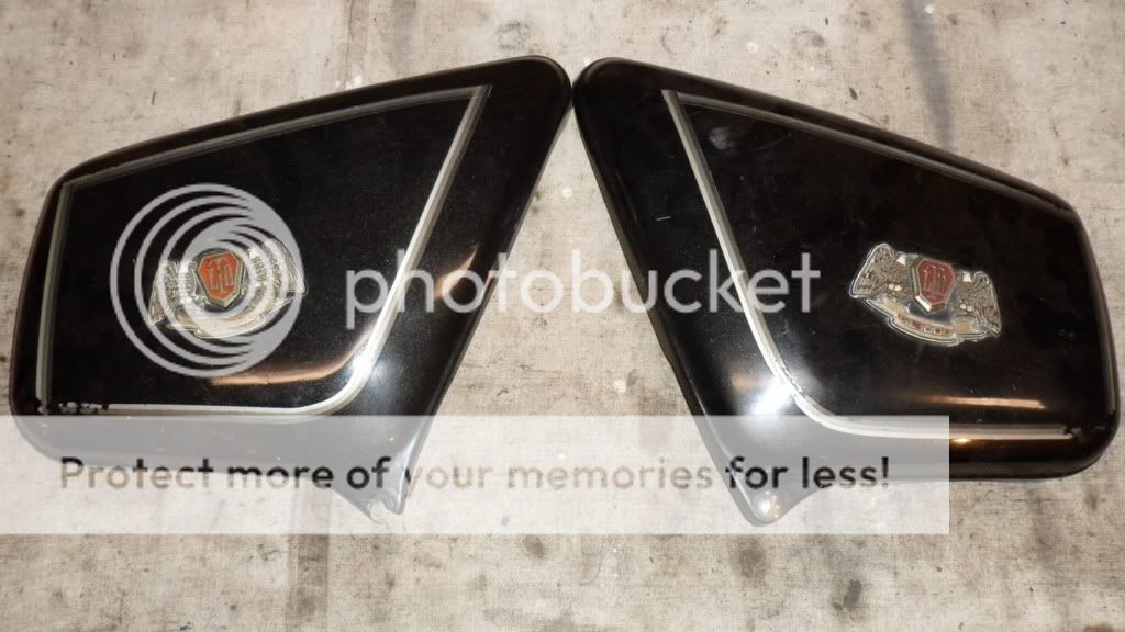

I bought a side cover off ebay the other night for pretty cheap, So I'm going to see if I can repair these side covers. you can see one of the mounting holes is broke, and the other cover has a tab broken on the back.

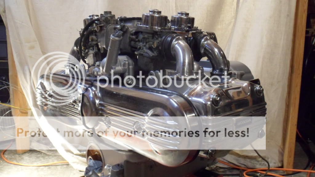

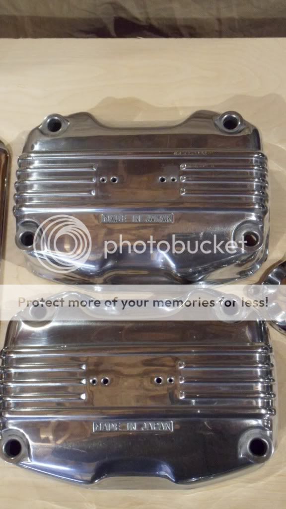

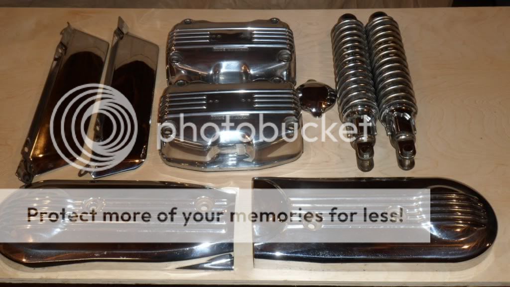

Very nice job on polishing. What type of polishing compound did you use on your buffer?
Don

dbtroudy wrote:Very nice job on polishing. What type of polishing compound did you use on your buffer?
Don

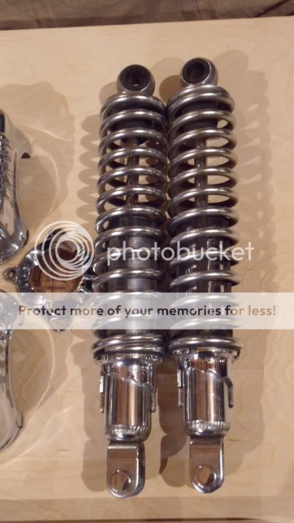

I used brown and white rouge on the valve covers and I used brown white and red on the shroud and timing belt covers. Everything except the valve covers started with #0000 steel wool. Steel wool is all I used on the shocks.

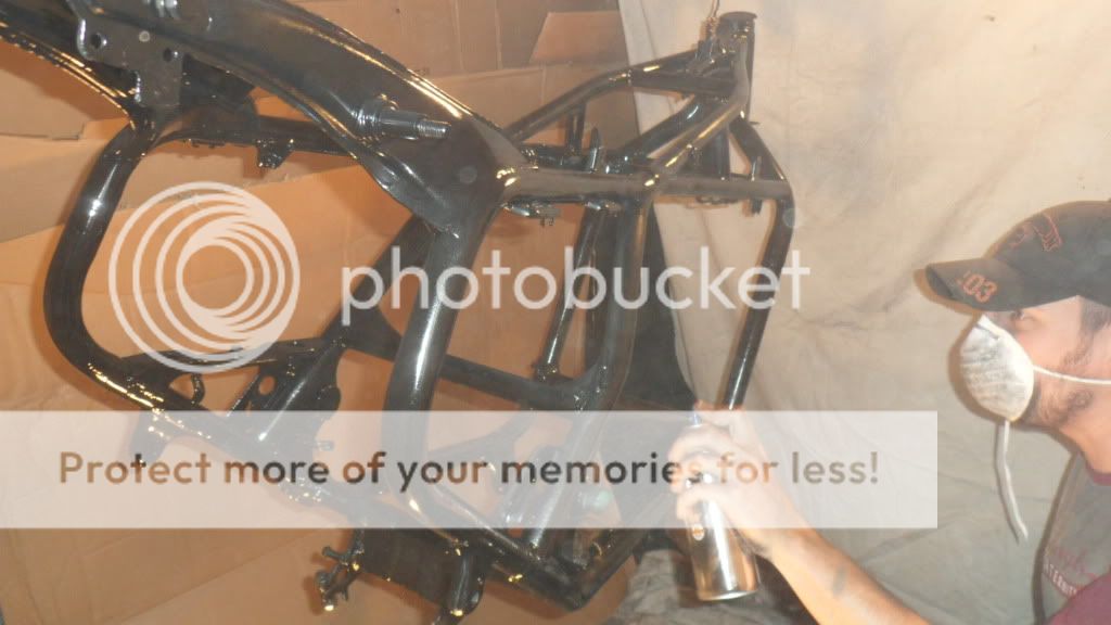

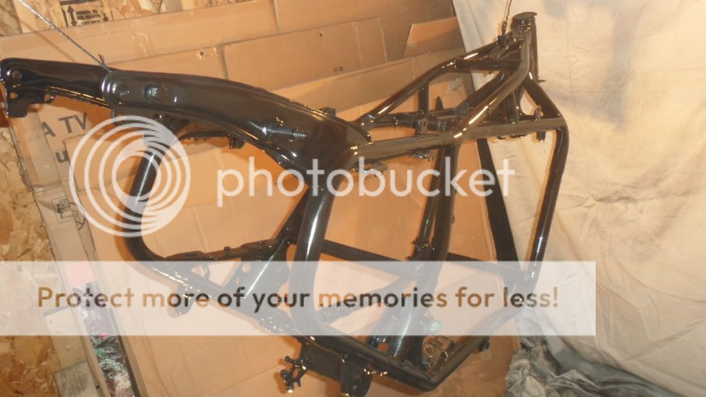

I finally had time to get out to the shop and do some real work. I got the frame stripped down, sand blasted, and sanded. A coat of self etching primer and a couple of coats of gloss black later, I have a new looking frame.
(My uncle stopped by and took a couple action shots...)

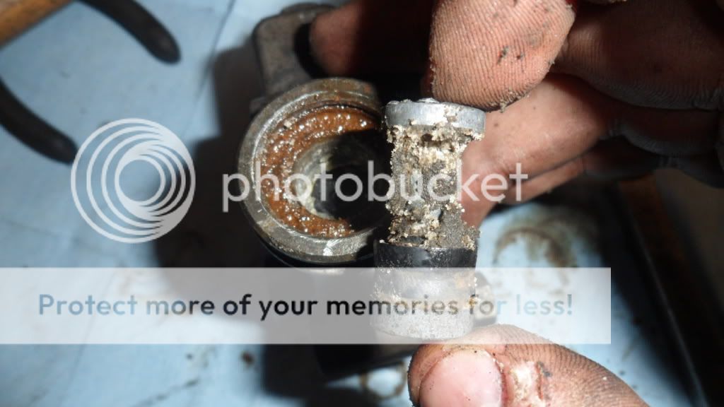

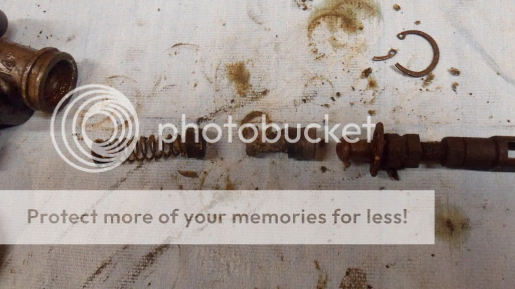

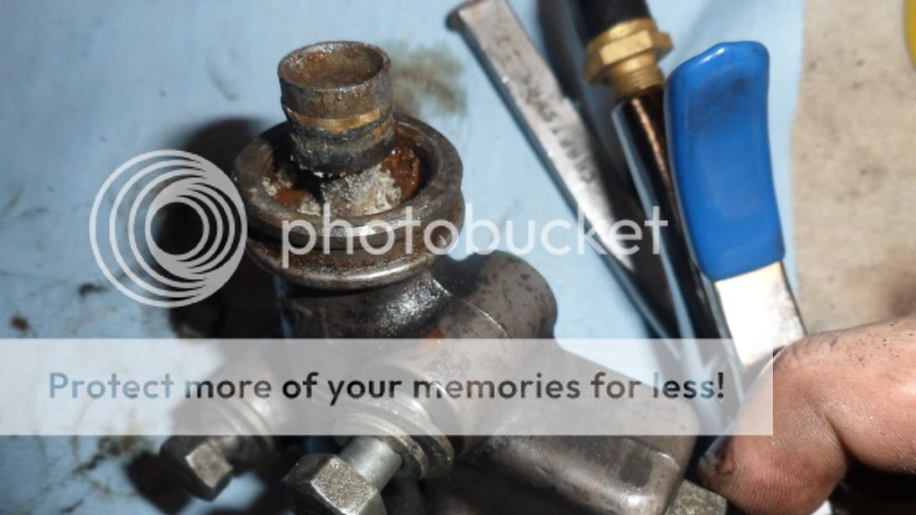

While I waited for paint to dry, I started tackling the rear master cylinder that did not move when I got the bike. I had been letting the circ-clip soak in pb blaster for about a month now, and tonight I finally got it to move. It took a bit of work but I finally got it all apart.

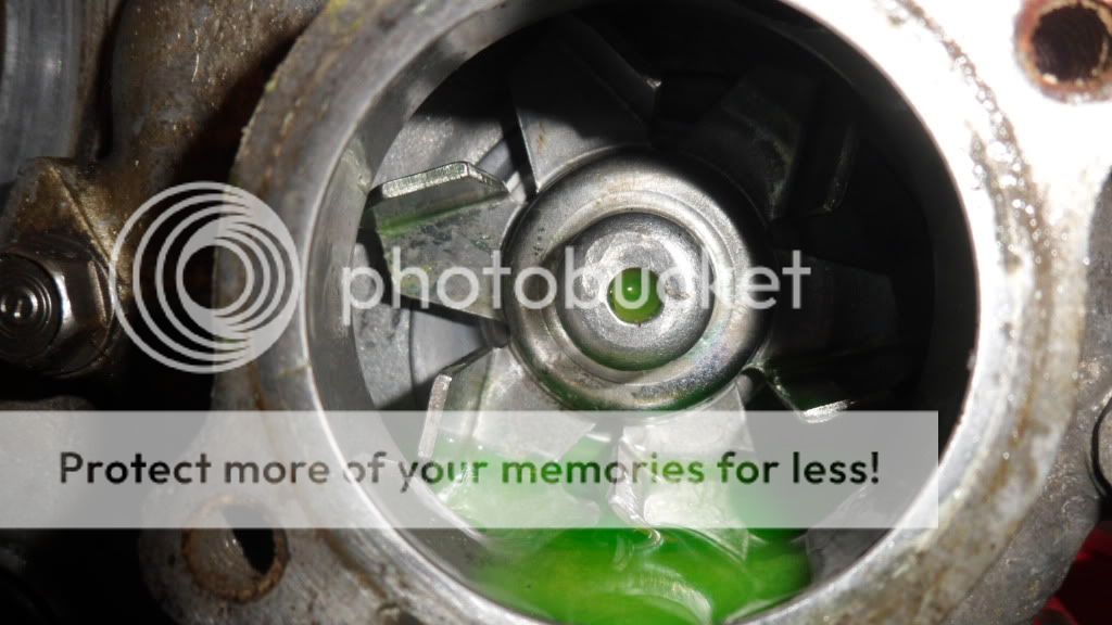

Also I pulled off the water pump cover to check out the water pump, and it appears that it has been replaced. No up/down, side-to-side, or in/out play. Just a bit of rotational play, which I assume is alright.

If I could make a suggestion.... even with rattle cans, spend the $30 and buy a good respirator with replecable carbon/organic filters.

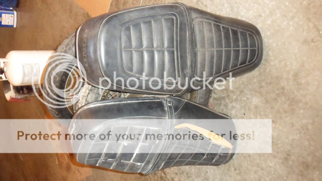

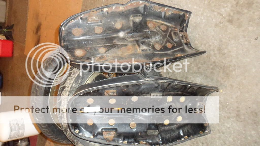

Yeah, I got a little carried away with ebay buying the second seat, but now I have one for the next gl I buy...
I have a better respirator somewhere, I just couldnt find it last night. Trust me, I regret it. My snot is still black...

The frame sure looks sharp. Keep up the great work, I need a respirator too.

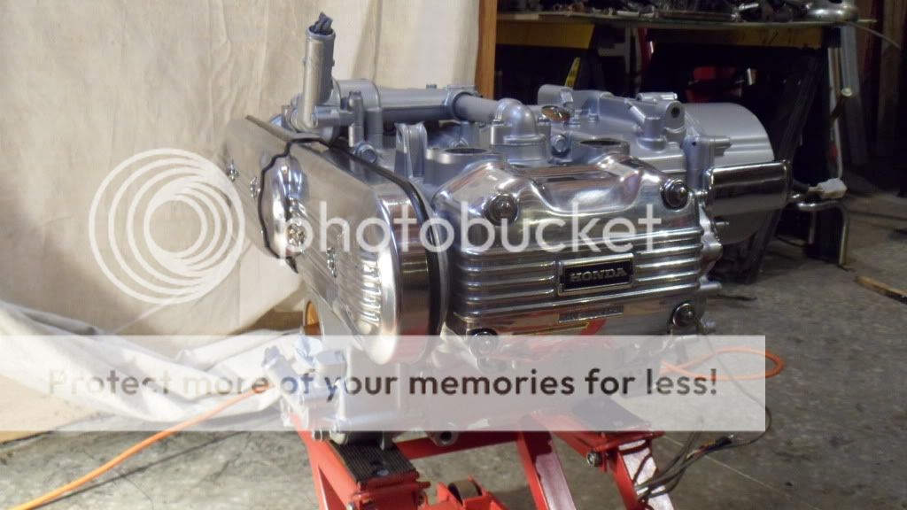

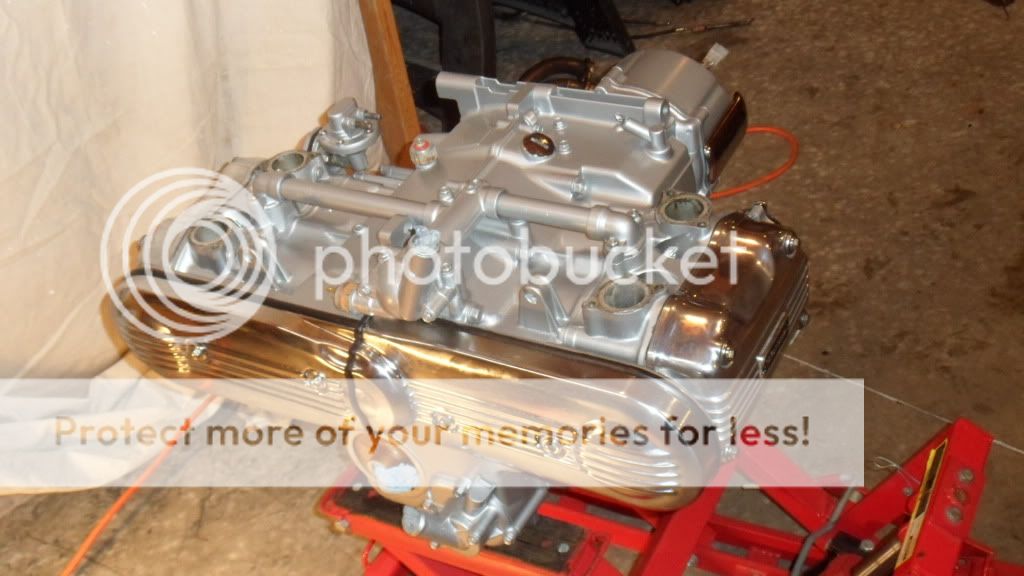

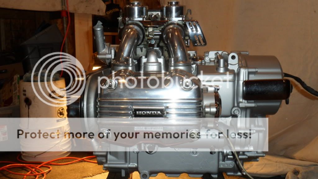

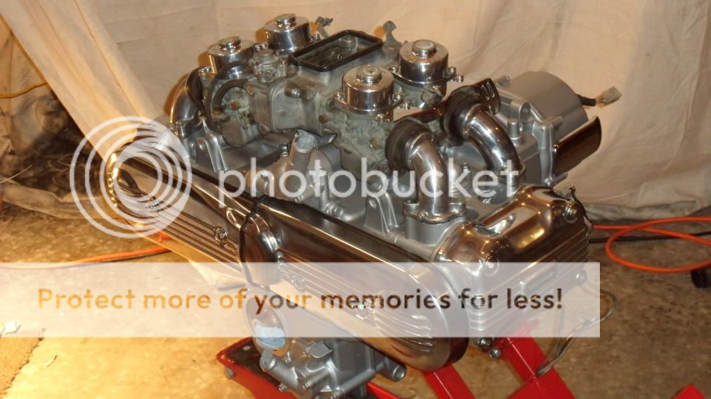

So lots of work done the past couple days. This Wisconsin weather seems to be showing some mercy.

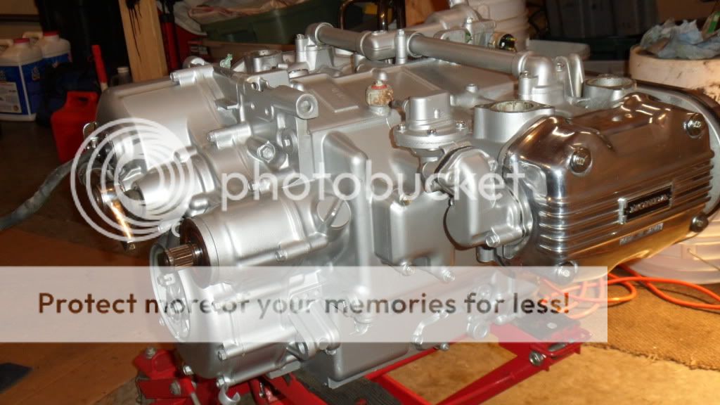

I painted the engine using Duplicolor cast coat aluminum engine enamel (with ceramic). I am VERY pleased with the results. It was a bit difficult to spay but that might have had something to do with the temperature.
Tonight I put on new timing belts, and all the covers. I just had to set the carbs on top to see how it was going to look.
I think it turned out pretty well.
