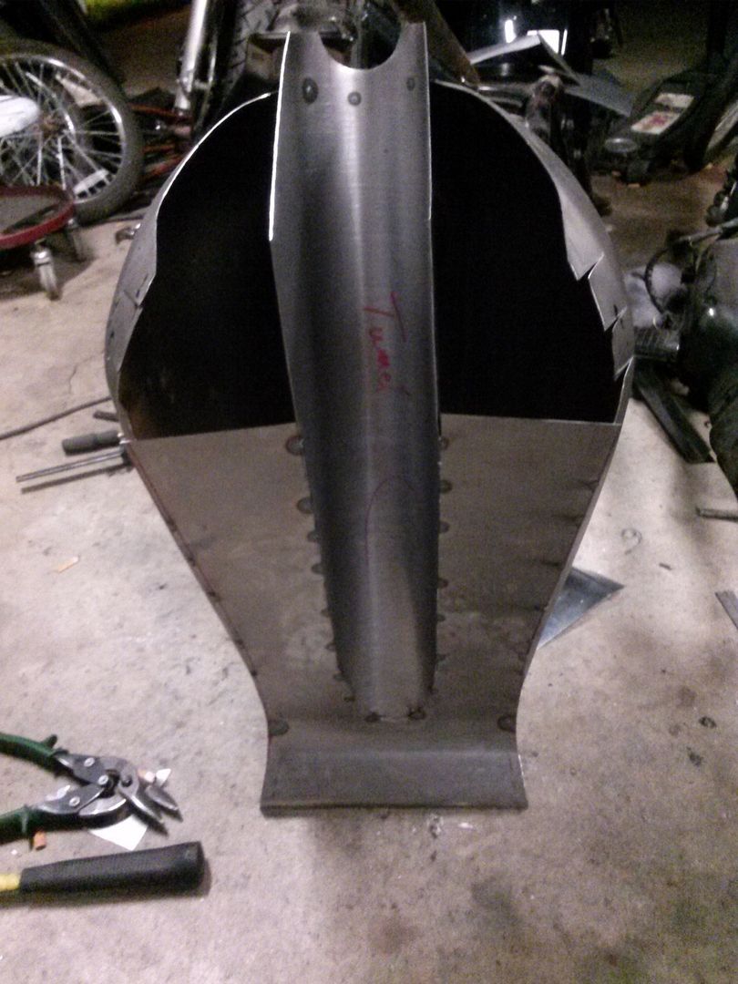

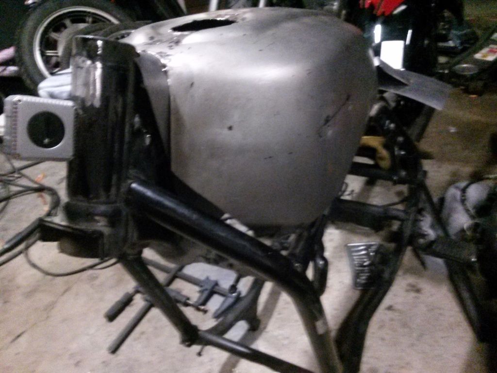

Ok... Ive been working alot lately so not much time for the project. I did manage to get a start on the tank. The old bottom and tunnel has removed, new tunnel and bottom tacked in, front fillers starting to take shape. Fillers are not done but this will give you an ideal on what Im going for...... thoughts?

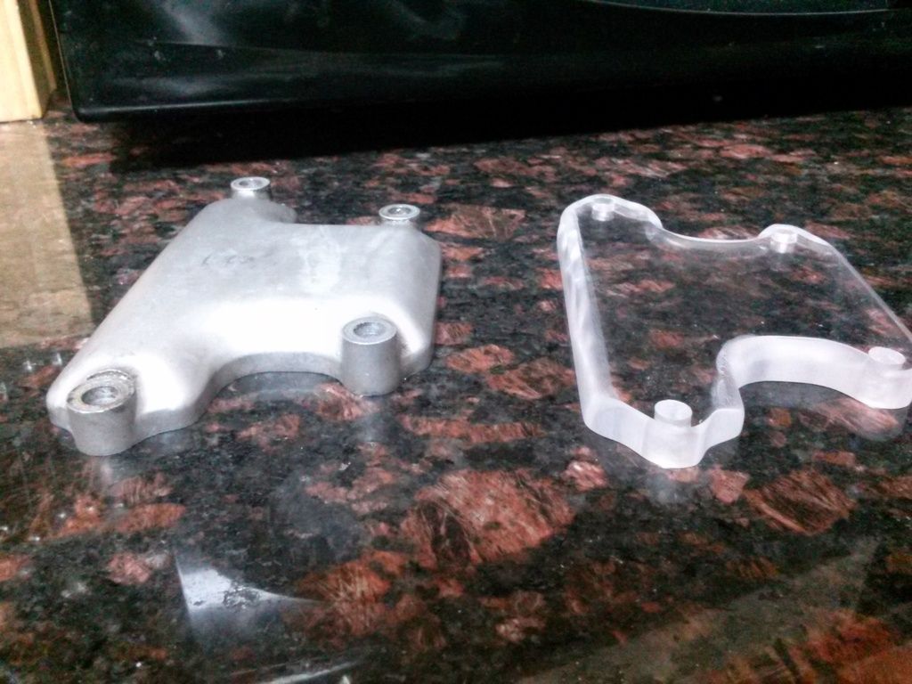

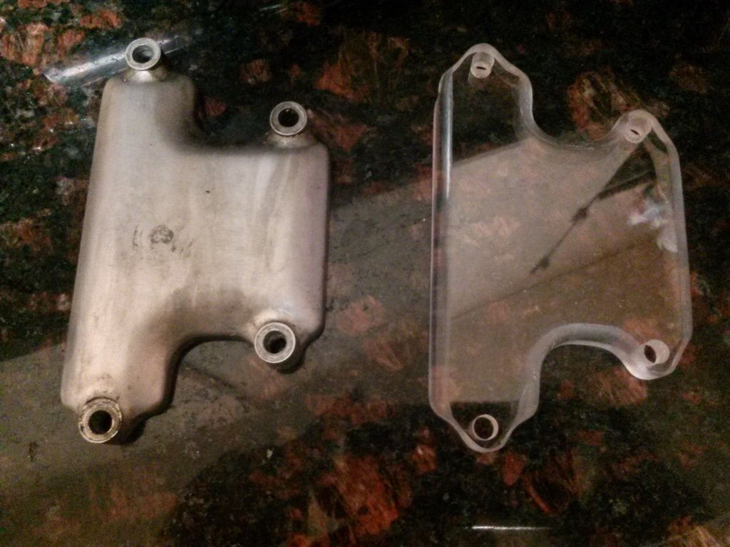

Final drive cover. This was the first attempt. final product will be better. 3/8 polycarbonate next to original.

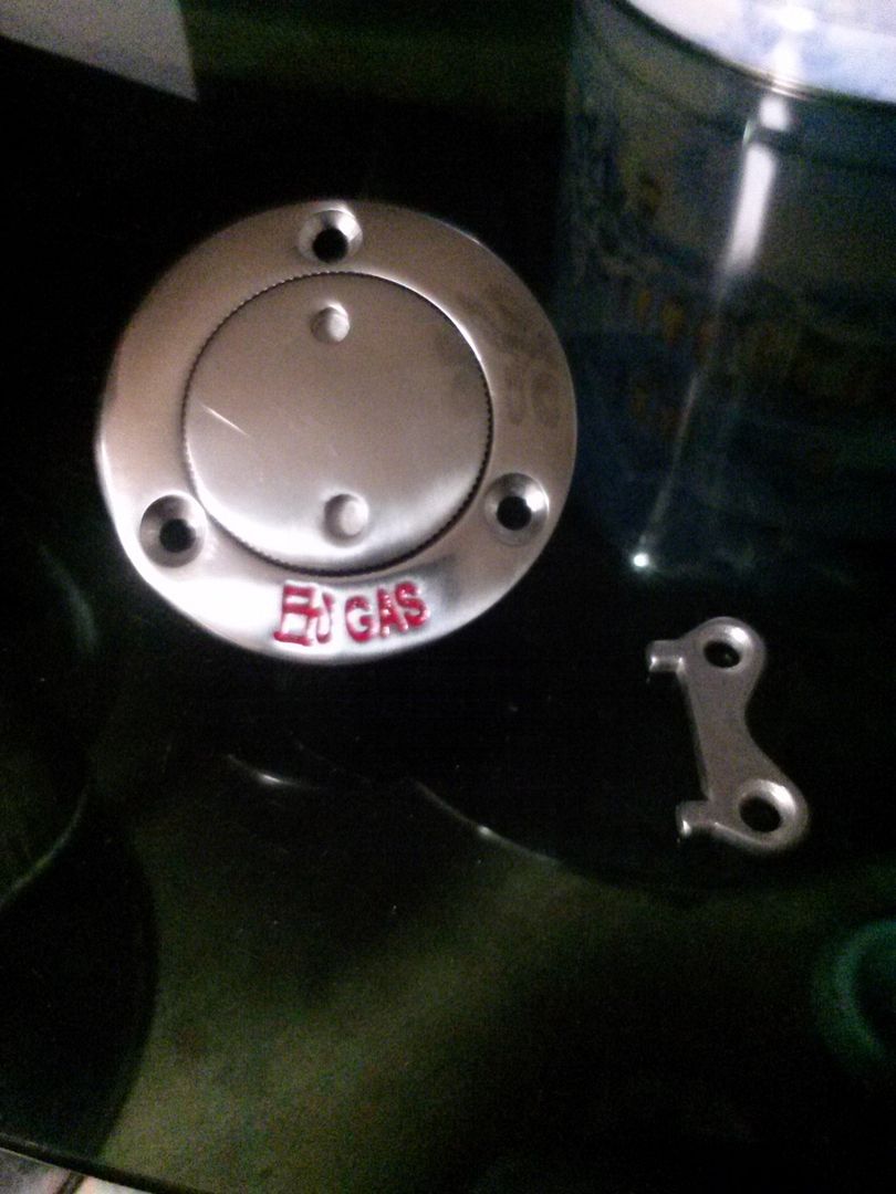

got my fuel filler/cap in the mail today. Already modified it. Cut the filler tube down where the fuel hose usually connects and drilled a small vent hole for it to breath. This is a marine fuel filler cap, all ss steel, pop up cap with key. Now to modify the tank to get it mounted up.

I've got one of those....never did install it on anything.. I would like to see pictures of it on, and how you like it as well
