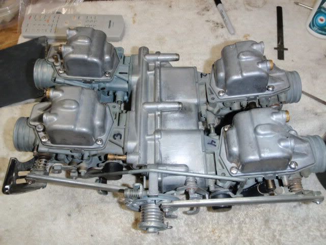

I have used a stainless self-tapper a little bigger than the original hole to replace. Being soft aluminum, you can just give a little pressure to cut its own threads. You may have to trim them to length after tapping so they don't go through and take the other side out. Better than multiple washers as I have seen. Check the curvature of the black "u-shaped" piece that holds the jets in place. It is meant to be touching the bottom of the bowl. I had one set that I chased leaks forever before noticing they had been bent too much. In trying to tighten the bowl down to where it belonged, you would strip the screws. I re-bent them to where they just contacted the bowl and , no more leaks.
Re: melloyellow to live again!
Eric, Thanks for the tip. I will double check those, but I think they touched just before the top of the bowl seated on the carb body. I swear that if these carbs work it will be a miracle. I think the over/under on the number of times the carbs are removed from the bike before they function should be 3. Anyone wish to put their bets down? (I really hope its under!) Ernie

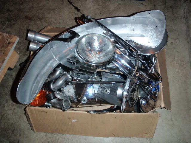

Roady, Thanks for the confidence. We shall see. I moved most of the bike up to the garage.
I cleaned, used the wire wheel and got parts ready for polishing. Here's the "to be polished" box.

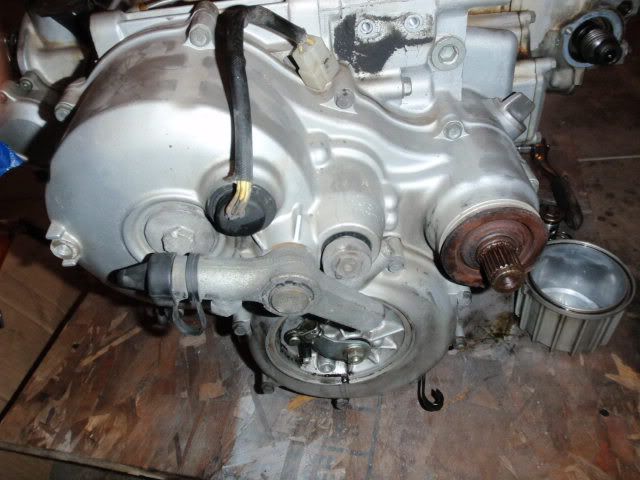

Same with the back of the motor. Should I take the back cover off?
I would like to see what it looks like. It would only cost me a gasket or two. The kick starter is stuck anyway and I am wondering what those rollers look like inside the starter clutch. What do you guys think?

That will give you a chance to look the clutch over real well too.

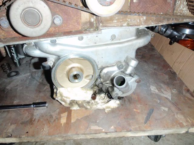

More cleaning. I did remove the water pump cover. Yes it wiggled. It had even slightly scored the inside surface because of the wobble I suspect. It would probably work, but for how long? It will be replaced. I can not seem to find the end point, but I think I'm getting close.

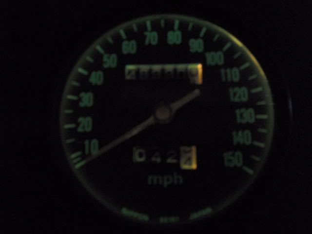

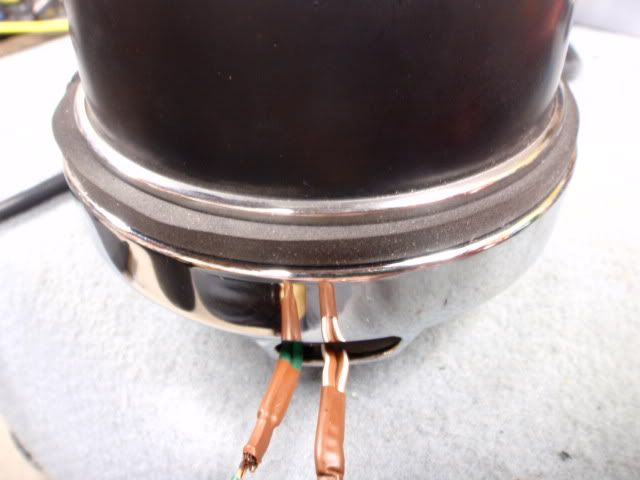

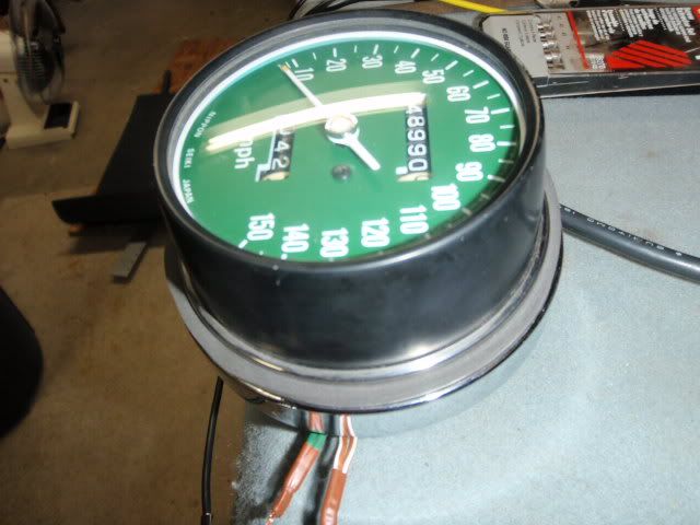

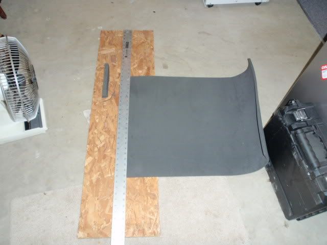

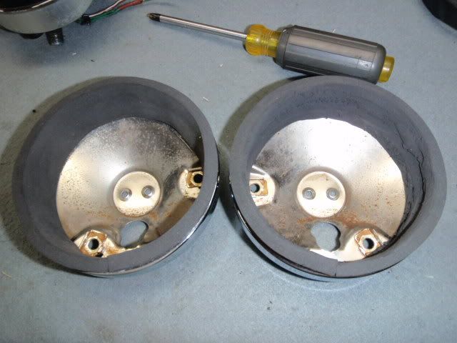

I got home from work a little early so I dove into the bike. I talked with someone about repairing the frame, (the threaded insert that receives the bolt holding down the seat has pushed in to the frame) so I decided to clean it up. I went over it with simple green concentrate and steel wool. It cleaned up real well and should not need too much work before paint. That cleaner does a great job and is not as harsh as brake cleaner etc. Anyway, after that I decided to work on the gauges. I took them apart completely for cleaning and polishing. I have looked hi and low for replacement cushions to no avail. I decided to make some. I bought a piece of neoprene foam rubber for $9. I then cut a strip off.
I fitted them into the chrome covers and then realized they were too thick. ( I bought 3/8 and 1/4 would have been perfect. I trimmed off an 1/8th of an inch and they fit perfect.
I tried to cut a bevel on the top, but was not satisfied. I decided that the flat top looked just fine. It is definitely not show quality, but not bad either. The main thing is that it holds the gauges in solid.

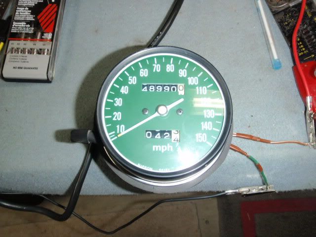

Then I tested the lights in the gauges and they worked fine.
