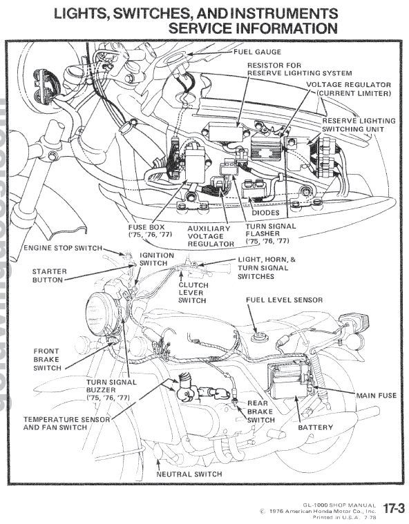

I had the same question for my '75 and some kind member sent me this diagram. I still got it wrong! The main trunk of the loom goes inside and the tentacles come out through the openings.
http://i25.photobucket.com/albums/c74/r ... groute.jpg
