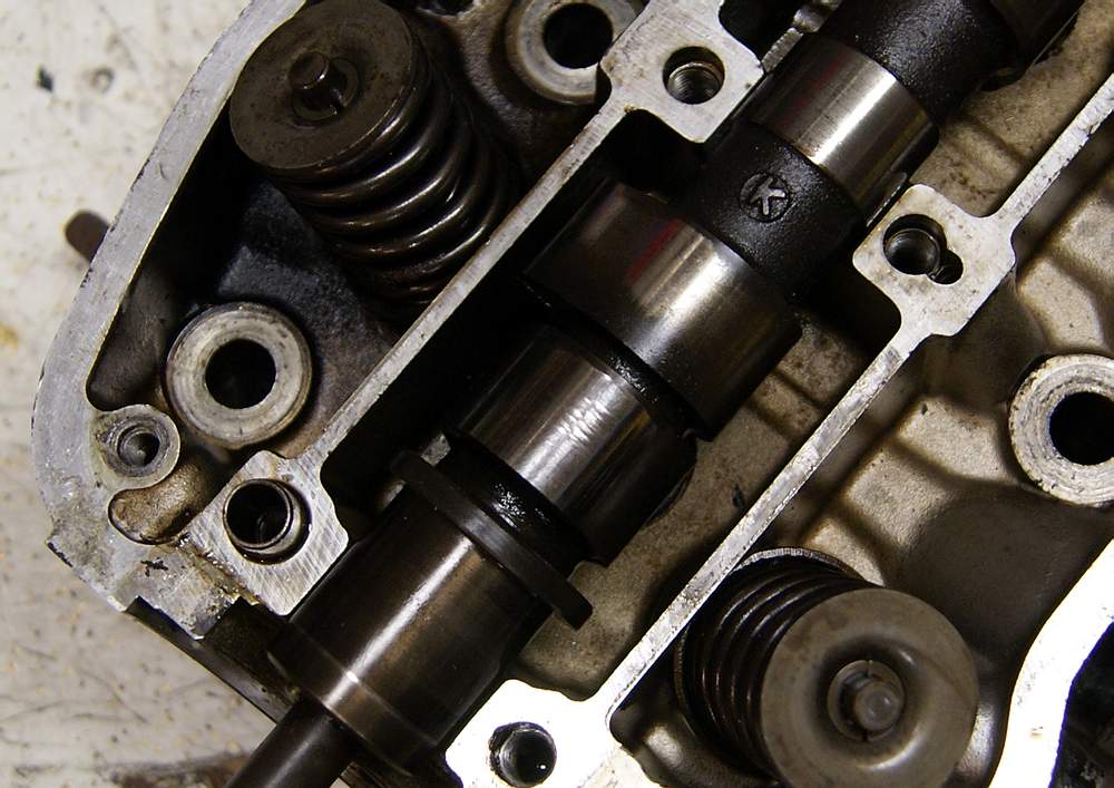

Also, should I be thinking about dressing the cams & followers in any way? There are shallow ridges on the lifting areas of the lobes and matching grooves in the followers. None of them have sharp edges and while they look bad I can barely feel them with a fingernail.....

That is not a good thing. You should never be able to see/feel any wear like that.Sidecar Bob wrote:snip........... There are shallow ridges on the lifting areas of the lobes and matching grooves in the followers. None of them have sharp edges and while they look bad I can barely feel them with a fingernail.....

I looked at a lot of pics of damaged cams online but couldn't find any that looked like mine. They all had a lot of sharp, deep scoring or large rough areas. Here are pics of the marks on the worst of mine. It almost looks like there were harder areas on the lobes that didn't wear as quickly and they wore grooves in the followers

I wouldn't run those pieces unless I absolutely had too. The wear will get worse. Going by the pics it is past the hardened part of the cam and follower.

Interesting. From the ridges at the edges of the cam lobes where the followers don't rub these cams appear to have less wear than the ones in the 79,000 Km 1100 engine. And the followers don't look as worn either. Other than the grooves that match the ridges on the cams, that is.
In the last day I have spent several hours on Google trying to find pics of similar wear with no luck. As I said, the ridges & grooves are not very deep. I had to take a bunch of pics before I got ones that showed them...

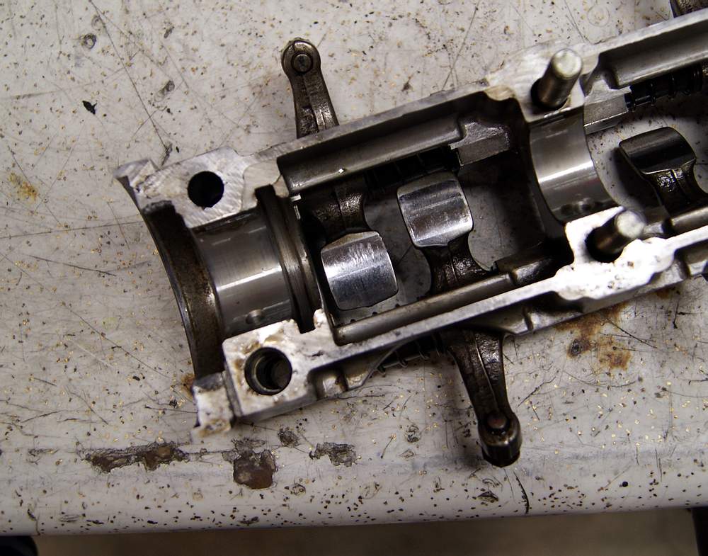

I think the hole in the follower on the left in this pic from http://www.wingovations.com/cams-and-rockers/4579471096 showing followers that have been dressed looks deeper
