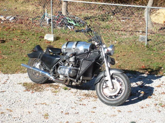

I never thought of that. I was gonna try it anyway but this may speed up my efforts.rainstromrider wrote:The round profile of the tank would deflect most of the glare. You would only get a sliver, and on sunny days you're probably in sunglasses anyways. Polish the other tank! Can always switch back and forth depending on the weather!

Polish the whole thing, then run a two inch stripe or even tape at the 12 o'clock from top to bottom then no glare for you.

This and the KMR Bobber are just Freak. I love em.

Now that is the coolest ride I have seen for a looooong time, Sir!
I love the gas bottle, that is one true Mad Max ride.

Polished on my tank. This tank is just a little bit shorter and mounts further to the front but same gallons.

Love the look of the polished bottle. Wow, you will never be able to sneak into q store without having to tell a story.

NOW WERE TALKIN!!!!
Polished tank put you way over the top! Love it! Putting a fraction smaller tank on really pulled everything together!

that's RAD

AWESOME!
