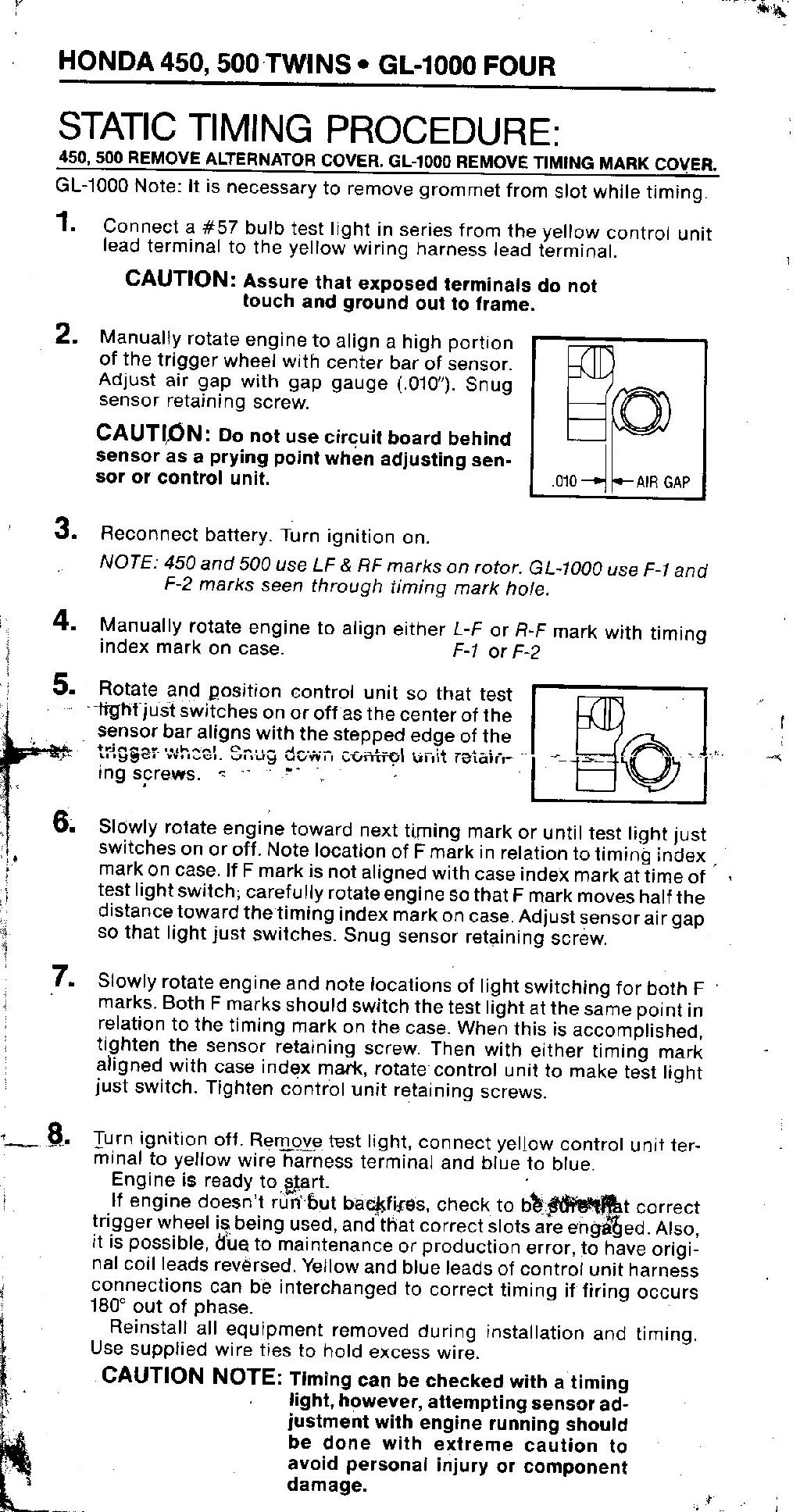

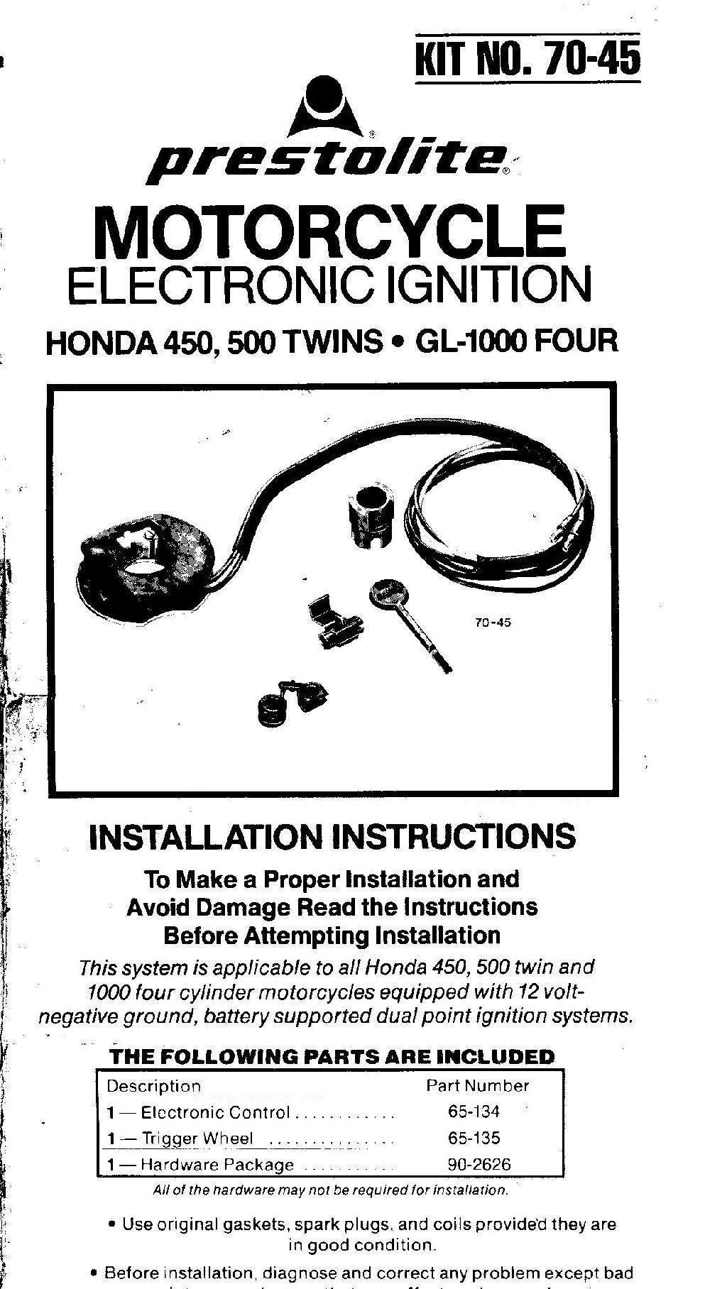

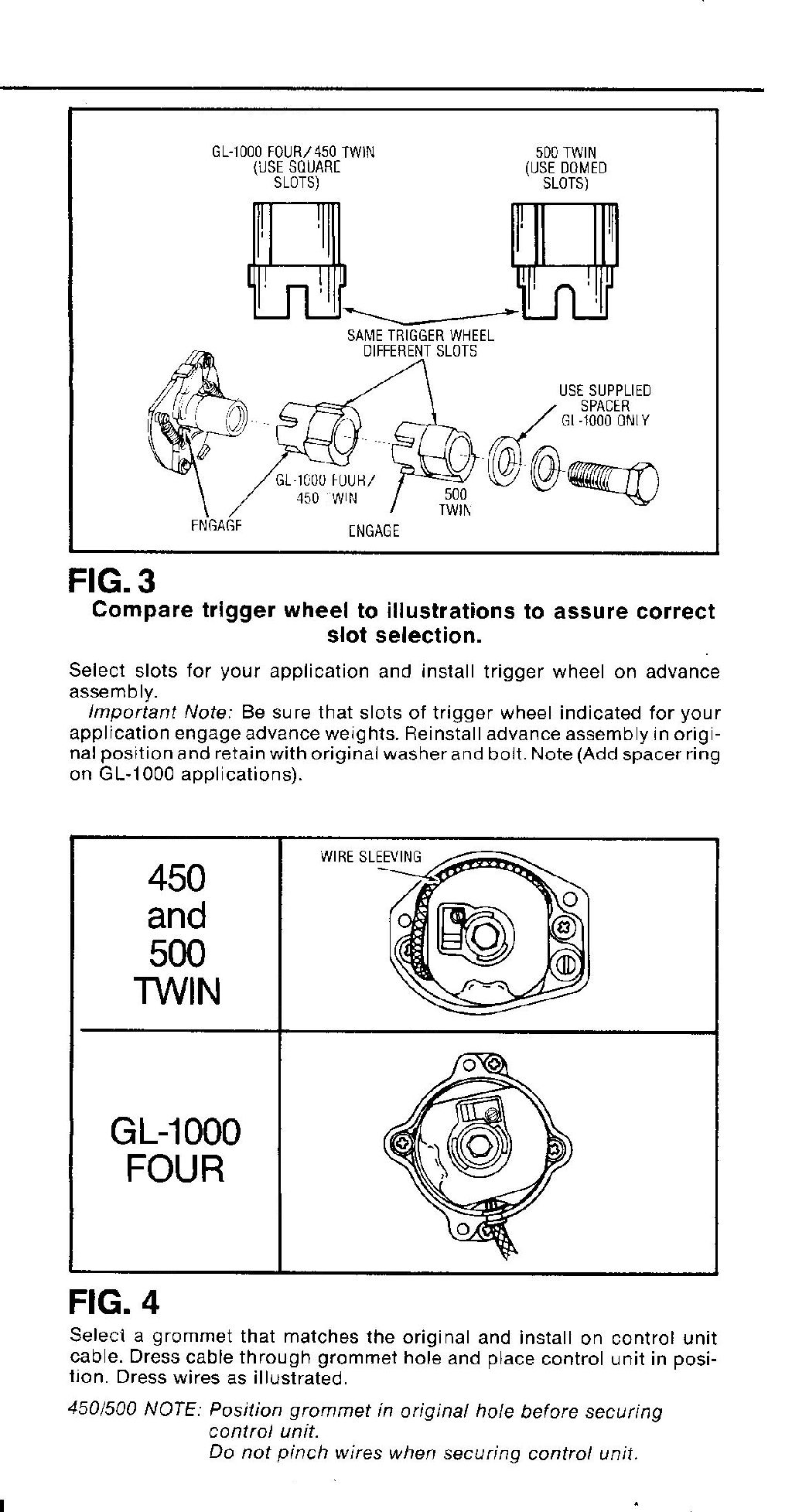

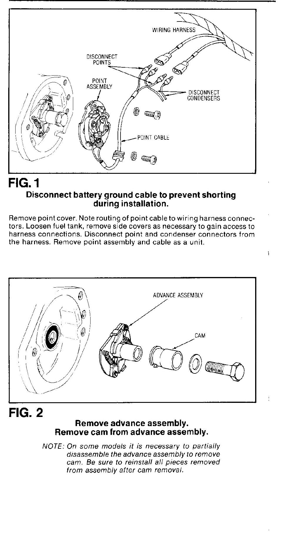

(edit If you want to print these out go to the gallery link below and double click on each image, they will be displayed in full size and can be copied or printed WF) https://ngwclub.com/gallery3/index.php/ ... s/album315
"I periodically misspell words just to annoy the word police."
Anyone have info on whether the resistor is needed with 3 ohm coils??
ericheath wrote:Anyone have info on whether the resistor is needed with 3 ohm coils??
It shows one in the diagram with the stock coils. But aftermarket Dyna or Accel coils I would think you could loose it.
