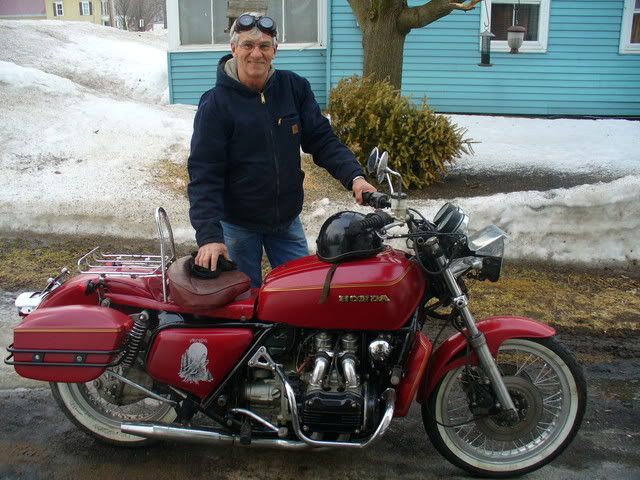

got a harley 1951 fl rear hinged fender on the back of my 78...and an unknown year narrow glide harley fender in the front.....correct width to bolt up without heavy mods...see link...T
http://www.ngwclub.com/gallery/bigt/100_1146

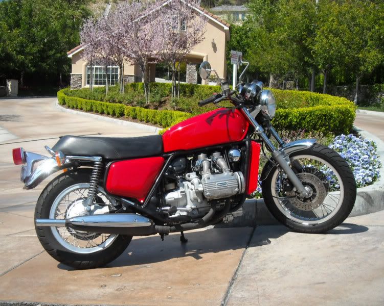

KZ750
I see that frenchy from crescent moon has a 76 gl1000 with a KZ750 front fender looks sharp for sale .
Here is the link on ebay
http://cgi.ebay.com/ebaymotors/Honda-Go ... otorcycles
