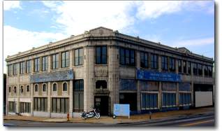

There are two places that I have delt with.
OUTPOST MOTORCYCLE SALVAGE - Hwy. T - P.O. Box 238 - Rosebud, MO 63091 near Union Mo
and
http://www.archwayintl.com/about.htm
The pictures make the place look a lot cleaner than it really is.

Tried to do some shopping today but Archway has changed from a salvage house to a gold mine. Steve was right. They wanted $75 for a sad looking master cylinder and another $75 for a side cover. Didn't buy either. They wouldn't even allow us to walk around the main floor without an escort. In the past, I've been all over the building only being escorted part of the time. Think I'll do my shopping on ebay. Progress today was fix a flat on the bike and the truck, found the wiring problem, had her running for a while, choke cable is now working, disassembled the master cylinder that doesn't pump, new plugs in the GL and some cleaning. Busy day.
