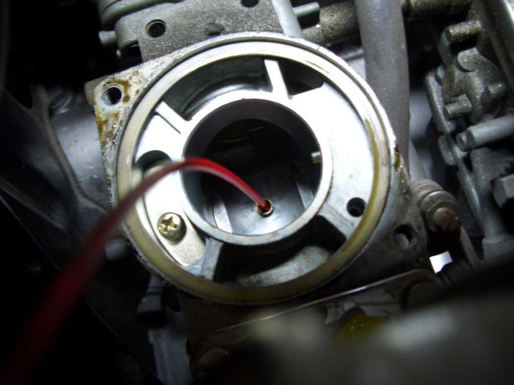

..take a spray can of carb-cleaner and fill float chambers/carbs
((*) read the instructions. Some have to be mixed with fuel. Some will damage rubber parts if left too long/undeluded)

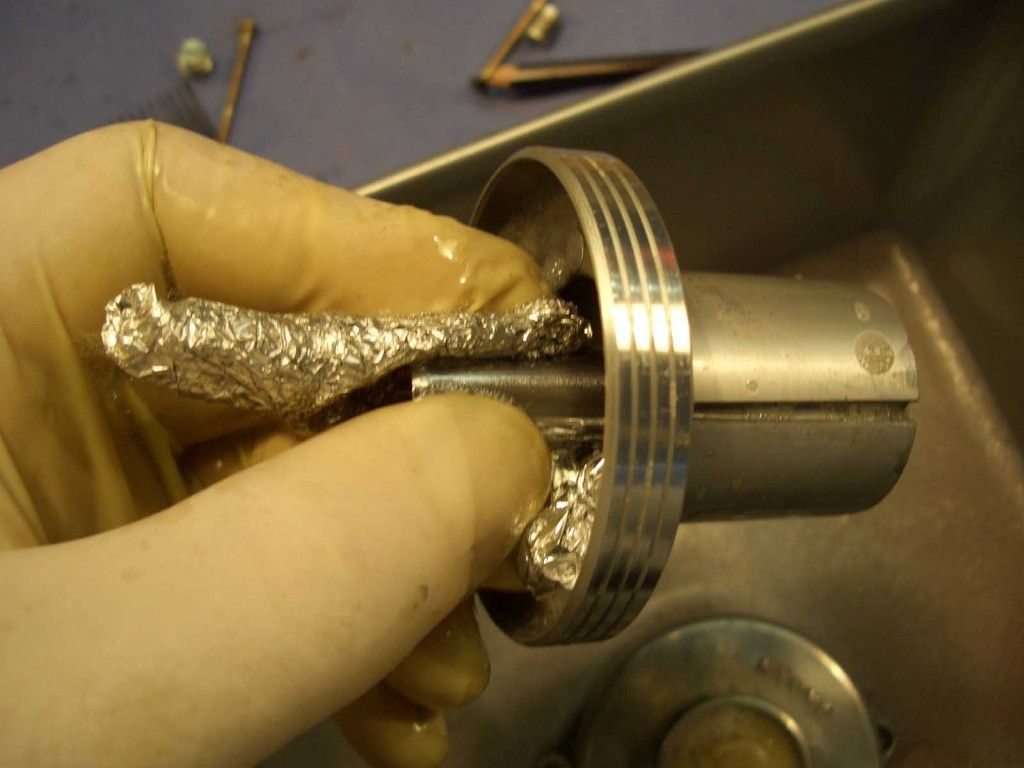

While the cleaner does what it's supposed to do
you have time to clean the vacuum chambers and pistons
I use a strong bathroom(!) cleaner. Very effective!
..and some thin soft tinfoil
Mind you: "thin"..."soft".
You don't want to scratch and sand away material...just clean.
A polish could be enough if the parts are in good shape.
removed the needle, cleaned the piston and the hollow thingy
in witch the piston slides
and
the piston 'tube'
...rinse everything in carb cleaner

..the only slight problem with that method is
that very very little or practically none of the 'Miracle Mechanic in a Bottle' stuff
will actually get into the parts of the carbs where the fuel (and all the ugly stuff) is.
It will only soak the 'venturi'
..plenum --->right through the 'venturi'--->into engine
a tiny tiny bit may enter through the bypass ports
(3 small holes left side)
and maybe into the fuel jet outlets
(but then again, they're 'raised')
and the minute you crank/run the engine
the vacuum from the egine will see to it,
that the stuff will go directly into the engine (cylinders)
