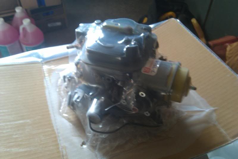

Afetr reading through this thread http://www.ngwclub.com/forum/viewtopic.php?f=47&t=49727 then I was on the hunt for a 32/32 weber, which is tough to find, but I got a reman one,,,,,,for about $65 on ebay.
It was listed as: ROS 1981 FORD/MERCURY FOR 1.6L 98 CI ENGINE 2 BARREL REMAN CARBURETOR and the guy shows to still have more than 10 available. I couldn't really find out any specifications for the carb, so it was a leap.
Sure enough, when it got here its a motorcraft branded weber 32/32. Looks like I have quite a few vac ports to plug, and 2 solonoids to either modify or remove. I believe they are both fuel shutoff solonoids and I might use both, not a bad idea since my tank is a gravity feed.
Next was what I have on it now, a 28 pict solex. Runs perfect, until it runs out. TO SMALL!

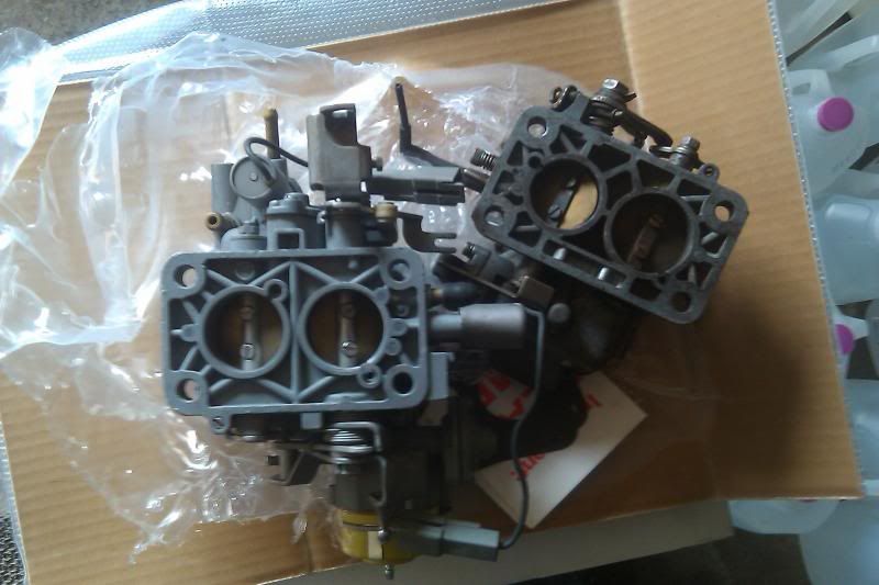

Here it is next to a 32/36 weber (well, most of it anyway)

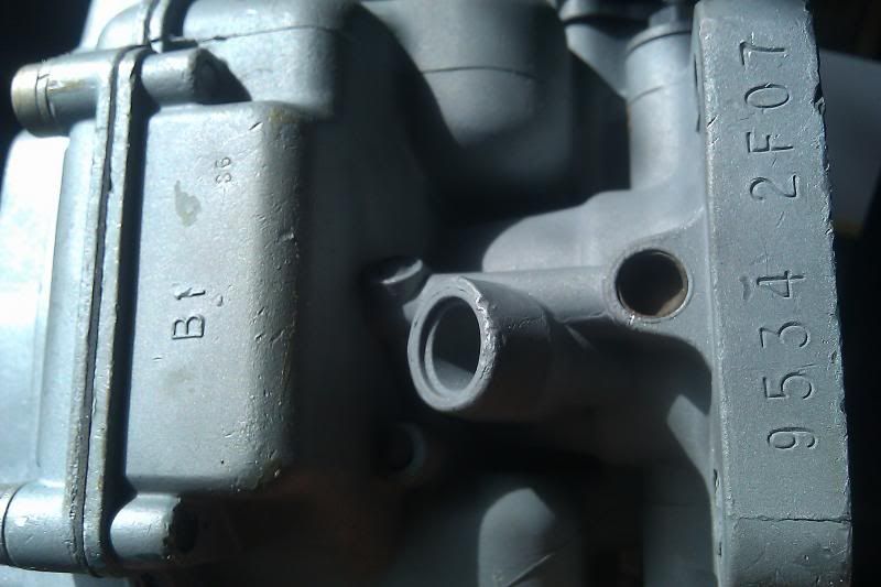

It looks like this carb originally had a factory sealed idle screw, the rebuilder company removed it.
Here are some pics, some with some carb numbers:

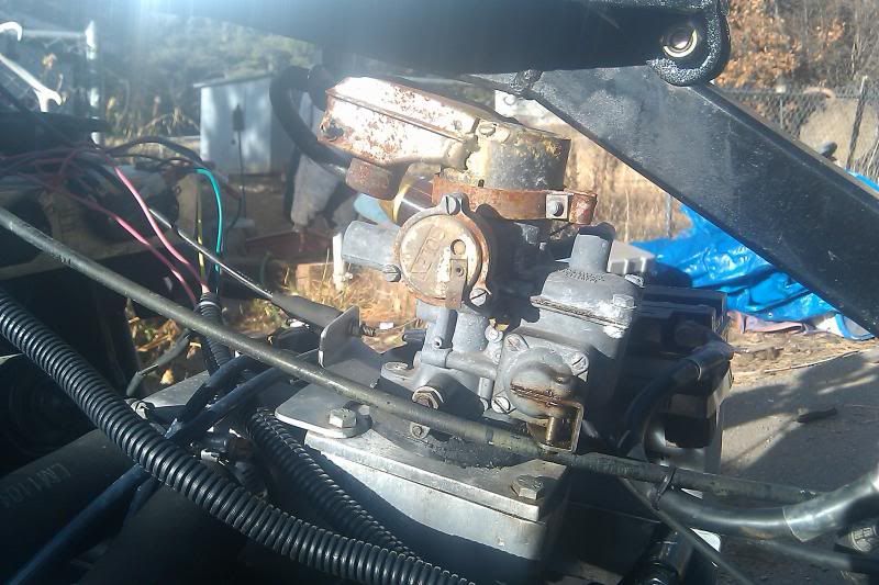

Here is the leaky old POS I am replacing. It came straight off an early 60's bug in my friends junk pile, all I ever did was open it, and see that when that bug sopped running that it was stone empty of gasoline (and clean), bolted it back together, and ran it. It really runs good, and the jetting is bone stock, but I am after a little more umph.
It is sitting on a Scat intake that is set up for a weber, with a home made adapter plate right now. So the weber is already a bolt on for me.
