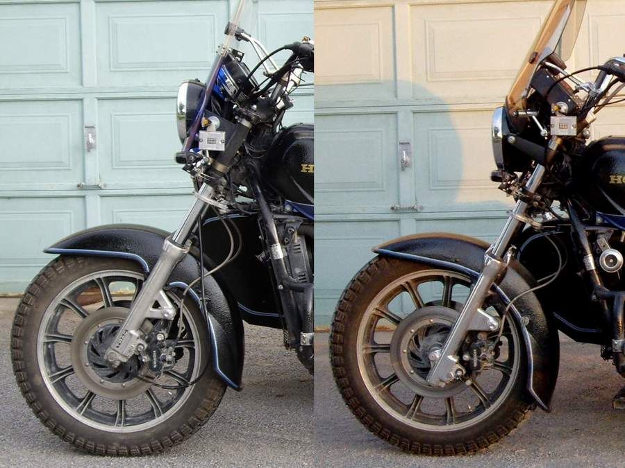

My original forks (on left with TRAC sticker in pic below) had caps on the bottoms so removing 4 nuts let the wheel & axle come out together. The new ones (on right in pic with the axle in front of the sliders) look much like the ones on your '77 (pic below my before & after), screwed into the left leg and with a pinch bolt on the right.
