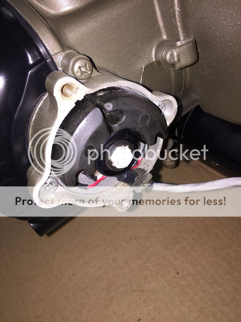

I discovered that my donor motor has a Dyna S ignition where as my original motor had the stock points.
Here's what it looks like:
I don't know anything about electronic ignition upgrades. Am I going to be able to just plug this into my stock harness and be good to go? Or will I need to do some wiring / order new parts? Help!
wingrider
Posts: 3809
Joined: Thu May 24, 2012 12:15 pm
Location: Maple Lake, MN USA
Re: My 75 Wing Cafe RestoMod
Post by wingrider »
You should be able to swap in the Dana system into your bike...there are install directions around I believe, so baring those, you have everything you need. Seem to recall the resister is a different one than stock.
