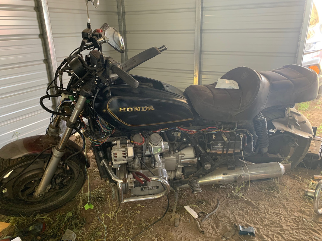

One of my first bikes was an 1100 Goldwing. I liked it, but I wanted some of the new technology and so I bought a 2000 BMW K1200lt. Then I got into Adventure riding and bought a few ADV bikes, then I really wanted my wife to ride with me and she could not get on the tall ADV bike I had, so I decided to get a Goldwing. I wanted a 1500, but had $0 to spend. Then I saw an ad on CL for 2 Goldwings, a 1984 GL1200 Aspencade and a 1989 GL1500 for $600. They were in rough shape, but complete. The 84 had a "poor boy" conversion, but the alternator was missing. The 1500 was all there, but ugly. Lots of cracks in the plastics, and 175,000 miles.
I only got the title to the 84 1200, but she had paperwork for the other bike. I got the 2 bikes both running and rode them down the road. I never liked the 1200, just too ugly and the 1500 was going to require too much work and the title became almost impossible.

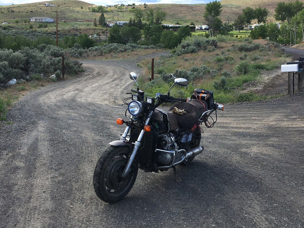

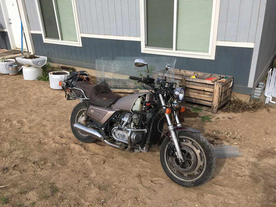

On to the bike. It is a 1984 GL1200 Aspencade that is now stripped of everything I don't want. You will see in the pictures that I have retained the rear rack and it will stay. I want to have someplace to tie down gear when we travel. This will not be a cafe racer style, more work less play.
I wanted to run something more aggressive for tires, but the options for tires were limited due to the 16in front and 15in rear. So, I installed the whole front end from the GL1500 on the 1200. I will be doing the rear too when I get the time.
As of now I have it running, I need to do some tinkering to get the carbs running a little better, maybe some SeaFoam. The tail lights are just zip tied on, the shelter needs a lot of work, and I need to replace the headlight with something legal. It is just a spot light off my truck. The 2 LED lights are what is working right now. I am also running the handle bars from my old CB500X and some E-Bay masters. For rear shocks I am using 2 coil spring shocks off 2 Gl1500s. Its a bit stiff right now, but I want to add some weight to the back like if it was loaded for camping to see it it is still too stiff.

Looks like a good solid start. Was the front end swap pretty straight forward?

The front end swap was very straight forward. I used the 1200 triple clamps and the 1500 forks, brakes, wheel/tire. The brake lines hooked up just like they were made to do the swap. Brake lines are 1200 bolted to the 1500 calipers.
While I do not have hundreds of miles on the swap yet, the miles I do have have felt great. Braking is really good, but not over powered.
The springs are a little stiff, but that is understandable because they came off a much heavier bike. I may see about putting 1200 springs in the 1500 forks. I will need to research it to make sure it will work, but as of now I see no reason why it won't.

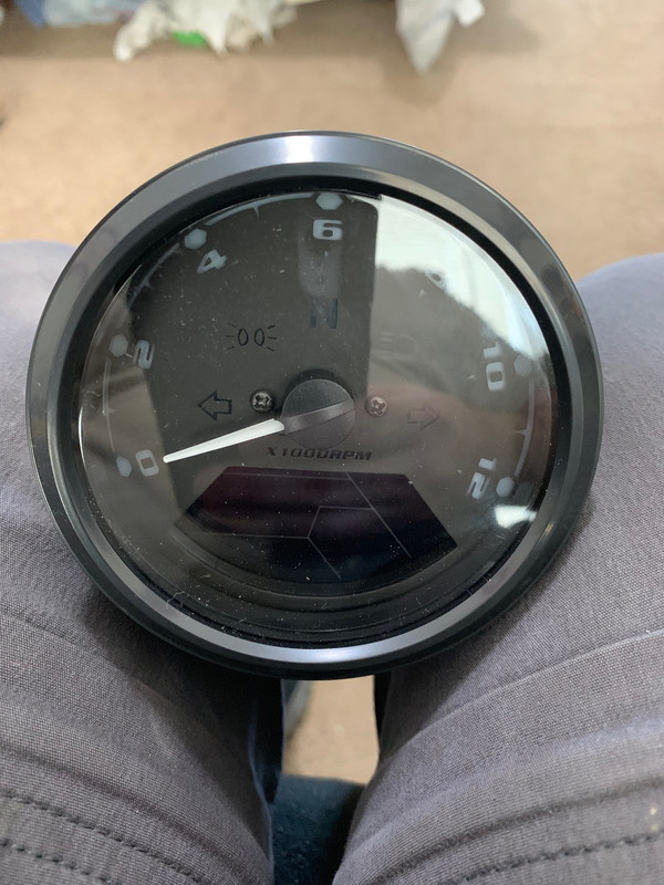

I got the turn signals in, the Speedo/tach/everything gauge, handle bars and LED relay for the lights.
The handle bars are different in that they are super adjustable. They are made out of 9 parts that all bolt together and this allows you to move and adjust in a huge number of ways.
The gauge is an all in one unit. It has an analog tach, but a digital speedo. It has gas, turn indicators, and gear indicators. I will only need the "N" as I don't think the 1200 had a switch in the trans to indicate the gear.

I have the dash installed and it is working, I still need to hook up the Tach and do the calibration.
The fuel gauge is going to be a challenge to figure out. It "works", but I don't think it is reading right. I may have to do something creative with a resistor to get it in the right range. As long as I can get it to read empty when it is really empty I will live with whatever reading I get when it is full.
