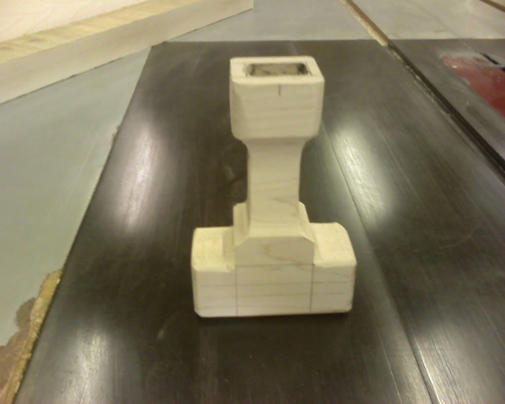

I somehow missed this the first time around.
Roady: I have had a wooden fork cap tool like that for years but I have never gotten around to taking a pic of it. Your drawing explains it just fine so I might steal it to use on the CX forum the next time the subject comes up.
BTW: Here is a more refined version made & sold by Fibonacci on the CX forum
